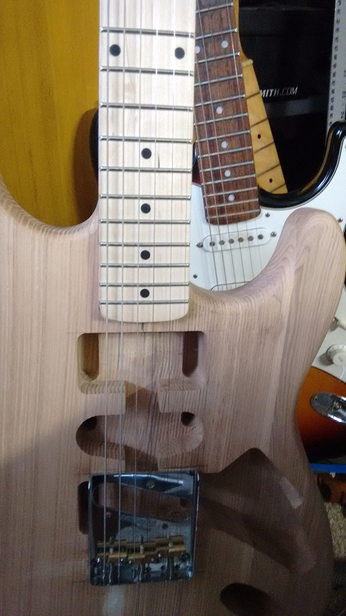

  2. #52

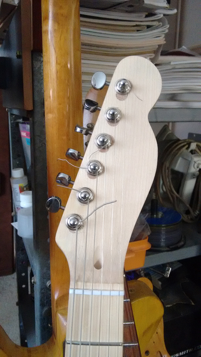

    Opportunity to put some strings on to check orientation.
Name:	22 stringed.jpg
Name:	23 stringed.jpg
    cheers, Mark

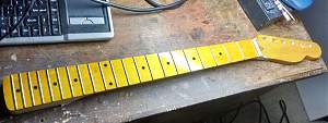

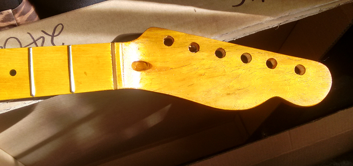

    Neck stained with Feast Watson Golden Teak surplus from the Bronco Bass mod.
    For the neck I'll use trusty ol' Tru-Oil, but the fretboard is being lacquered.
Name:	25 stain Laquer.jpg
Name:	26 pickguard.jpg

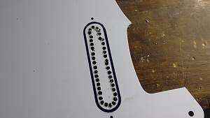

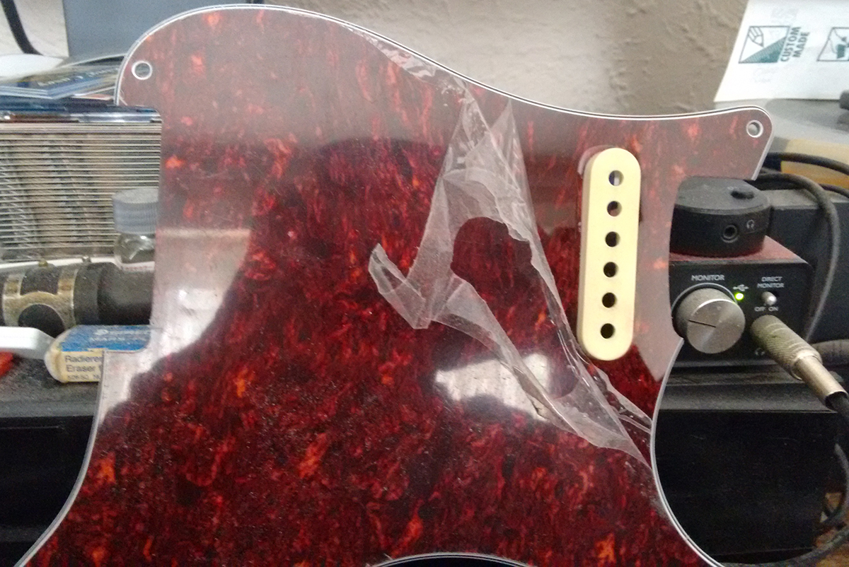

    Marking out the first cut.
    cheers, Mark.

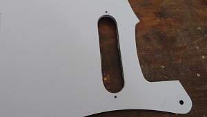

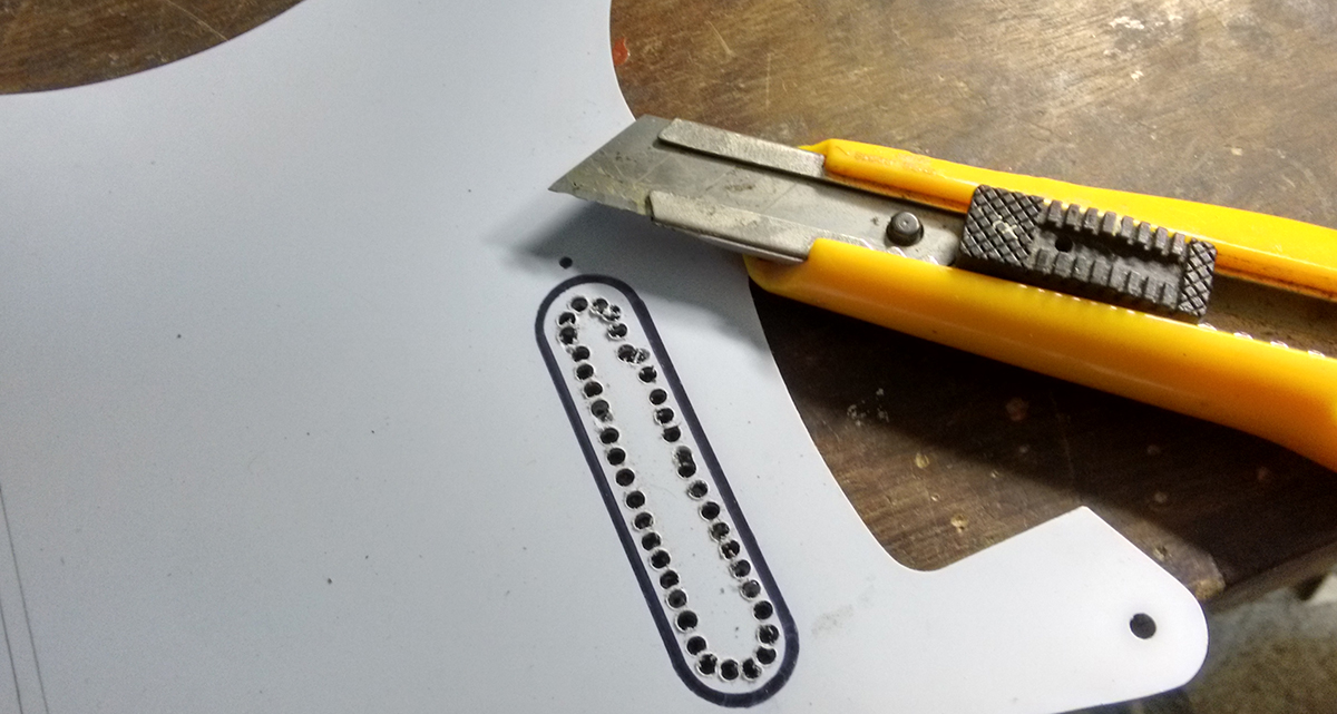

    This next section should be captioned 'my kingdom for a laser cutter'.
Name:	24 drilled.jpg
Name:	25 ready to cut.jpg
Name:	31 fitted.jpg
    cheers, Mark.
  6. #56
    Nice and neat for a hand cut hole! There are so many tools I'd love to make life easier, but there is also a lot you can do with a bit of care and patience.
  7. #57
    5,666
    Oh yeah, sooooo many tools I want.....
    FrankenLab
  8. #58
    Thanks, S.M. However, I've had a bit of practice doing scratchplate holes. The first attempt ended up like my headstock drilling work.
    Cheers, Mark.

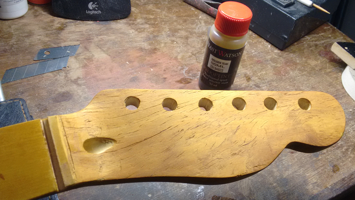

    Moving along: Well the veneer arrived and I was so engrossed in the process that I failed to photograph key segments.
Name:	34 Veneer.jpg
    Applied the FW Golden Teak
Name:	35 stained.jpg
    Then the first coat of Tru-oil
Name:	36 Tru-Oil.jpg

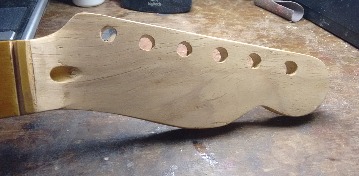

    Another case of character building (I'll do it better next time)
Name:	37 get it right.jpg
    cheers, Mark.

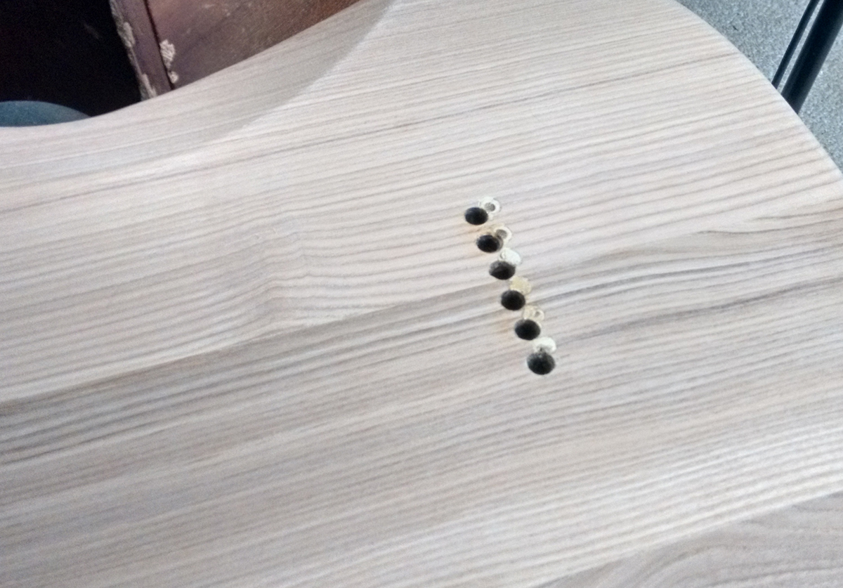

  10. #60
    String thru holes are definitely one of the hardest thing to get right and look right, or maybe try...
    You could even inlay some veneer, like a piece of rosewood or maple 3mm headstock plate, if the plugs bug you too much.
