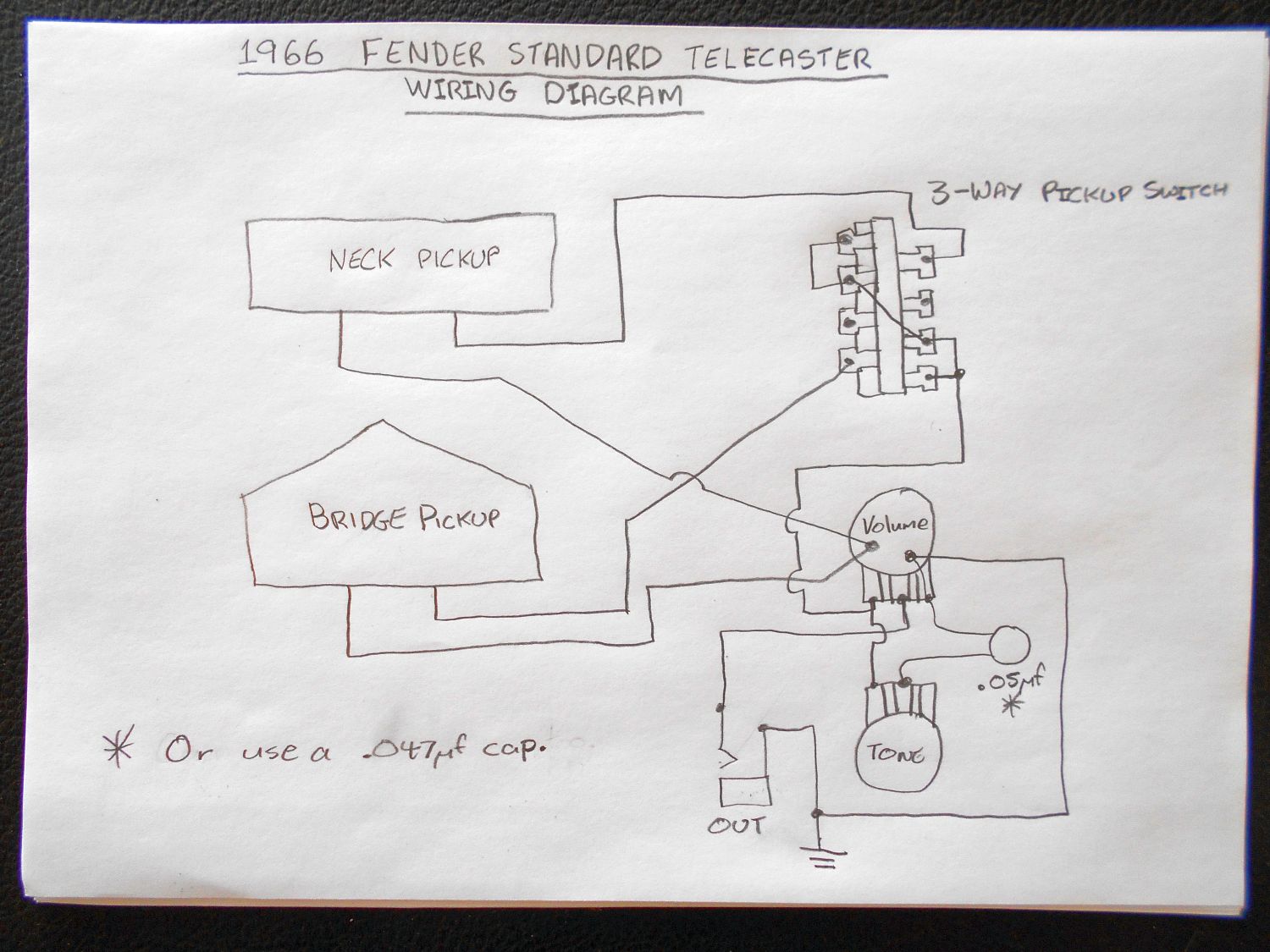

    Here's a hand-drawn version of the 1966 Fender Standard Telecaster wiring-diagram I found in my Guitar Player Repair Guide book, feel free to use this if you're in the process of doing a Telecaster build, hope it proves useful, note; it may not be necessary but make sure you include a ground wire that links the shields of the volume and tone pots together:
Name:	1966 Telecaster Wiring_2_resized.jpg
  10. #60
    You don't actually need that link, Doc, as the nice metal control plate on a Tele does that job for you. But it's better to have it in case the nuts on the pots become a bit loose. Easily fixable, but you wouldn't want it to start playing up mid-gig.
