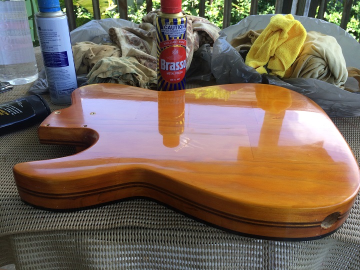

    Before, with all the ridges. It looks like a semi gloss but in real life the whole surface is marred with tiny ridges from the cloth used to apply the Poly.

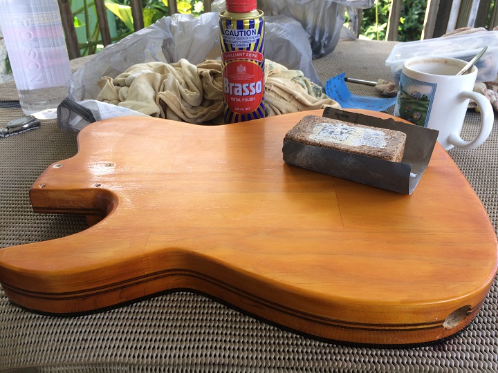

    After sanding it back with 1200, 1500, and 2000 grit paper, and a cup of coffee. All the ridges have been sanded away and now it is a consistent matt finish.

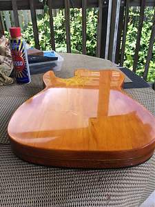

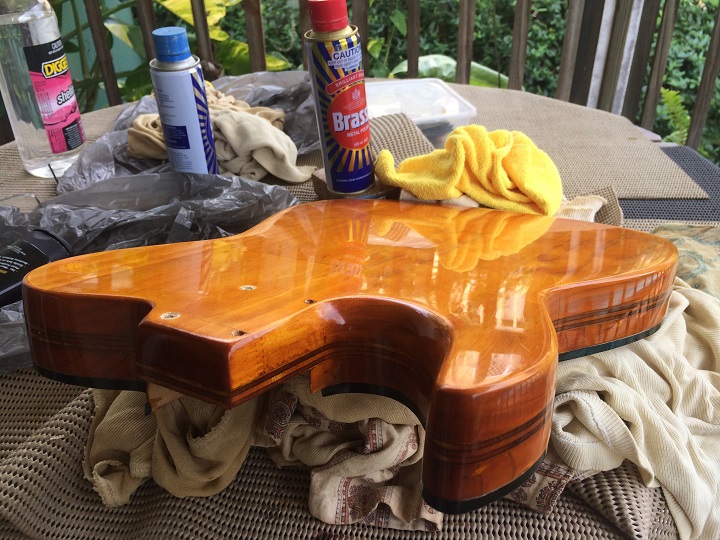

    After a really hard polish with Brasso it is finally starting to shine.

    Awesome work Rob.
    Love the colour and always impressed with how you bring up such a shiny finish using Brasso. I have started using it too but geez, it is pretty wicked smelling stuff and strips lots off. Have had a few spots where I burned through the shiny top coat. Thankfully not back to bare wood but things have gone dull rather than shiny and just slowly doing spot touch ups to build up some more layers to polish.
    Has this ever happened to you with using Brasso?
    Cheers, Waz
