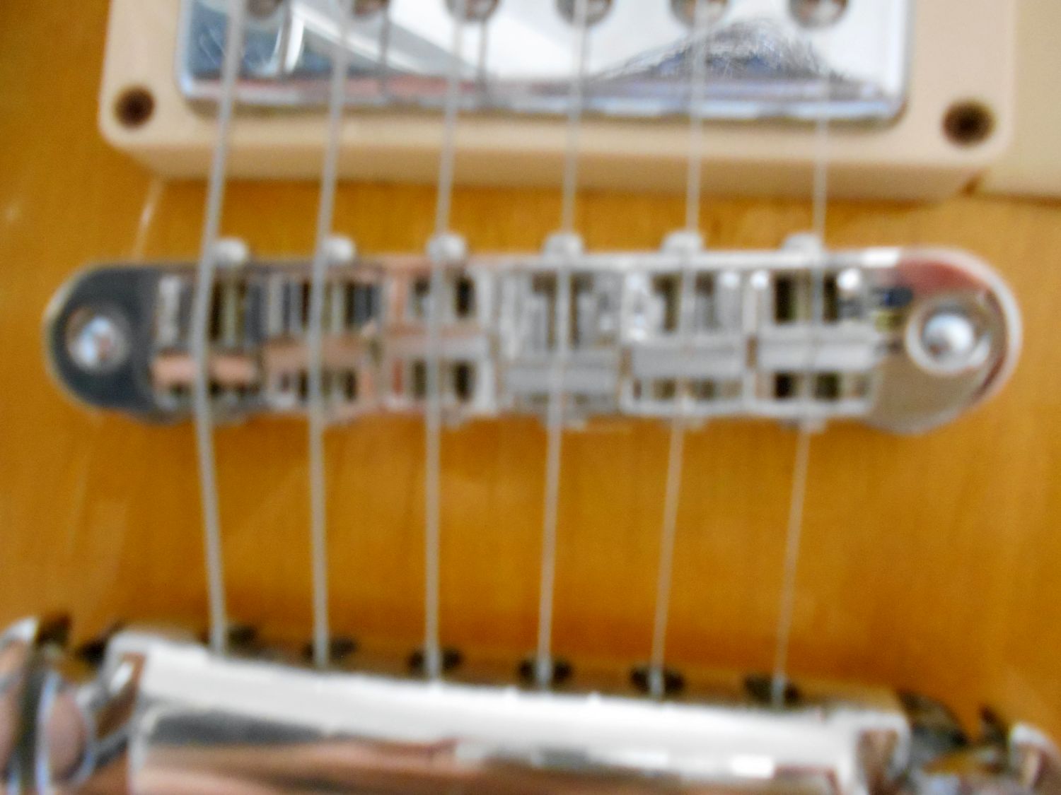

    On Tuesday next week, I'm going to be ordering some new parts online for my Gibson USA LP Studio guitar from a website called The Stratosphere, I'm going to be ordering some new nuts, tuners, TOM bridge hardware, pickup selector switch, and some new knobs, this time round I'm going to see if I can get a mate of mine to install the new nut for me cause the last few times I tried to install a new nut didn't exactly go according to plan, no matter how hard I tried to do a good job of it, the other parts I can install myself though.
    I'm going to be ordering two bleached white and slotted bone-nuts, and two Tone Ninja Nuts for the LP Studio, I don't know which ones will prove to be the best fit for the nut trench so I'll have to wait till all the parts to arrive.

    There's another reason I am very strongly suspecting the stock nut on my Fender Strat is causing the issue with the B and E-strings, I noticed occasionally, when I did a dive bomb with the Strat's trem-bar without the Strat plugged into an amp, that a slight pinging-sound came from the headstock end of the neck, I also noticed that if I pushed down on the B-string behind the nut the B-string would go sharp, gently pulling the B-string away from the fretboard would bring the B-string back to pitch, so yes I think the B-string is binding in it's nut slot for sure.
