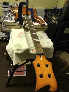

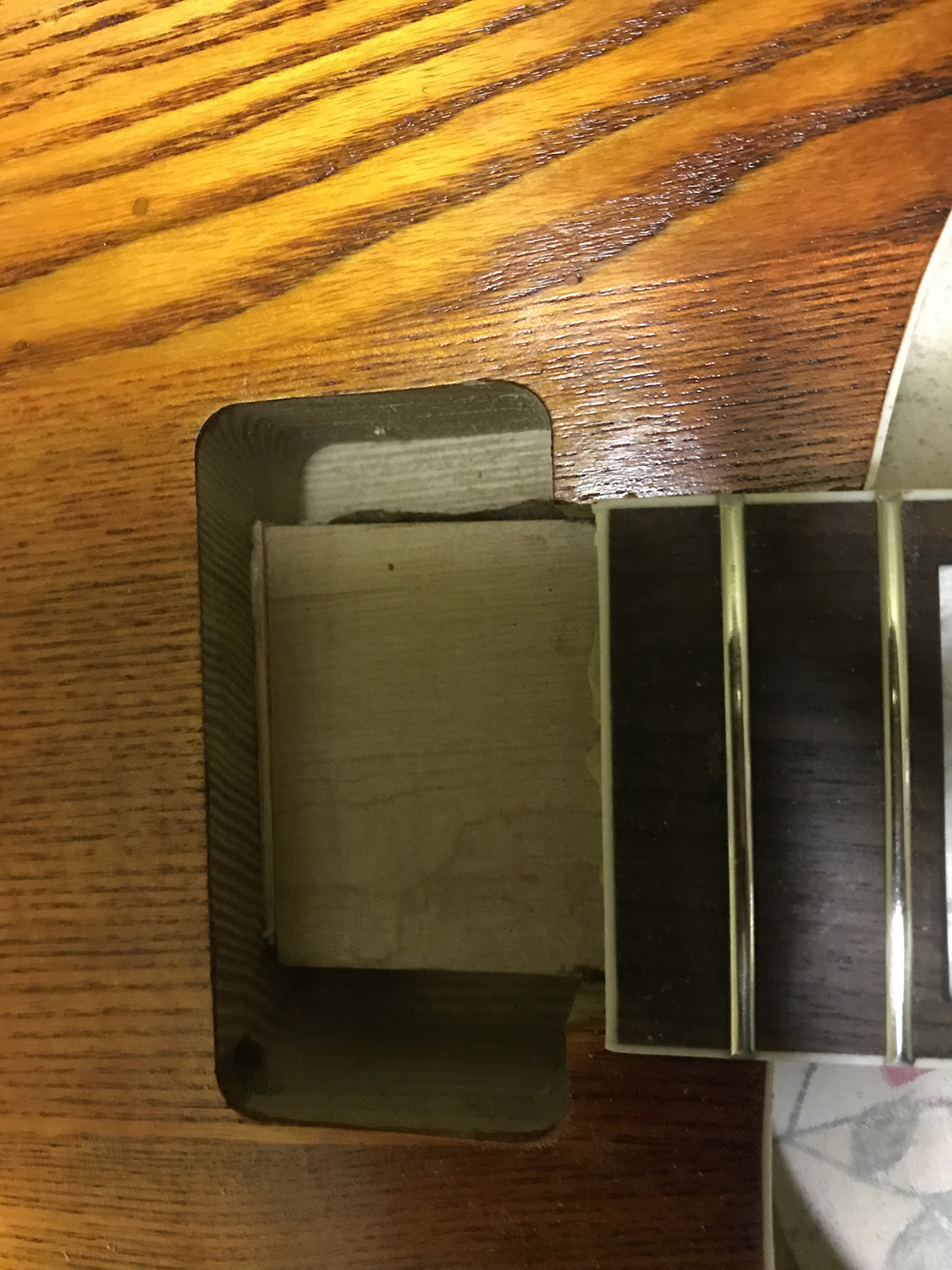

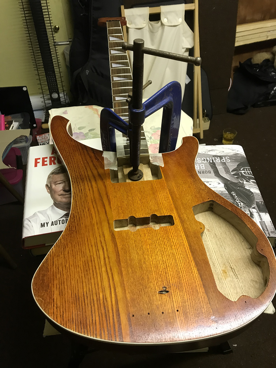

    Well, a big moment - the neck is in place.
    Not without a moment of drama. I had it clamped up and took these phots then, fortunately, took a closer look to make sure all was well and found a gap of a couple of mm between the heel and the edge of the neck pocket. Major panic but I got it sat properly and re-clamped and all is looking well now.
    I think the glue, even though I applied thin layers, was enough to make the snug fit of neck and pocket a bit tighter than it had been.
    Anyway, disaster averted hopefully!

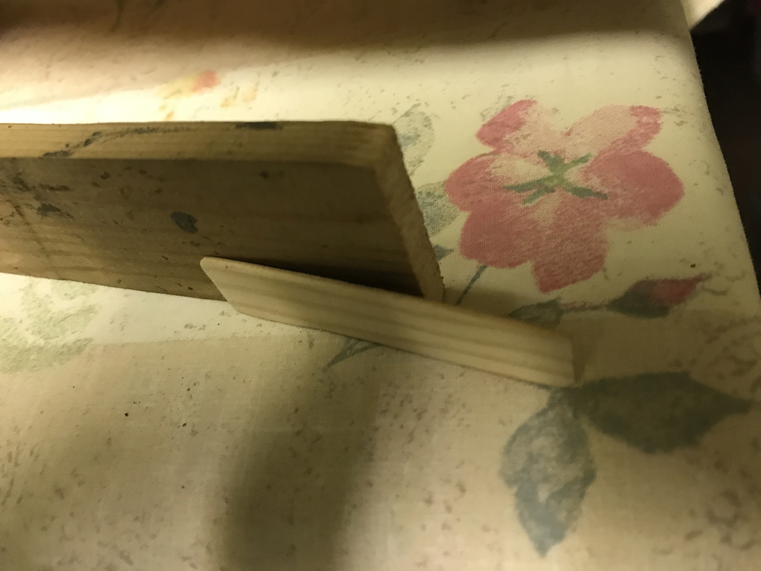

    Took the bold step of un-clamping the neck and it didn't fall off!
    This small gap between the end of the neck and the back of the pocket bothered me.
    It must be better for the neck to make contact with the pocket as it is less likely to lift once under string tension is what I am thinking.
    So made a shim to fill the gap. Started with a piece as at the rear of the pic and ended up with the piece at the front.
    A coating of glue on both sides and in it went. Feeling happier with that.

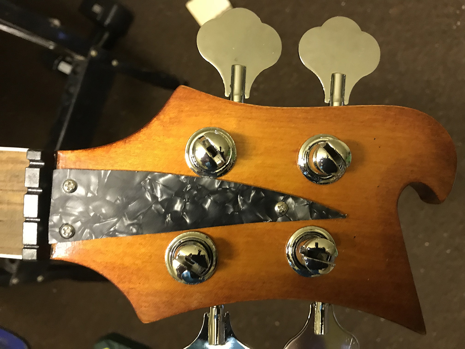

    And couldn't resist fitting a few bits of hardware.
