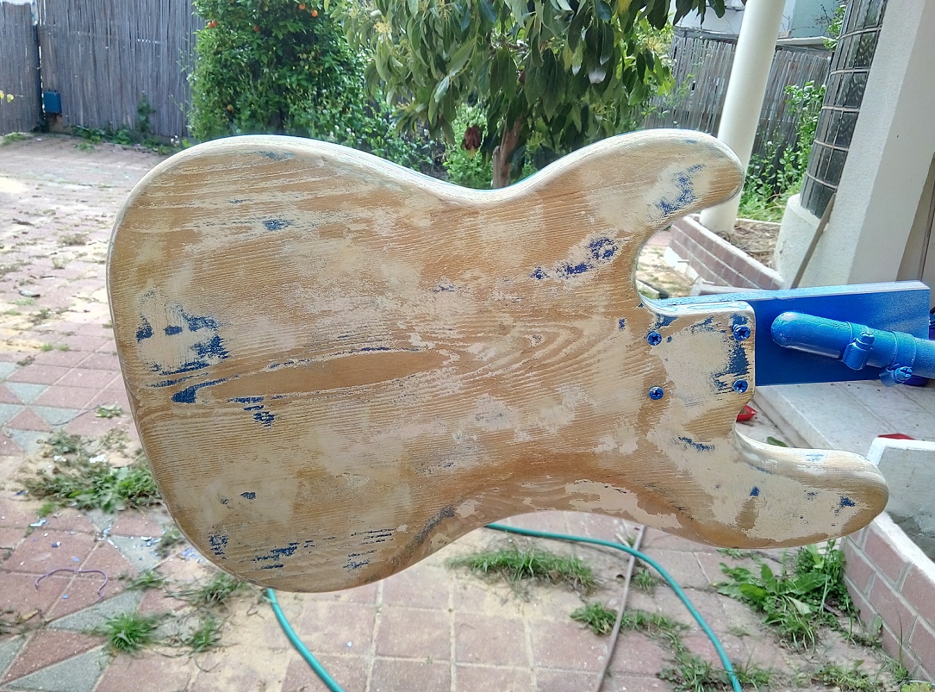

  4. #54

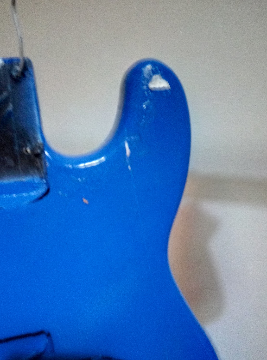

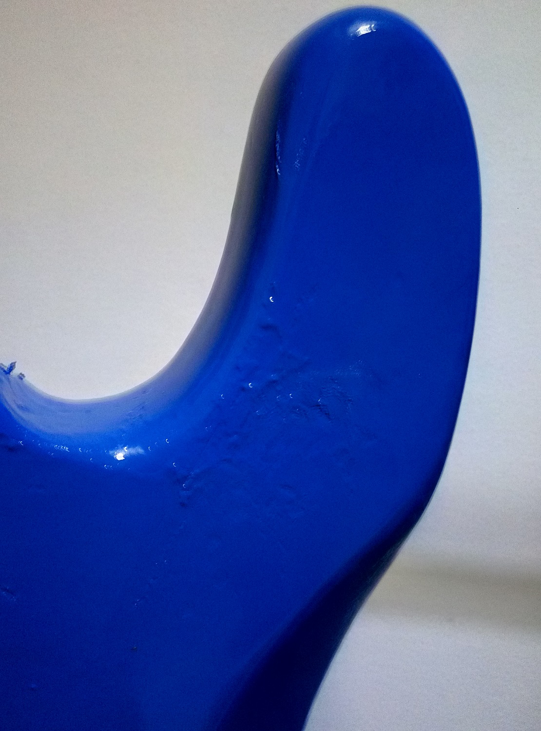

    What a horrid few weeks it's been!
    Working on weekends only is making this process very long, especially when you do newbie mistakes
    To make a long story short, after I sanded the first coats of color, I repeat the process (filling, sanding, shellac,primer,color) and I started to get the gloss I'm after.
    Applying a thin coat of lacquer - it really started to look amazing, I left it to cure over night, and in the morning I applied a second coat of lacquer but this time I applied a heavier coat and the lacquer started to run, after a few hours when I tried to wet sand my running mistake I ended sanding some of the color underneath.... what a drag!!!

    This time I decided to strip all colors down to the wood using Owatrol DSP-800.

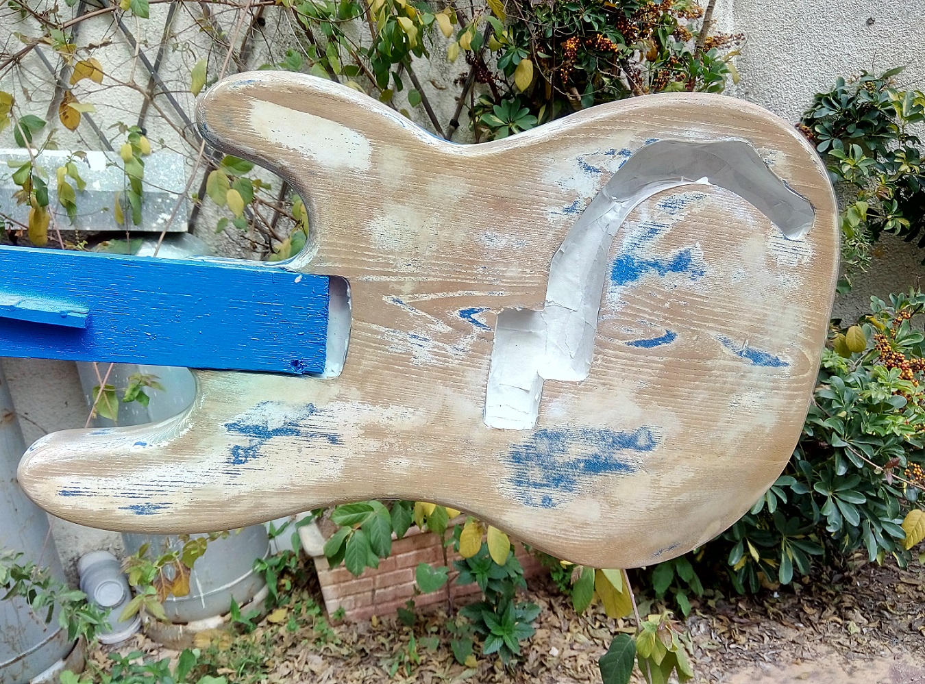

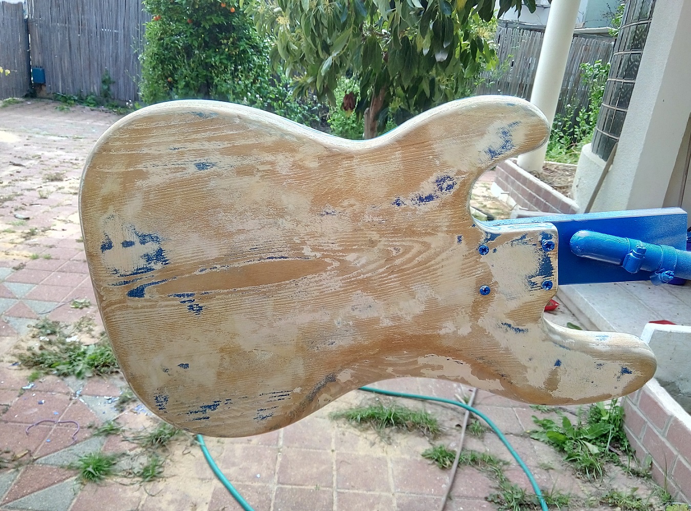

    After about 40 minutes going over with a spatula - I managed to remove all color (almost)
    That's how it looks after refilling, sanding and shellac:

    Waiting patiently to Friday so I could apply the color again.
    This time I will take my time... besides I heard that 3rd time is a charm

  6. #56
    Never sand back too soon when you have got a run. Let the finish dry for a couple of days. Thicker paint means that the inside bits of the run are still wet when the surface feels dry. The solvent in the paint/lacquer will soften the layers underneath, so when you sand through the hard skin, the sandpaper catches the softer paint underneath it and drags it out, leaving a pit in the finish. So just give it time.
    I find it's easiest to apply all the coats of one colour (as you are almost bound to get at least one small run with each coat), then wait for that to fully harden before sanding down all the runs together. Any sign of the paint/lacquer still wet underneath the thick run areas and just immediately stop and wait for another day or so.
