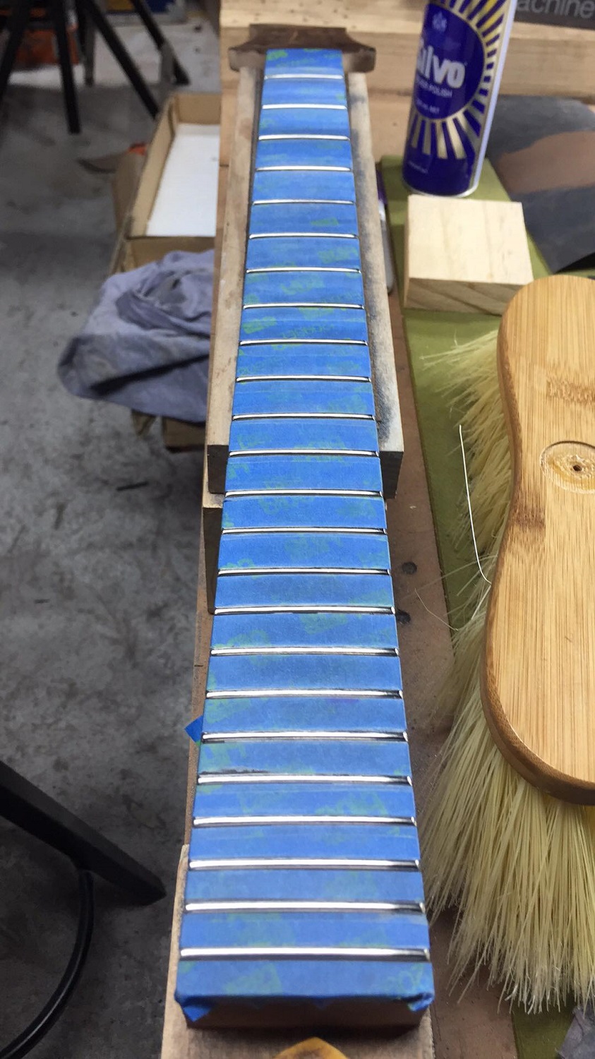

    Progress over the last week...finally cleaned up the binding

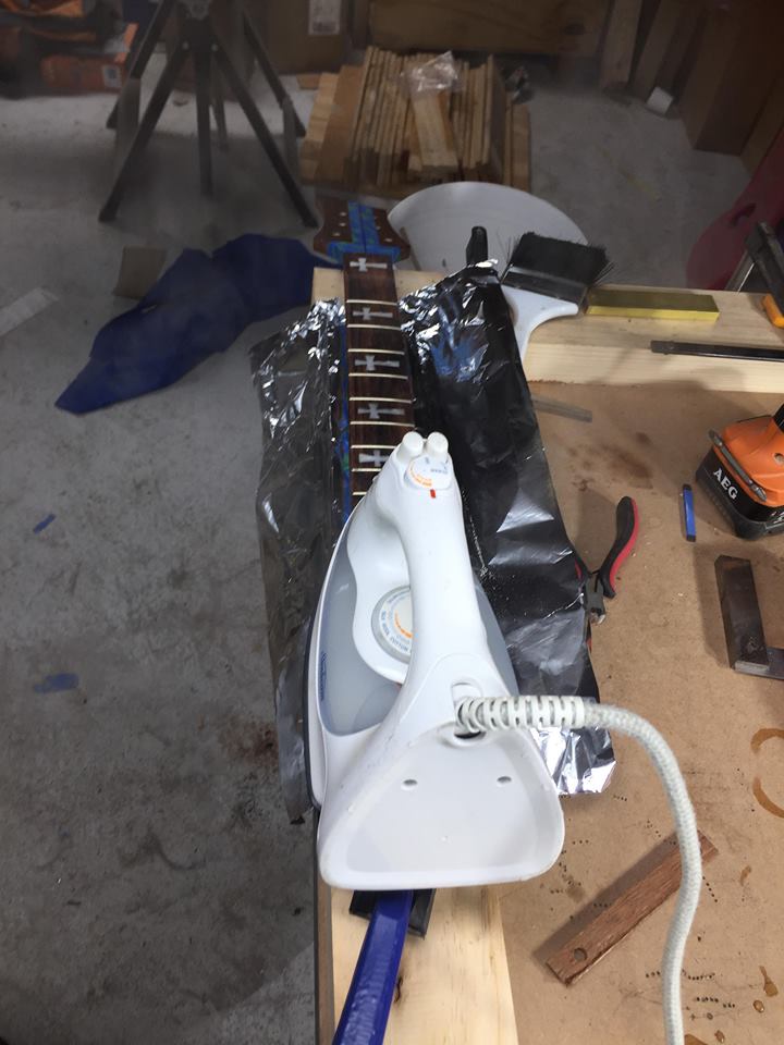

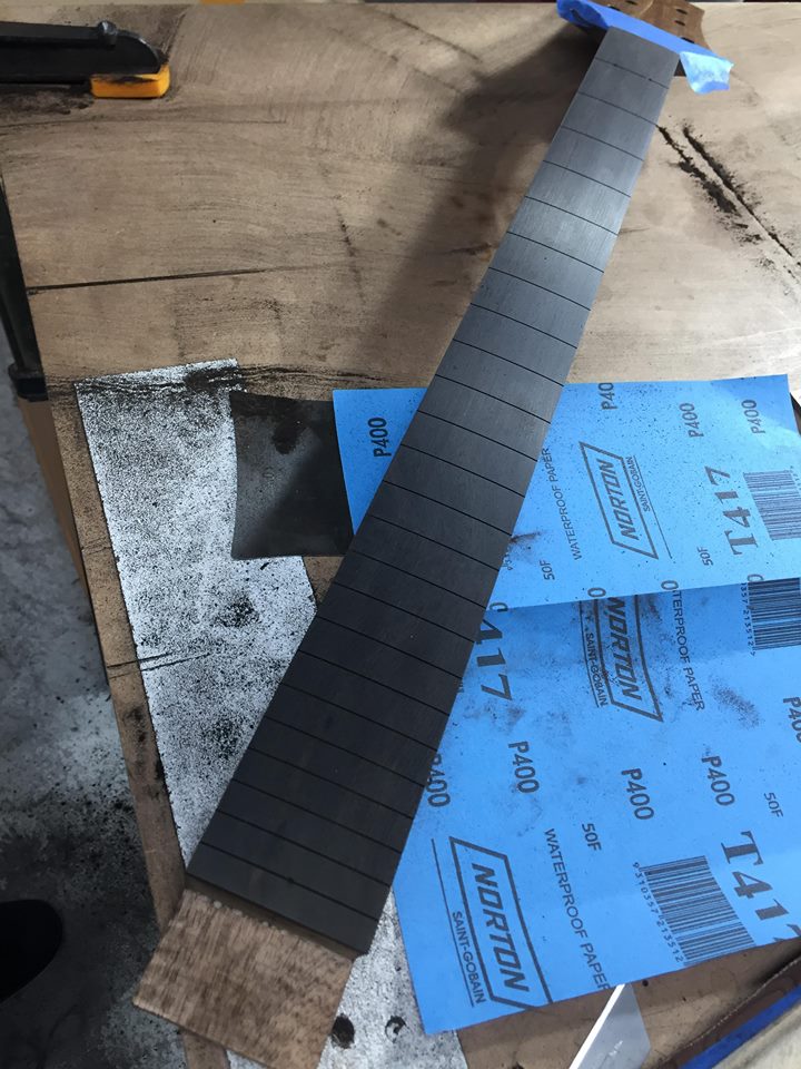

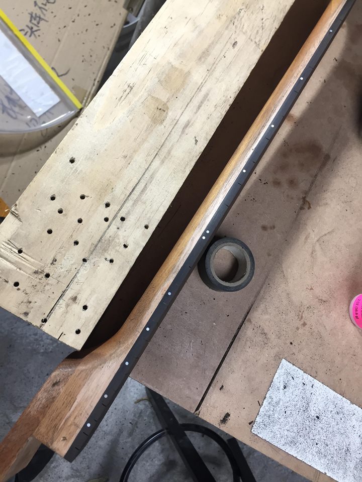

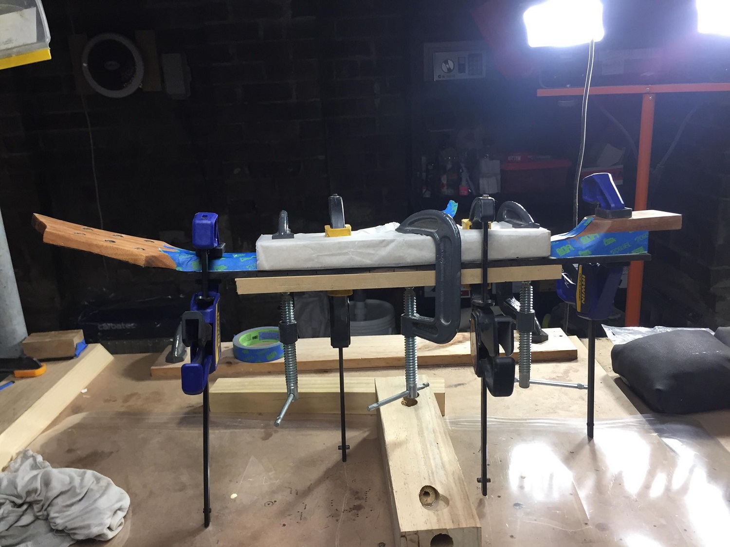

    As this build is turning out better than expected, I needed some help with those ummmmm cross thingys stuck all over the fretboard.
    I approached fellow forumite and all round great bloke Frankenwashie!!!!
    A deal was struck and FW agreed to knock the cross covered fretboard off and replace it with one beautiful ebony fretboard (side dot inlays only)
    He was kind enough to send me some photos of the process...
Name:	PRS Neck 9.jpg
    Steaming it off with the iron
Name:	PRS Neck 8.jpg

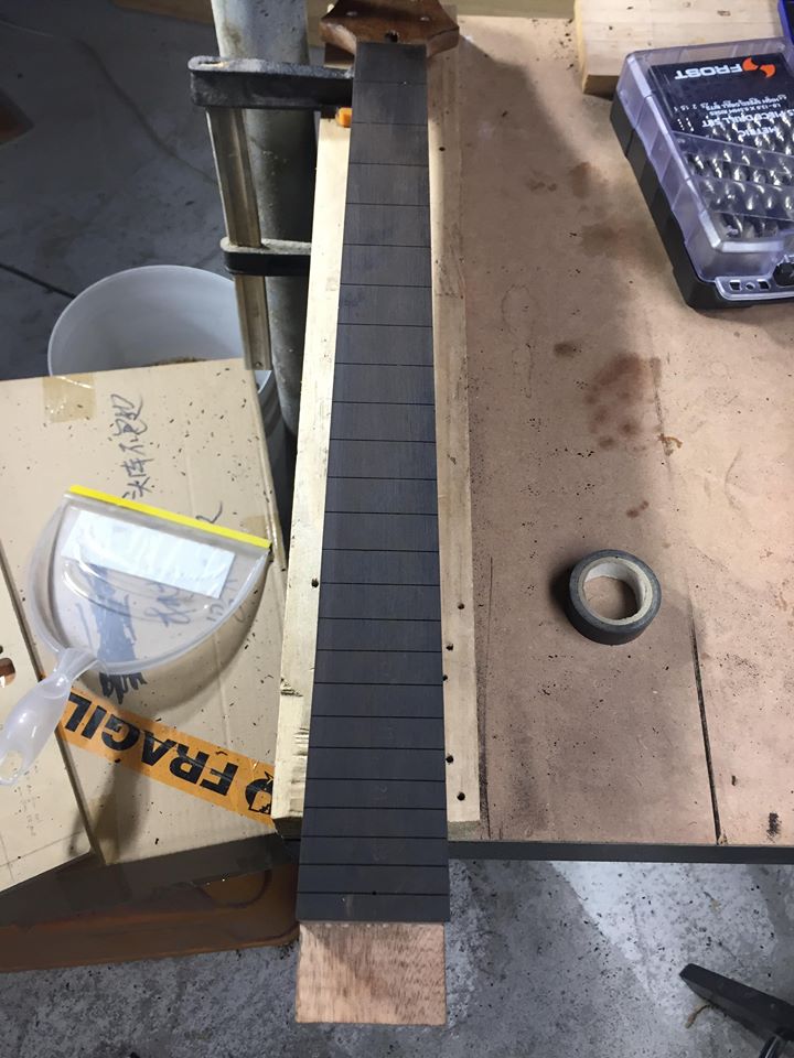

    Clampage action
Name:	PRS Neck 7.jpg

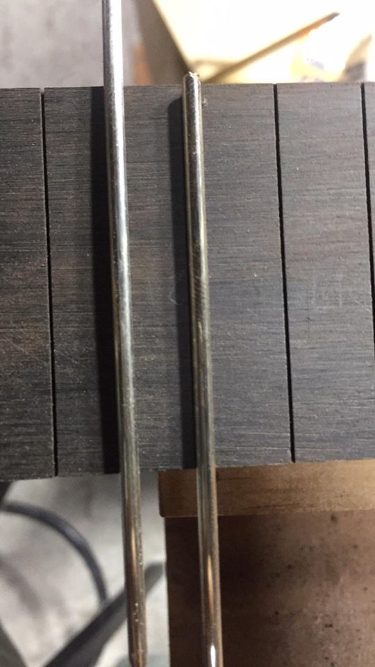

    I chose medium sized fret wire (Jumbo left medium right)

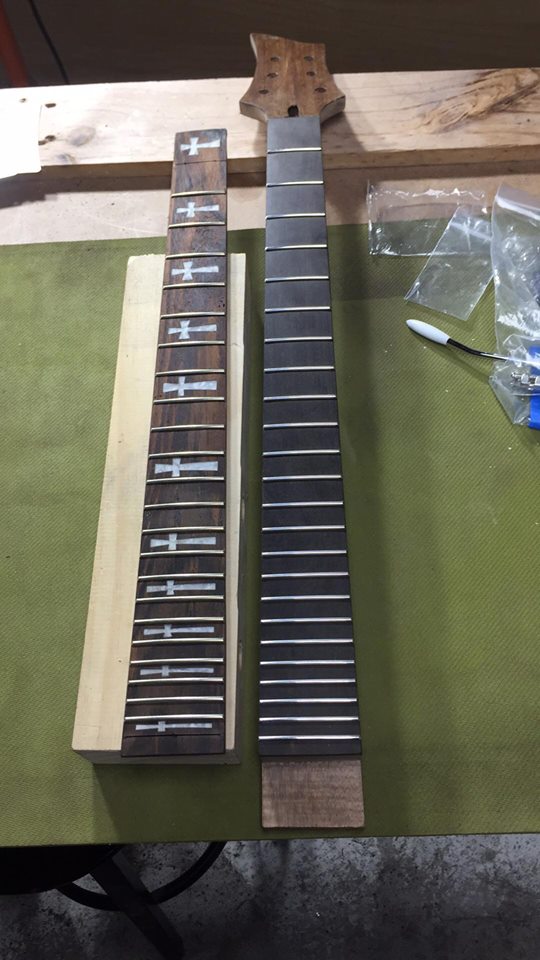

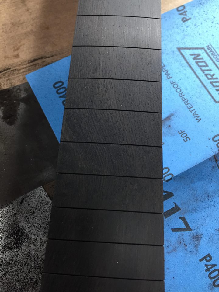

    More photos
Name:	PRS Neck 3.jpg
    radius done, 400 sanding
    Frets cleaned up
Name:	PRS Neck 2.jpg
    Side by side old and new.
    Blown away FW really stoked mate.
    If I haven't explained it all properly feel free to post
