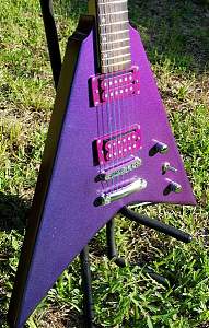

    Pickups arrived yesterday, and it got even more '80s. It's still going to be a few days before I get it wired up. I didn't like the input jack that came in the kit, and it was kind of bent up and flattened, so I'm waiting on a new one. I also finally managed to get an angle that shows a little of the color shift. Wish I'd wiped the finger smudges off first, but, oh well.

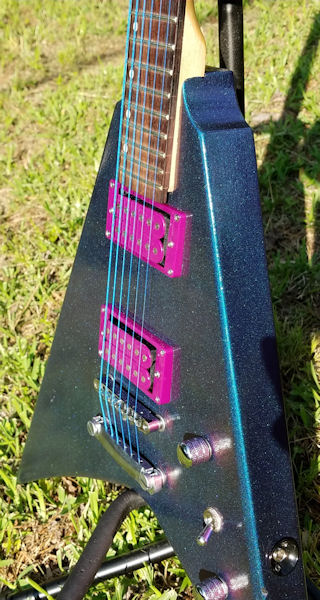

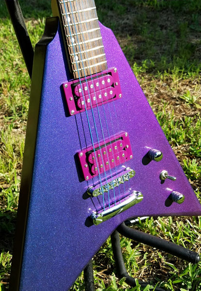

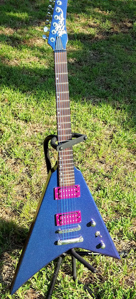

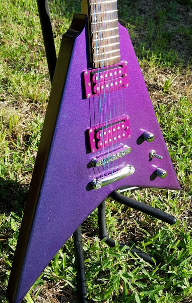

    Finally got some sunlight yesterday, so here's the finished product. Not perfect, but way better than it has any right to be.
