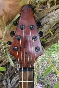

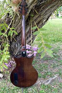

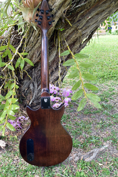

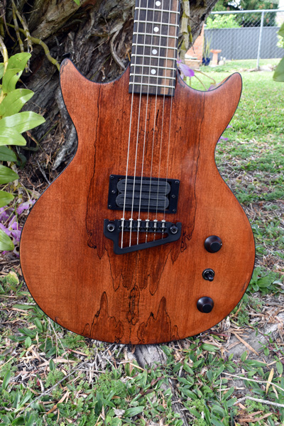

    Finished the DM-1S today.
    Body and neck are stained with wood dyes then about 30 thin coats of Tru Oil. The top wasn't sanded or grain filled at all, there was a few small glue spots and a line up the center between the pick up and the neck. I camouflaged that with some matching paint and a tiny brush which I painted some extra "spalt" on. The back is "cedar" mixed with a little black and red, the top is cedar, red and orange mixed. fretboard is finished in Ren Wax.
    The kit comes with a P90 but I had always intended to use a humbucker so I had to open up the cavity a tiny pit with the dremel. The pick up is a Kent Armstrong Motherbucker which is actually 2 humbuckers side by side, so I added a 3 way switch to choose plus spit them both with push pull pots so there is quite a range of sounds from what looks like 1 pick up. bridge is a Hipshot Baby Grand, tuners are Grovers, knobs are ebony and the truss rod cover is a veneer offcut stained with the same mix as the back.
