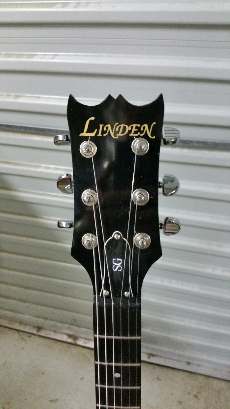

    I wanted a Black headstock and using transfers wouldn't work if I wanted my name on it so I went to a local sign maker place and got them to make a engraved plate that I could stick on. Also got them to engrave an old truss rod cover that I supplied.
    Once I had the name plate and it was glued in place I then had to use a Dremmel to carve away the excess bits and holes for the tuners and truss rod access. Then the get the edge even closer I used a file to match the edge of the name plate to the shape of the Mahogany head stock. A few minor errors were hidden with fresh coats of FW stain and TO.
    I think it looks pretty good, though next time the name plate will go on before the head stock is shaped instead of being the last item of the assembly part of the build.
    Nut needs only minor adjustment, and I doubt I'll need to do a fret level as every note rings clean... I suppose all that is left is Intonation and play ...
