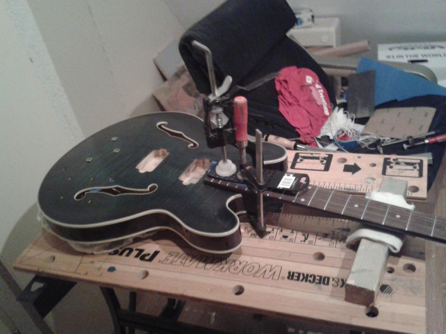

    yesterday i fiddled around with the neck and pocket till i had it where it should be.. ending in a late night glue session..

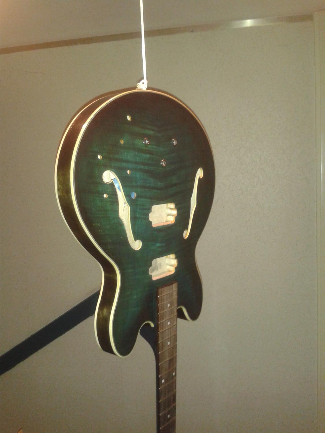

    and today i made me a hanging system for the last of the clearcoat
    it's startin to look like it's gettin near the finnish line

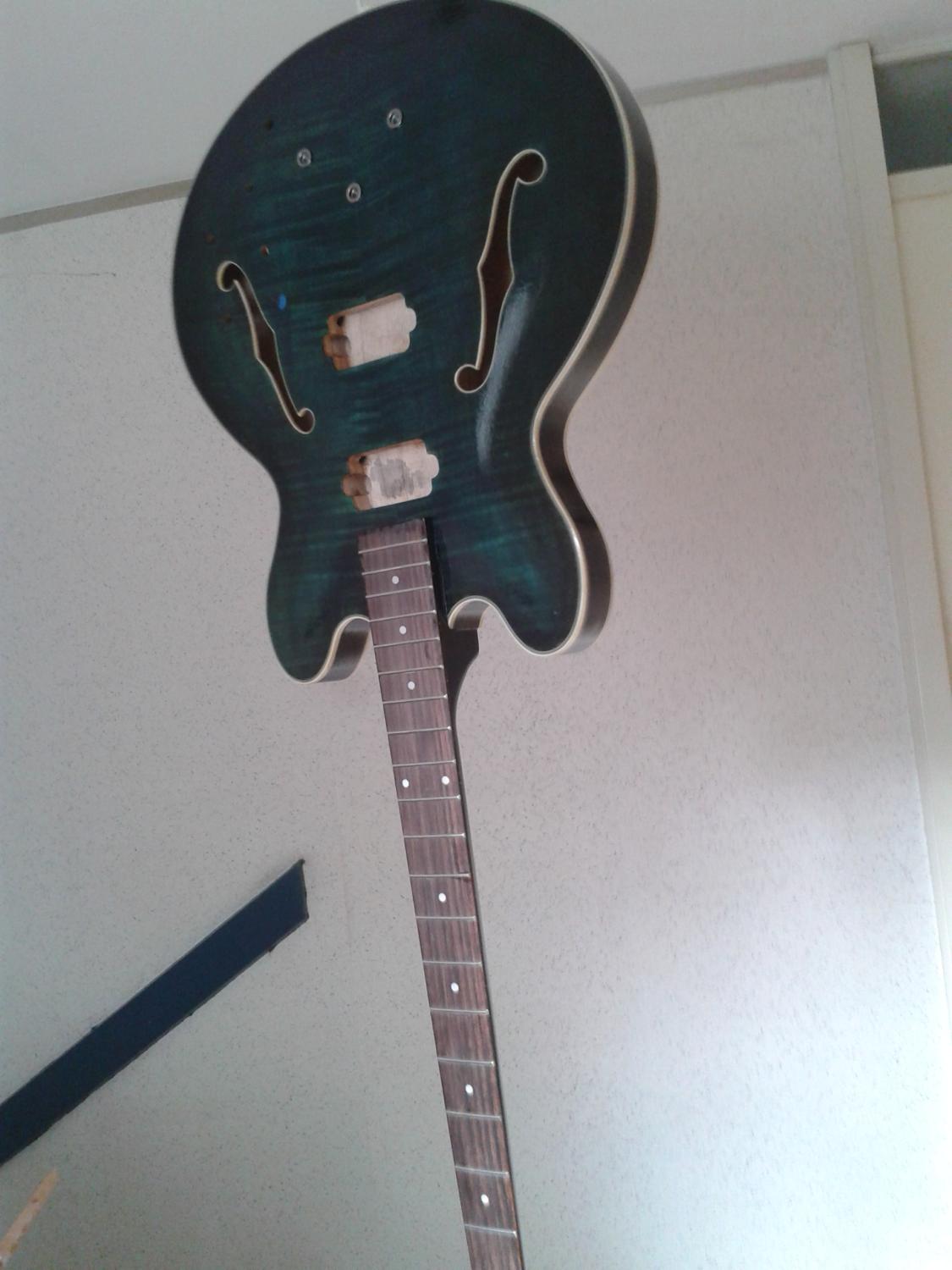

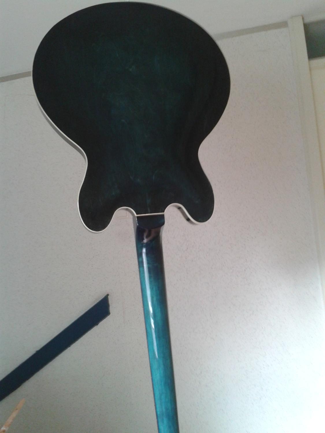

    just put on wht i think may be the last coat of clear.. i think there's a thick enough layer on it now for a good sanding and buffing.. and imho it's looking quite awesome already... here's some pics in daylight..
  7. #57
    Looking good. It's very easy to over-sand on convex curves and edges, so go easy in those areas. You don't want to break through the finish and sand into the stained wood and leave some lighter marks. Keep checking the colour of the sanding dust and as long as it's clear, then you're OK. It it looks tinted at all, then stop.
