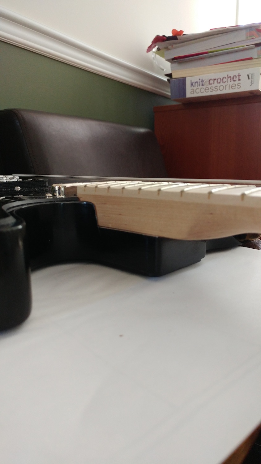

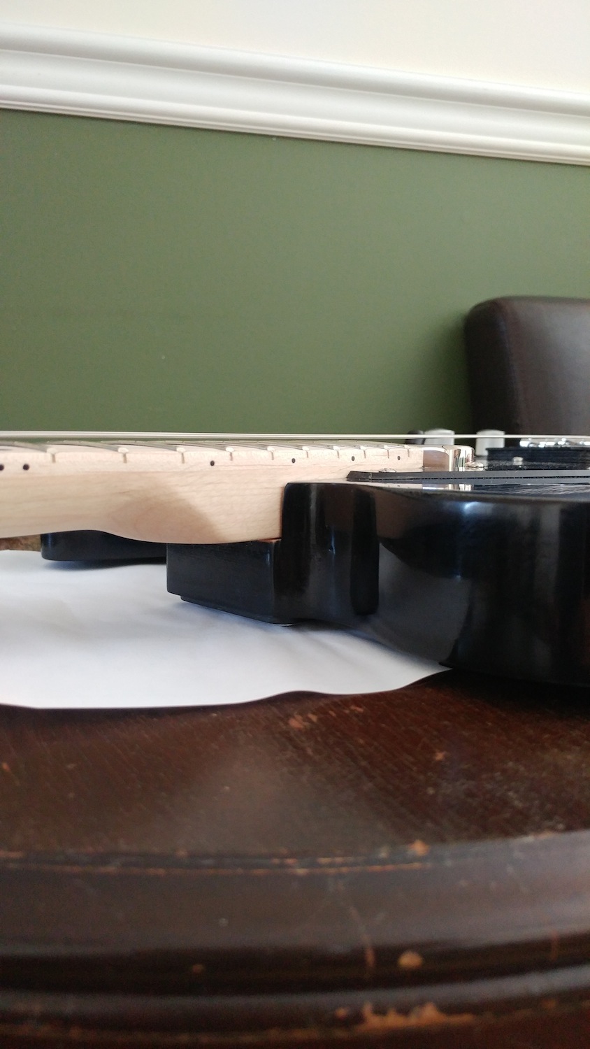

  5. #55
    A picture of the neck sitting in the pocket showing the relative heights would be useful.
    Personally I don't mind high saddles on that kind of bridge. It gives you a good break angle and you don't get the height adjustment screws sticking into your palm. The only downside is the subsequent upwards angle of the long intonation screws, which I'd be tempted to cut back a bit as they don't need to be that long.

  7. #57
    Some more photos would be useful - one along the neck showing the current amount of neck bow, and a close-up of the nut area, showing the nut and string height at the 1st fret.
    It sounds like the truss rod could do with tightening, and the standard kit nut normally neds deeper slots or the base sanding down, but without seeing what's going on, it's very difficult to suggest anything.

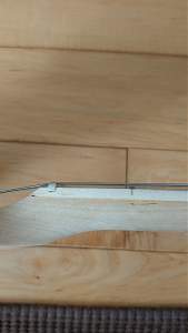

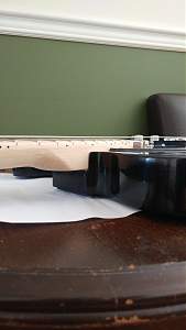

    here's a couple. At this point, I've shimmed the neck pocket on the body end to angle the neck down a bit - that explains the slight angle you see. What do you think?Click image for larger version.

  9. #59
    I think I can't see what I asked to see. I still have no idea what amount of neck relief you have or what the string height is at the nut.
    The action certainly looks high over the last frets, but those two pictures don't give me any clues about what's happening at the top and middle of the neck.

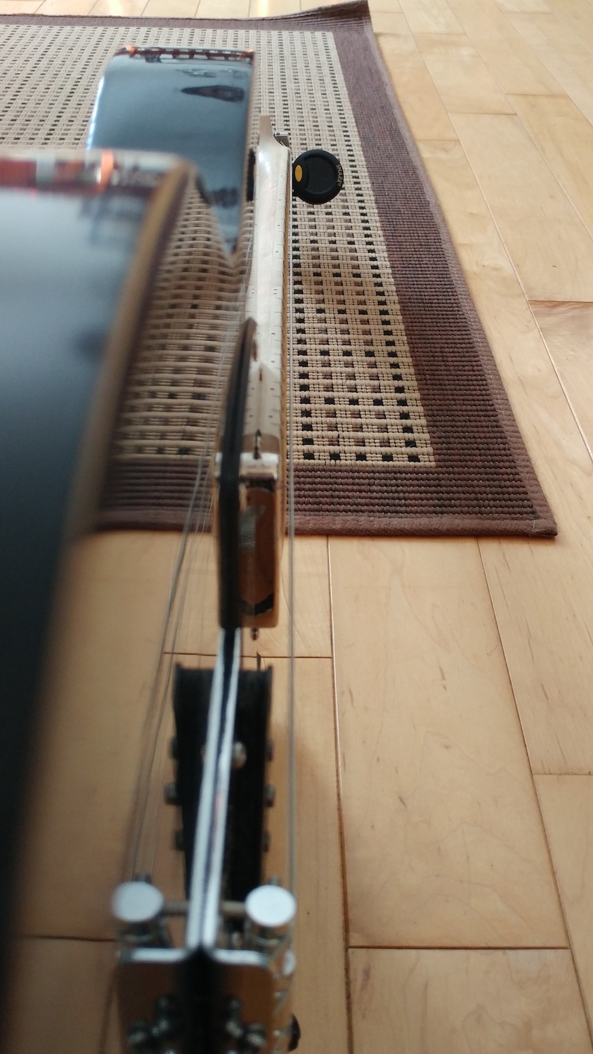

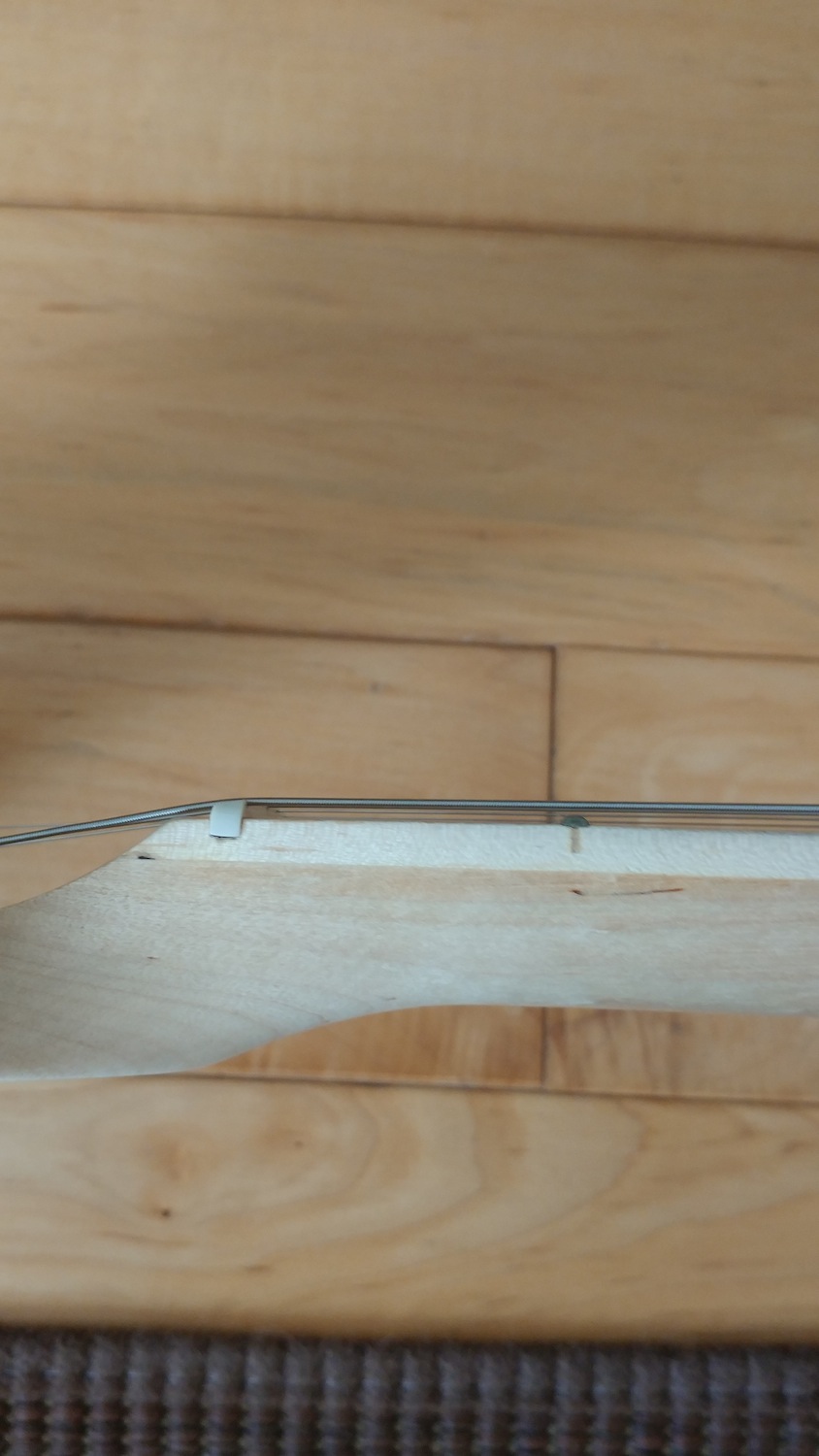

  10. #60
    Ajax, ontario
    28
    apologies.....Click image for larger version.
