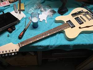

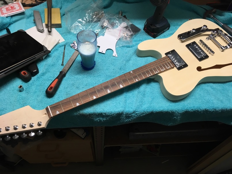

    Not much of an update at the moment. Just another dry fit while I wait for my stain kit. The pickups didn't quite fit as the tabs seemed a bit too long. I was going to get a Dremel and widen the pickup pocket but I grabbed a name brand pickup and it fit in just fine, so I filed the tabs down a little til thy fit. Job's a gooden.

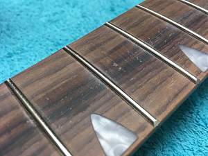

    There are a few pits in the fretboard that I'm unsure what to do with. Reckon they need filling or just oil it up as is.
    It's a bit tough to see in the pics but you can feel the pits. My gut feeling is they'll be fine but interested in others thoughts.
    If the colour comes out as Waz suggested above as a faded denim I think it will actually work pretty well with the look I'm going for.
    Robbo
    Hey Robbo does the fingerboard feel like it's dropping in height a bit between frets ? What I do is get a rubber/eraser and wrap 180 or 240 grit sandpaper around it and rub the fingerboard. Be worth trying to get it flatter. The rubber will allow the sandpaper to be similar radius to the fingerboard.
    Mock build looks good
    Hey man, no the fretboard seems pretty flat to these tired old eyes. There's just a bit of funky stuff going on around the 7th and 8th fret. I'll give it a light sanding as you suggest, I'm just trying to sand with the grain to avoid any issues.
    Robbo.
    Dingo Wax will sort things out on that fretboard once you have done the light sanding.

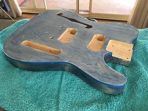

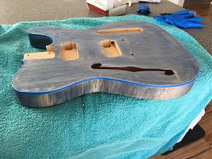

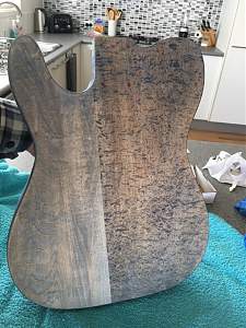

    Thought I did everything right. Wet it down looking for glue spots, the whole bottom of the front is a giant glue smear.
    The dye will not penetrate some areas around the outside and the grain on the back just looks wet and dirty.
    I'll give it a few days to dry, sand and paint.
    Robbo.

    Quote Originally Posted by Rockfactor View Post
    Hmm...
    Robbo.
    I know your pain there Robbo.... I had a partscaster Tele build do pretty much the same thing to me. A DRparts sealed Alder body doesn't take stain well at all...It actually came out looking so much like faded denim that I decided to turn it into a real denim covered Tele. Still working on the process of combining the denim and the binding into something that looks and feels decent, but the intent is certainly there...
    Keep at it, and you will win eventually....
