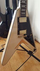

    thanks again guys for all your help with the build i definately couldnt of done it without you legends helping out. i just tested it and im extremely happy as one it works haha and 2 it actually sounds pretty good. maybe later I'll upgrade the pickups but for now im very happy.

    bravo brokin, you gotta be happy with that!
  3. #53
    good stuff Brokin looks great. If there is some nice flame maple under the pickguard between the 2 pups I would trim the pickguard. That's what I did on mine
