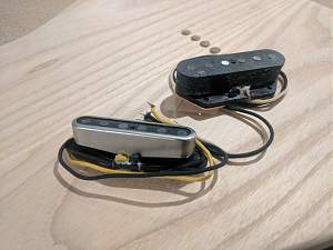

    Those pickups look really cool, will be interested in hearing what the guitar sounds like once it's all finished, Howlin Wolf was a very well known, and famous American Blues guitarist, he's been a big influence on other American Blues guitarists over the years, very highly regarded.

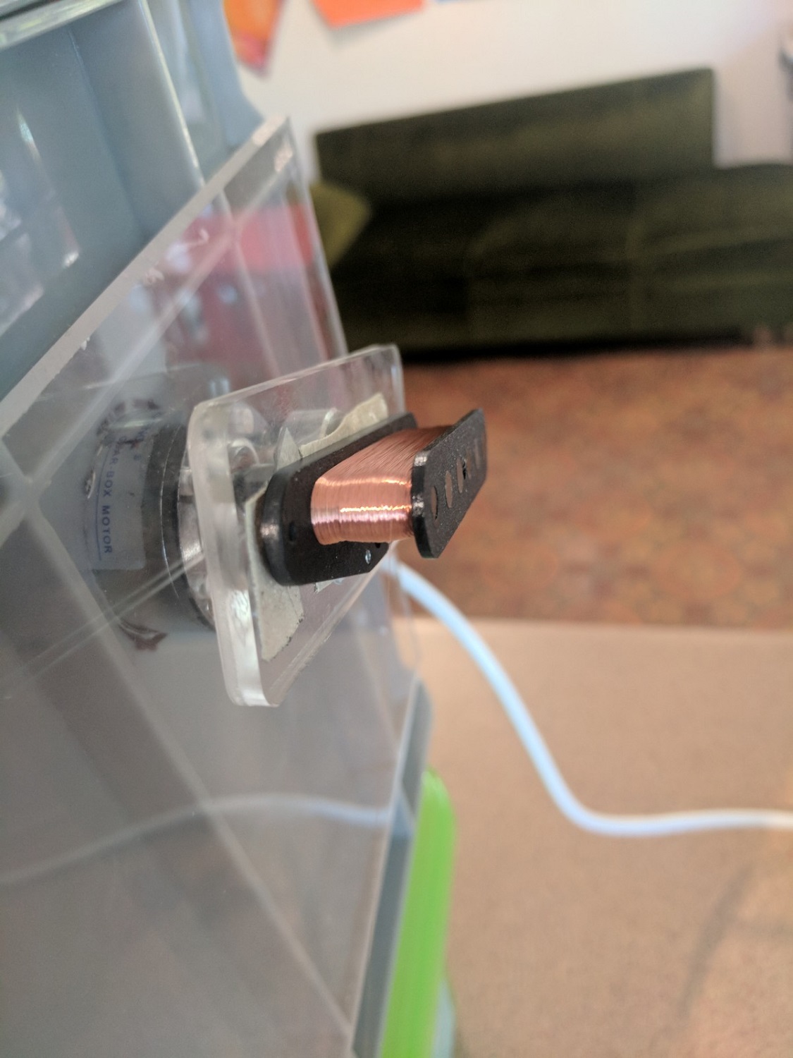

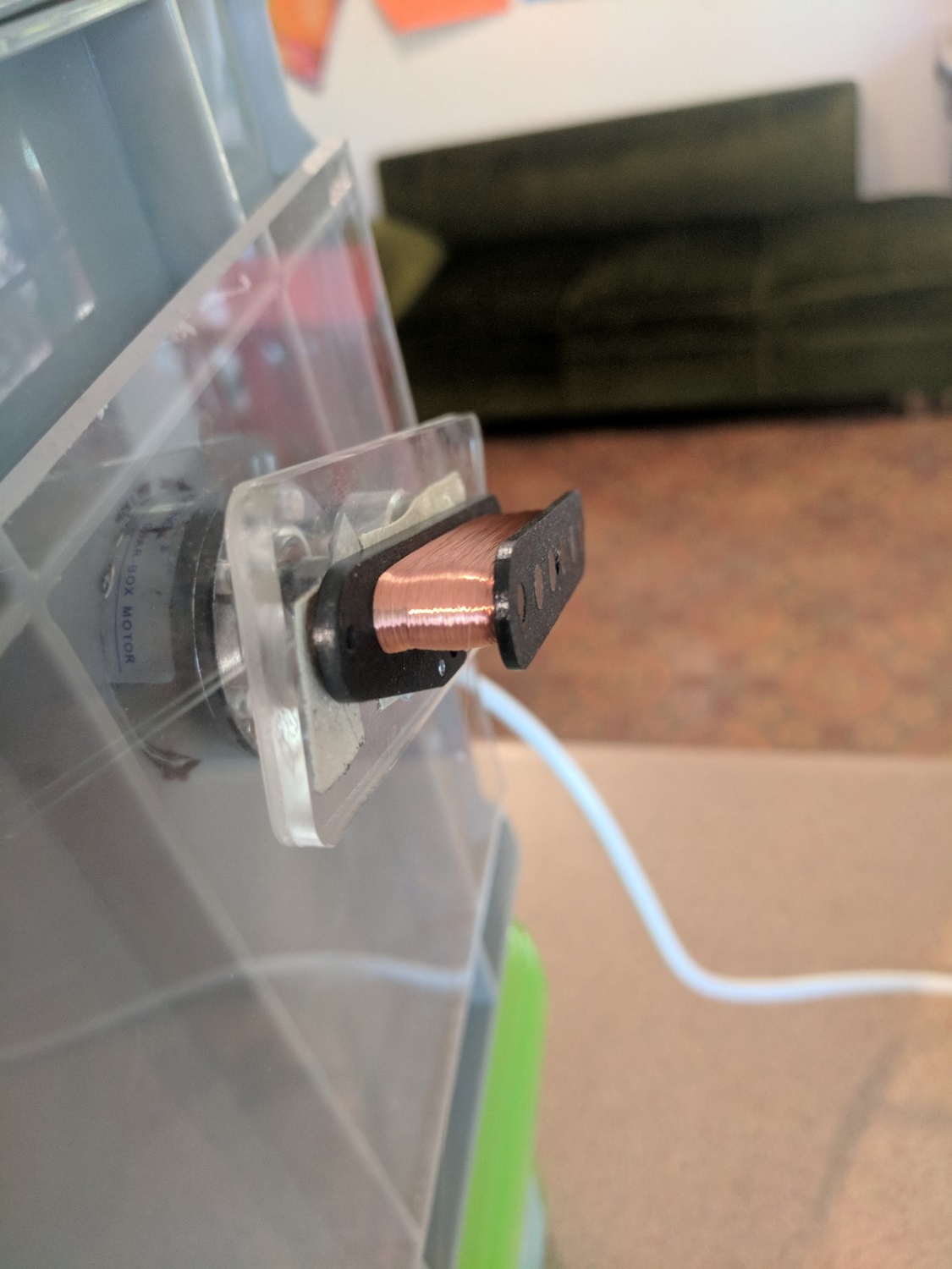

    Thanks doc....having some issues with the pickup winder at the moment....please stand by...
    and that pickup winder is getting flogged at work!!!

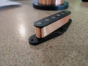

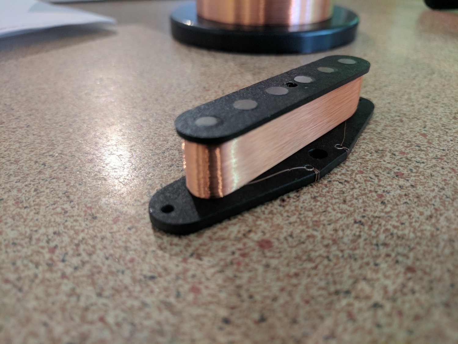

    Pick ups wound and working
    Bridge
    Wire: 42 AWG
    South pole up
    Clockwise wind
    DCR: 6.95
    Inductance 3.04H
    Neck
    Wire: 43 AWG
    North Pole up
    Counterclockwise wind
    DCR:6.61
    Inductance 1.87H
