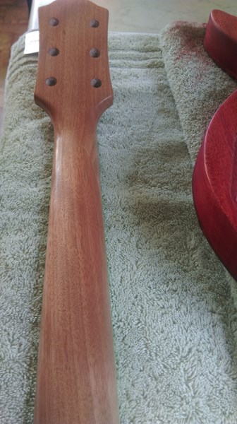

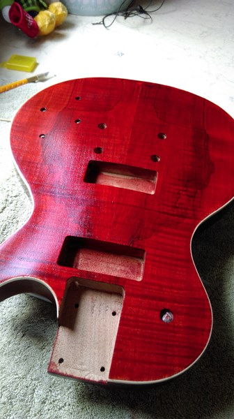

    Yesterday I had mixed some filler in with a base coat as per Wudtones instructions, today went to give it a rub off with 400 sandpaper, then for some stupid reason I thought I would give it a go over with 0000 wire wool, stupid old git next wiped that over with a tack cloth round the sides only luckily enough, disaster!! Spent an hour trying to gently scrape the gunge from the sides till I hit on the idea of using the Evo stick adhesive remover I bought, yippee, worked pretty well thankfully. Got some slight damage in colouring now but nothing i can't live with, gives it a worn look...... so another base coat on tonight, last one i think before the clear coats go on. I'm only glad I haven't as yet done the front of the guitar or i would have been in a right mess. Felt like ringing the daughter up to come and give me a kick in the nuts wake my brain up, anyway lesson learnt, it won't happen again. On a plus side, the neck I am well pleased with, that too will be on a clear coat from tomorrow.

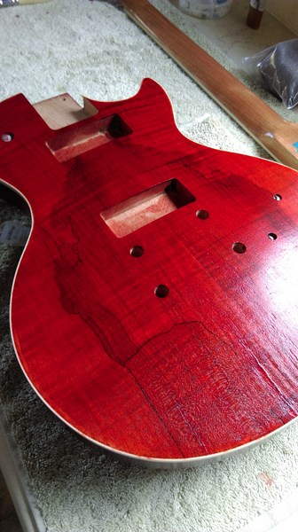

    Dye done, build up of top coats now, first one done, not that happy with how uneven the spalt is but didn't dare risk sanding it, it's only the bottom edges so hopefully the top coats will diffuse it a bit..
    The red looks absolutely stunning mate
