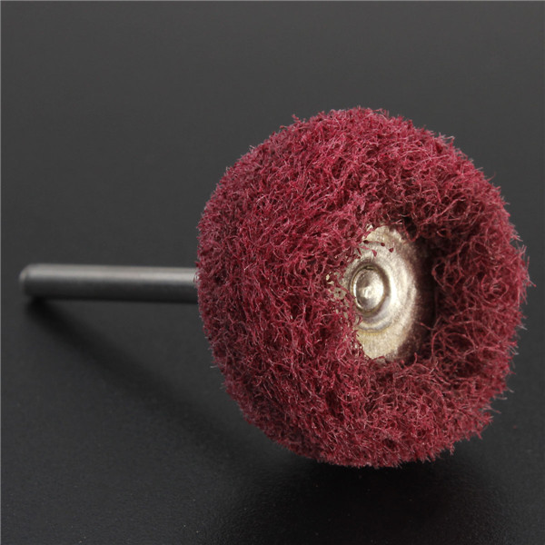

    hey! they look really good!
    can you show a shot of the dremmel attachment?
    Thank you. I certainly can.

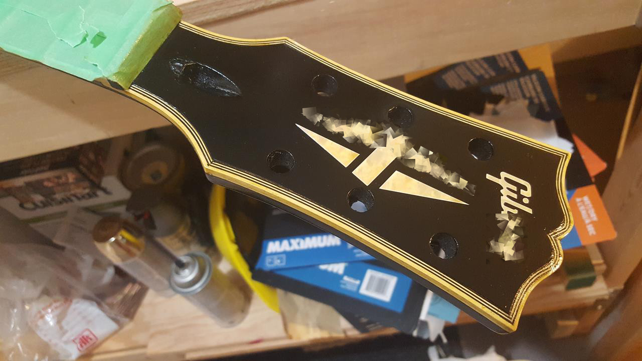

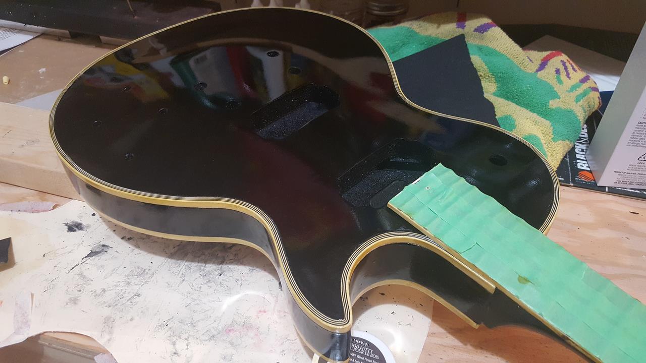

    I'm in the middle of the finishing stage at the moment. I have a few coats of amber tinted poly on and the binding and headstock logos are starting to yellow nicely. I think it's pretty close to time to switch to clear coats.

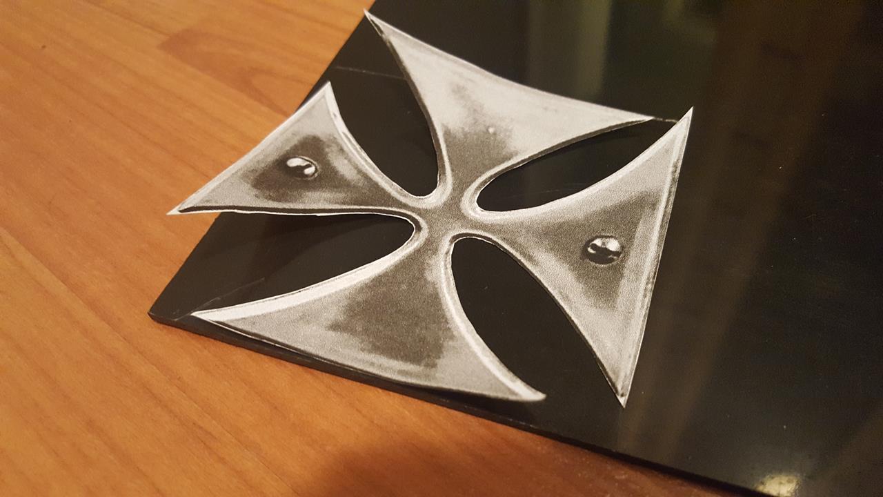

    Yes, there will be a worn gold iron cross behind the tailpiece that I haven't made yet. I've printed out a picture of the original to use a guide to cut mine out of a black pickguard blank that I'll paint. There will also be gold vinyl adhesive racing stripes.
