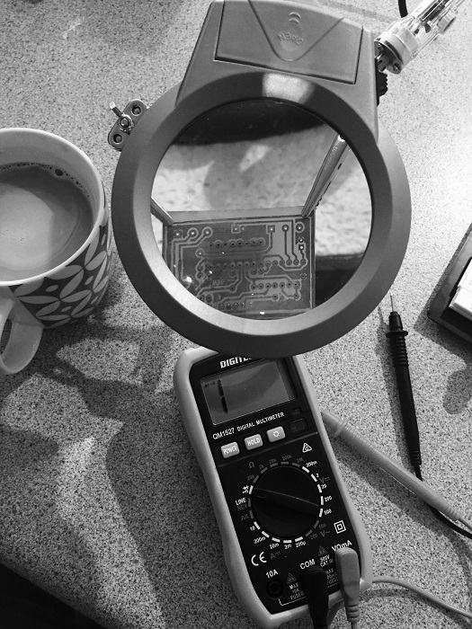

    Here's what i got up to today..
    Poured multiple cups of coffee and tested the circuit with a multimeter (couple of faults - not bad) - fixed faults

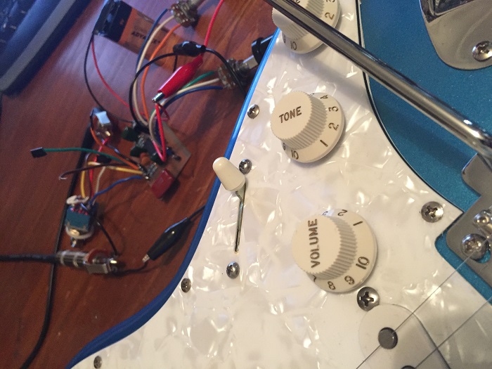

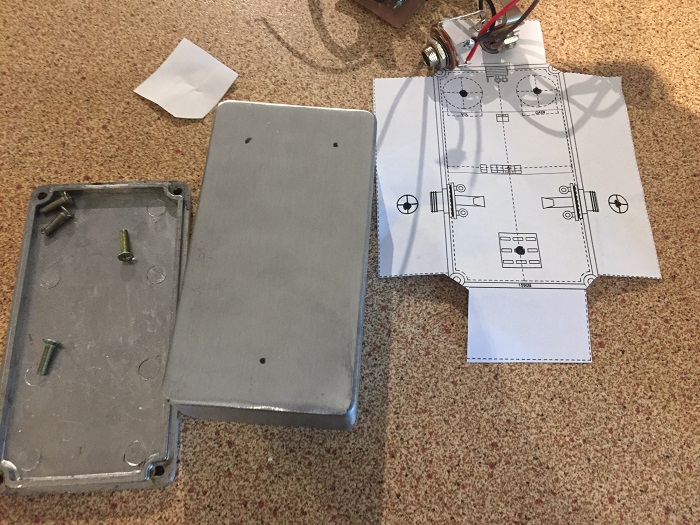

    Drilled most of the enclosure in a 1590G

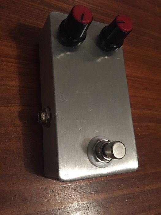

    Put it together....
