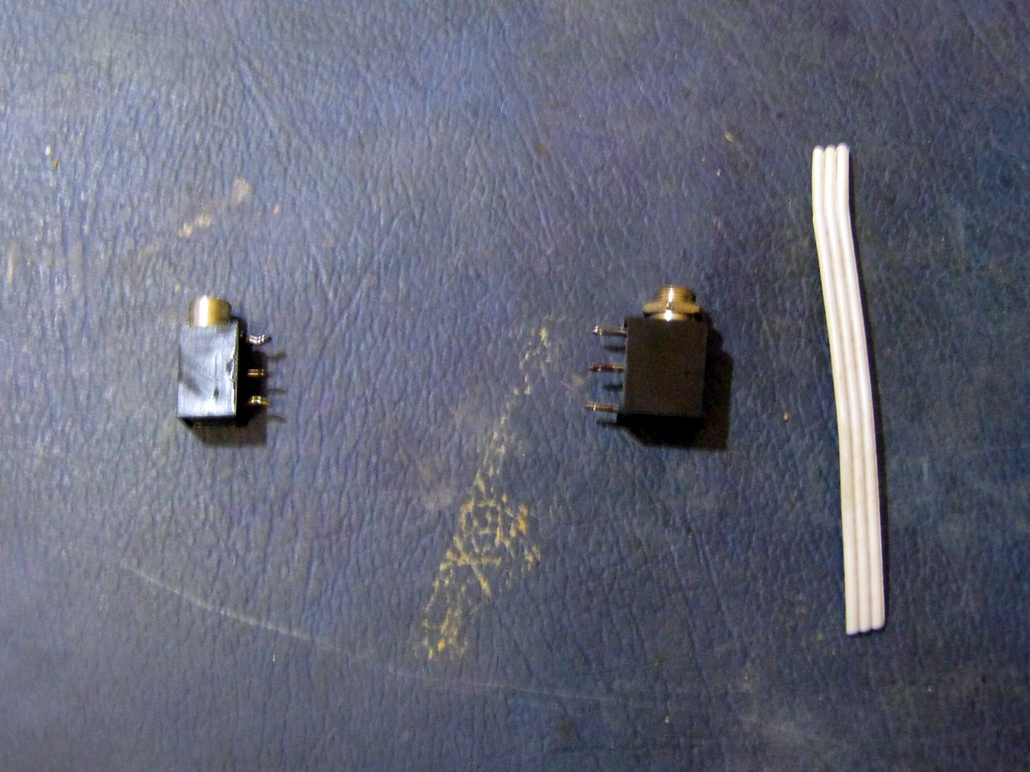

    I'll post some pics so you can see what the old socket and the new socket look like and the piece of 3-way ribbon wire I used to fit the new socket to the circuit board....stay tuned.
    Here we go:
Name:	Old And New Socket_resized.jpg
    The small socket on the left hand side of the pic is the original DC in socket, the one on the right hand side is the new one, next to the new one is the piece of 3-way ribbon wire I'm going to use to connect it to the circuit board, the reason for that is that the new socket is a bit wider than the original, so I need to turn it 90 degrees in order to get it to fit, this necessitates connecting the three terminals to the circuit board via three pieces of wire, the good news is that the new socket will fit in the hole in the pedal's casing, and it will be held securely in place via a thin nut.
    Before going any further, I thought it would be prudent to check that the two switched-contacts in the new DC in socket were indeed good, so I used my multimeter set to continuity test to test for continuity between the two contacts, fortunately they tested good.
    And then out of curiosity, I picked up the old DC in socket and had a look at it,.....and now I know, as it turns out, one of the terminals on the old DC in socket is a bit loose (it happens to be one of the switched contacts that disconnects the battery when the adaptor is plugged in), I'm guessing that heat from soldering probably caused it to come lose.
    So there you have it folks....the root-cause of all the trouble.

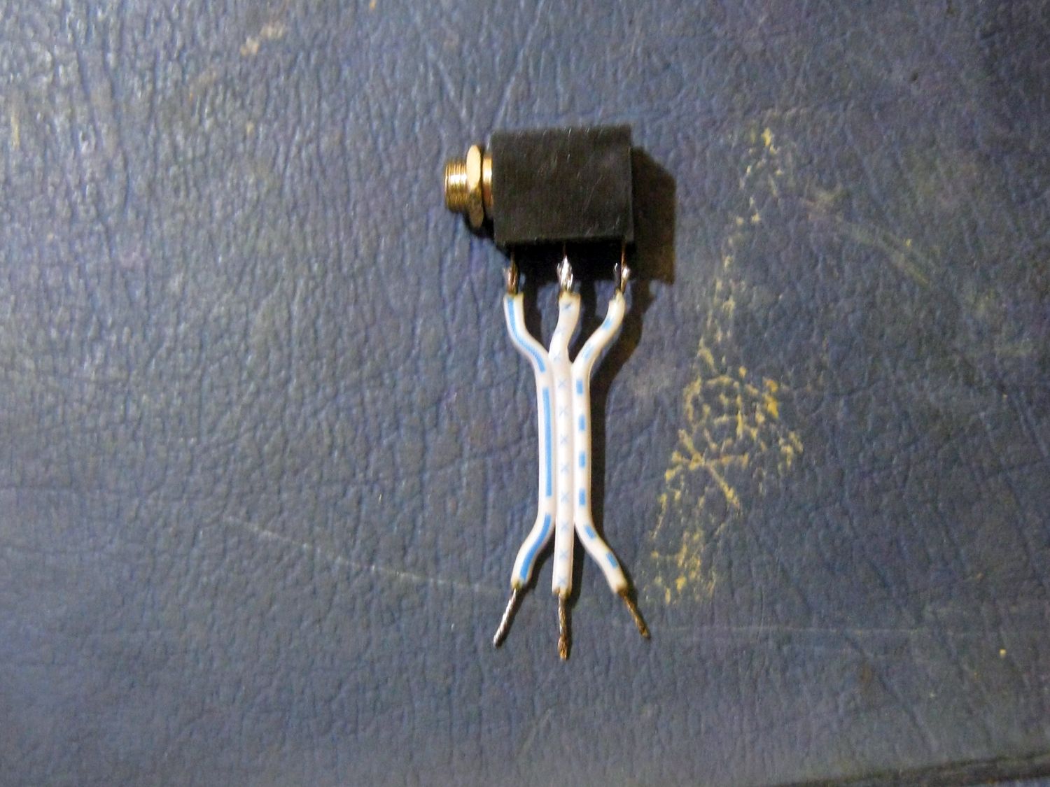

    And here's a pic of the modified new DC in socket:
Name:	New Modded_resized.jpg
    All I need to do now is solder the tinned ends of each of the three wires to their respective solder pads, and then mount the new DC socket in it's mounting hole in the pedal's casing, and then the repair job is done.

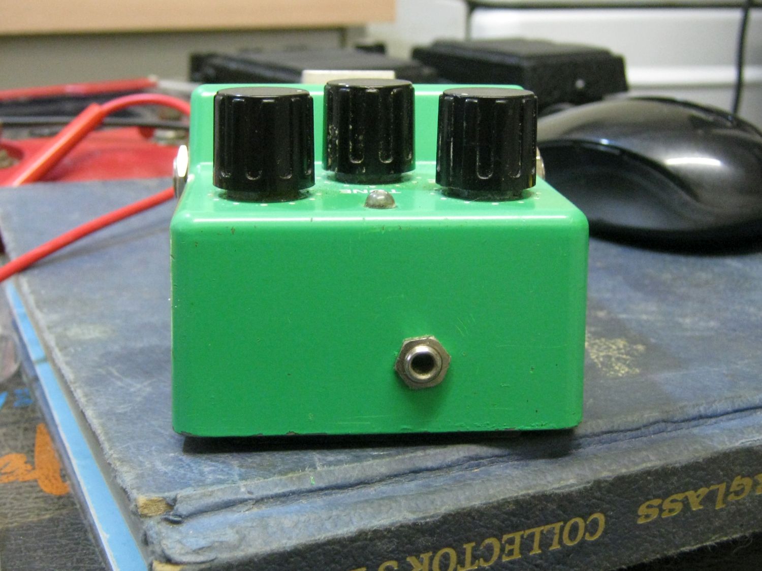

    Just tested it out prior to putting the pedal back together again, and the pedal seems to be working properly again with it's 9V battery powering it, so...I'm calling it fixed.
    And as you can see from the pic, the repair is un-noticeable:
