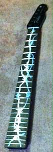

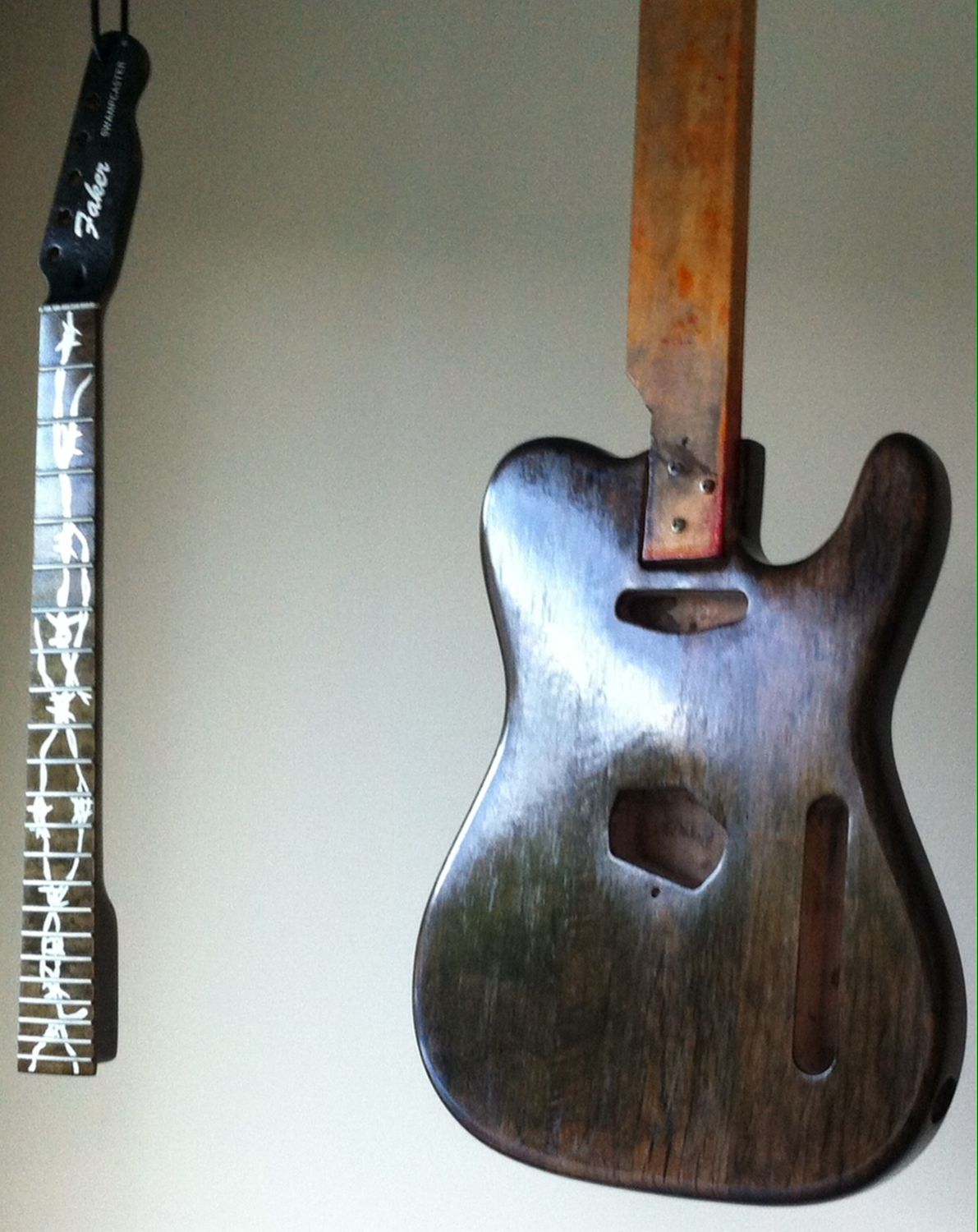

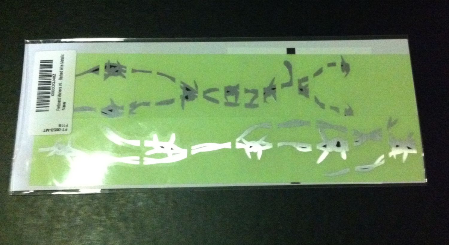

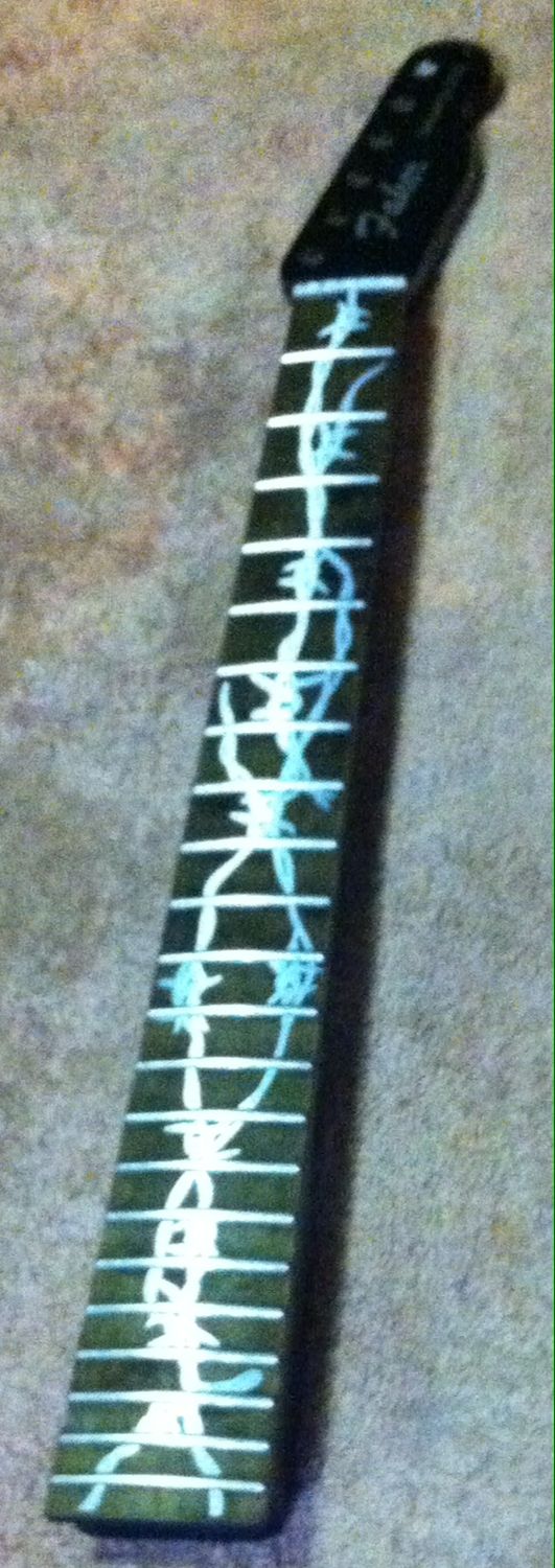

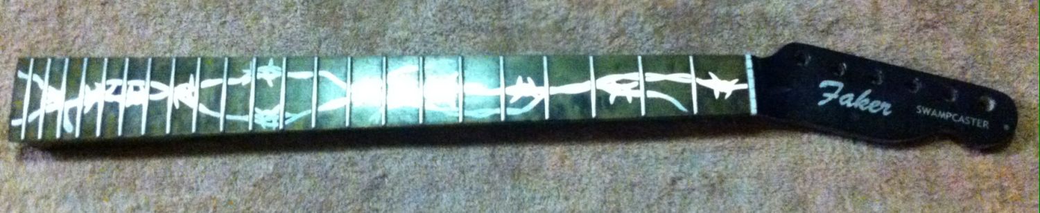

    Fret board bling arrived today
    After a big day at work today it was a nice surprise when I got home to open up the mail box and find a package that was not expected to arrive so soon. I was almost going to keep this hidden until the final reveal but just couldn't keep it all to myself.
ID:	16857Click image for larger version.
ID:	16858Click image for larger version.
ID:	16859Click image for larger version.
ID:	16860Click image for larger version.
    The stickers are actual thin metallic strips and will cover them with a couple of TO coats for OHS purposes. They were bought from Jockomo and come in Abalone or Pearl as well as the Metal finish.

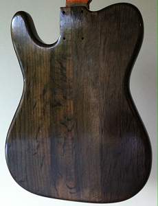

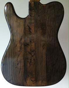

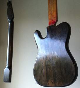

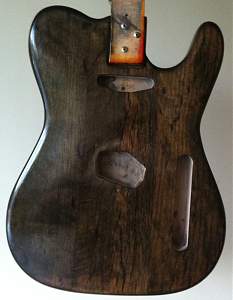

    Making progress.....
    Here are some shots after about 5-6 ragged on TO followed by 4 x 600 grit wet sanded 50/50 TO & turps coats, followed by 4 x 1200 grit wet sanded 50/50 TO & turps, then 1 x 2000 grit wet sanded 50/50 TO & turps - on the body. Neck had about 6 ragged coats and now 2 x 1200 & 1 x 2000 wet sanded 50/50.
    Feels smooth as a baby's bum and quite surprised how shiny it is. Just put on the 2nd x 2000 wet sanded coat and whilst wet it was looking almost done. 2 more at this grit level and will then let it cure for a while before doing the micro mesh stages.
