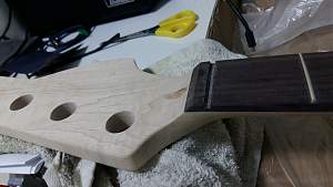

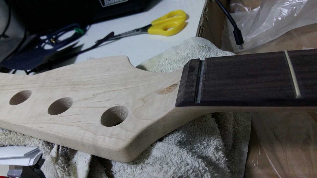

    i have been working on neck these days.
    sanded out head stock and neck itself with 120-180-240-320 grit.

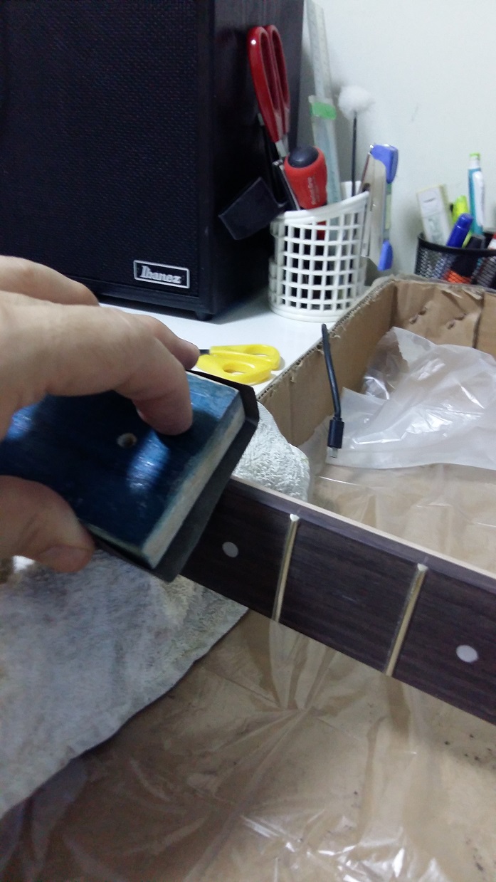

    After that, have started dealing with fret board before going to lacquer finish, decal on head stock and neck backside.
    I prefer rounded edge a bit on fret board and headstock.

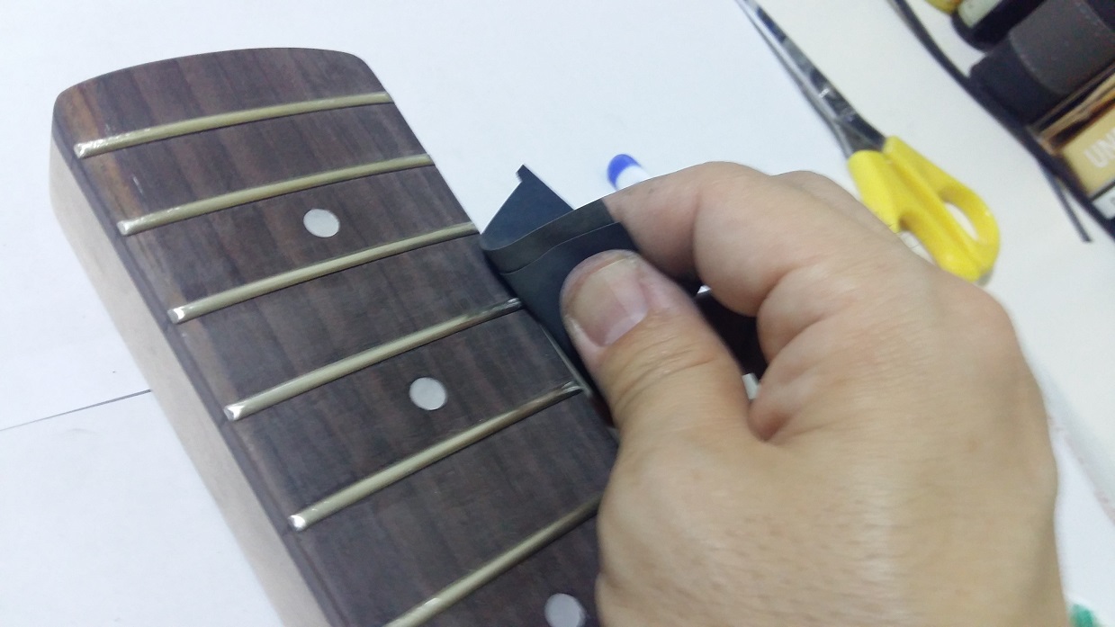

    and fret bar edge as well.

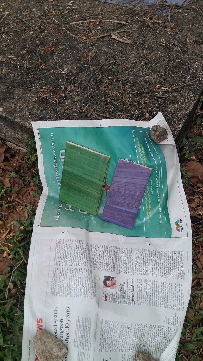

    Hi Wok, I have Keda dye powder kit. i tested on small veneer as below.
    it was bit too light, but thinking go for purple with stronger tone, hoping to make gloss finish at last. but as for primer, i tried to buy a clear primer spray from japan, but not successful. so I am thinking to use several coats of water-base clear varnish alternatively before finishing with clear lacquer spray. But i dont know if it works well...

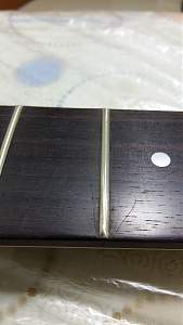

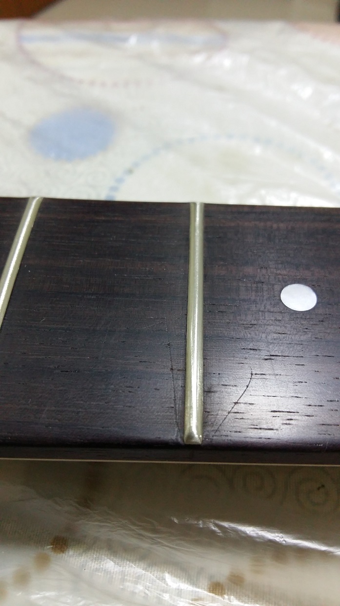

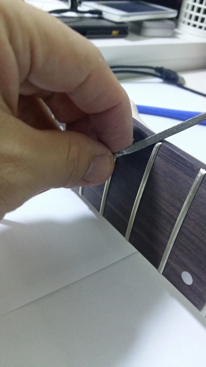

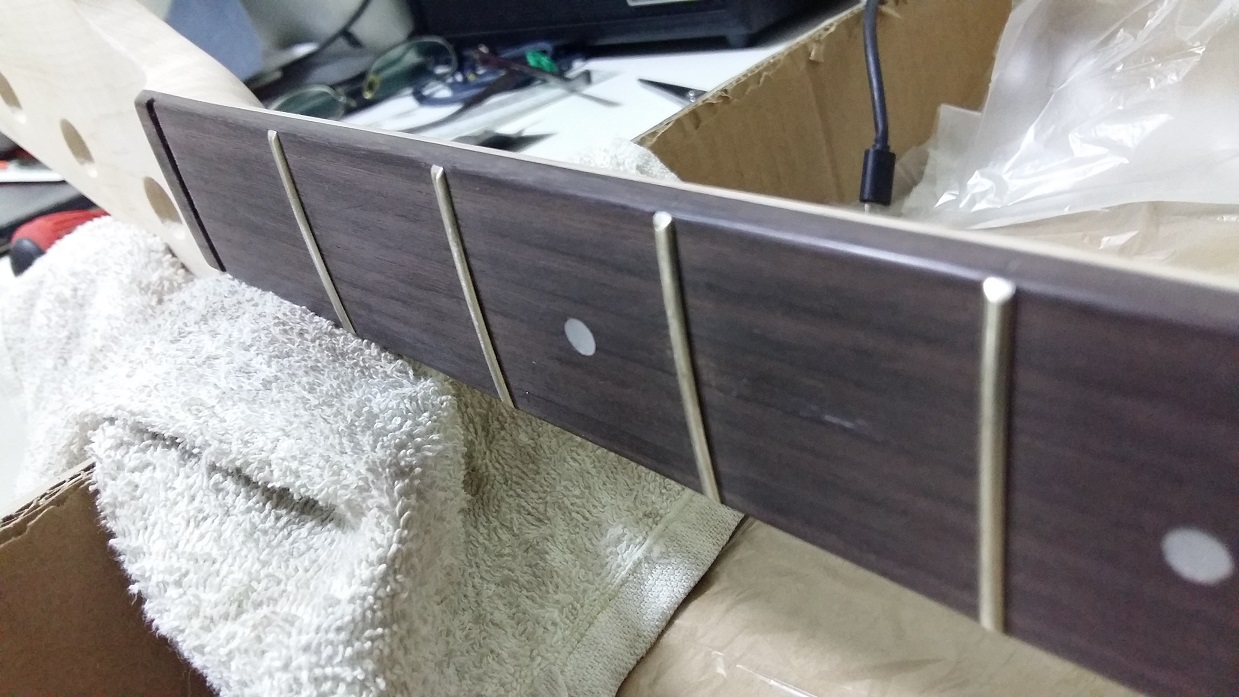

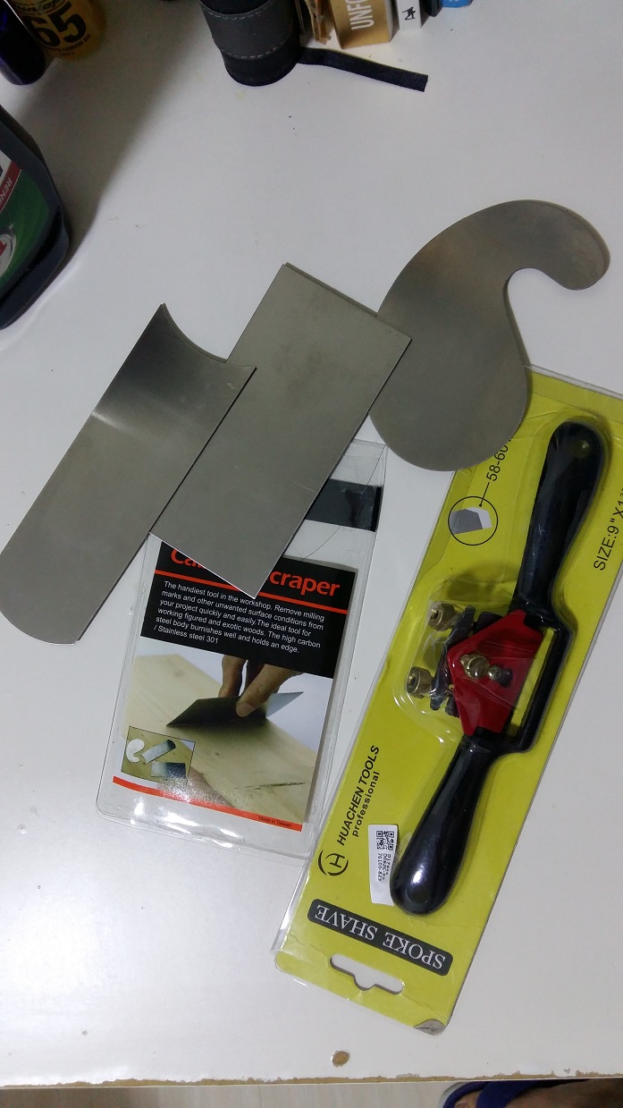

    Thanks, Simon! now i have powerful tools, cabinet scraper&spoke shave, they help a lot by the way, when i round the fret edge, i made bit scratches on fret board by diamond file. but i feel better just leaving it as it is than sanding down till it disappear...
