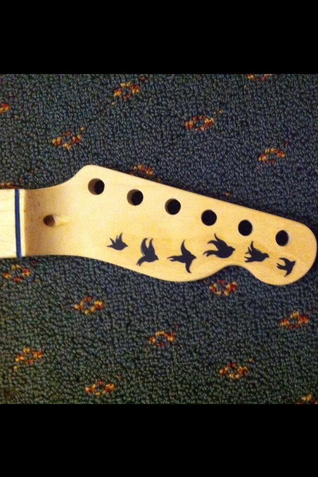

    You've only got the thin top strings covering the birds, so they'll all be pretty visible. Just be careful where you position the string tree(s) so they don't clash and you'll be fine.

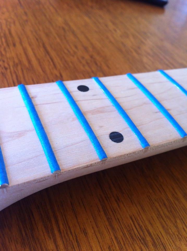

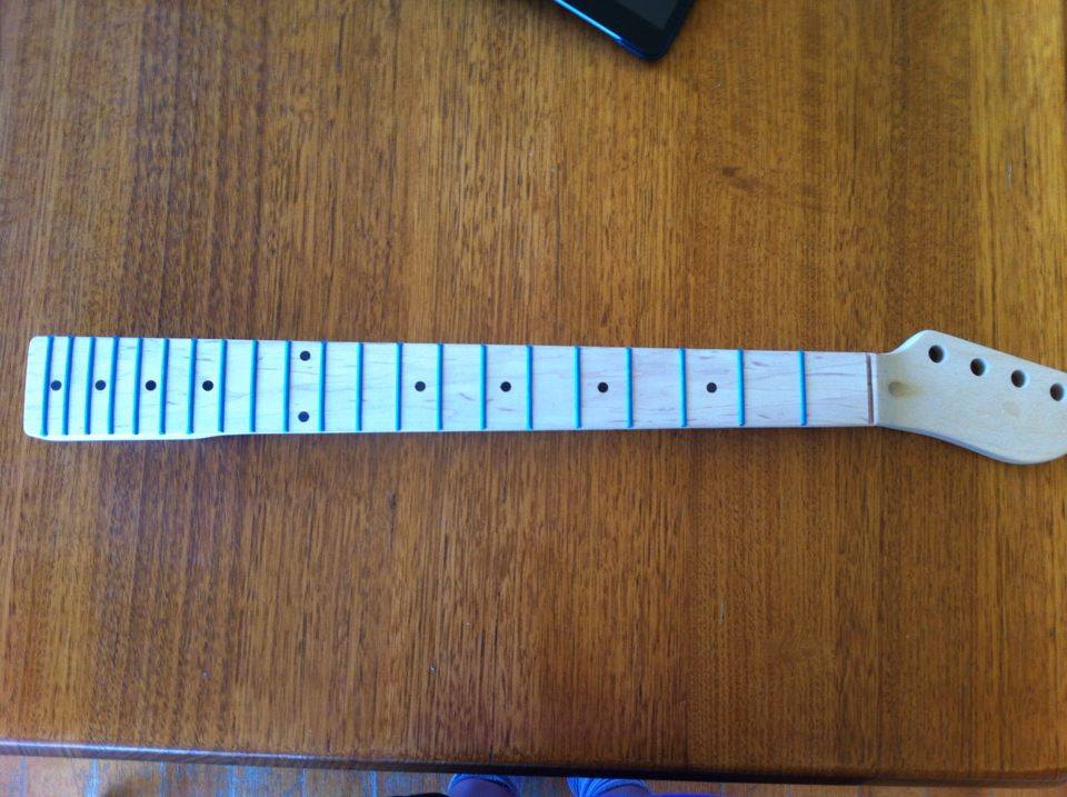

    Started putting clear coats on yesterday. 2 done on the neck (have to wait for decal paper to arrive now before any more go on) and 1 on the body so far. All going relatively smoothly.
    To avoid having to scrape clear coat off the frets at the end, I taped them... All of them.... And the nut slot too...
    Haha one of the more painstaking tasks of the build so far (right up there with sanding) but hopefully will be worth it in the end. Click image for larger version.

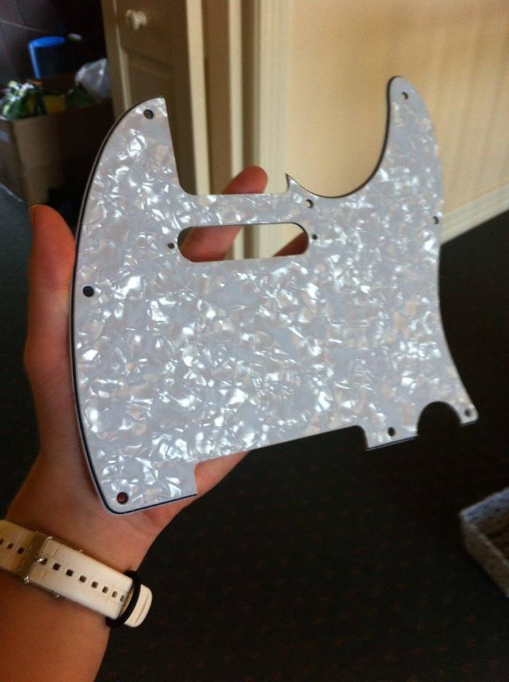

    Also, my new pickguard arrived in the mail the other day. I ended up buying from Ebay on Adam's recommendation (PBG was out of stock for some time). Seems to be pretty good quality so I'm happy. Quick shipping too

    nice work Moo you are motoring along ! When the clear coats have cured I would put the neck pup in the pickguard and do a mock build with the bridge and control plate to make sure they all align.
    Must have been a fiddly job taping 21 frets !
  5. #55
    Blue frets... that's some hardcore masking!

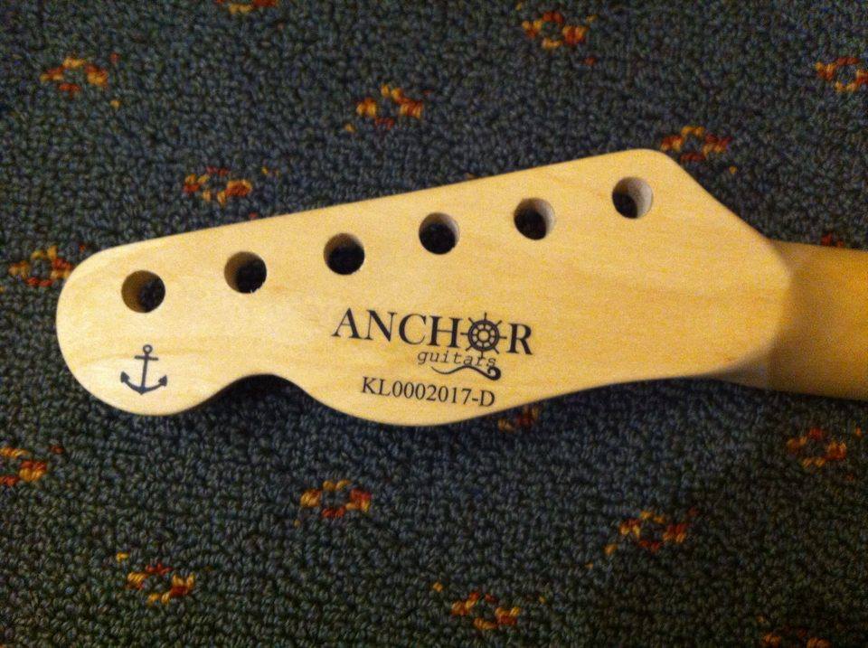

    Decal paper arrived today so was able to get them done tonight. Happy with the result. Decided to put my 'brand' on the back too just for fun.

    Looks a bit crooked in the photo but I swear they're straight in person haha
