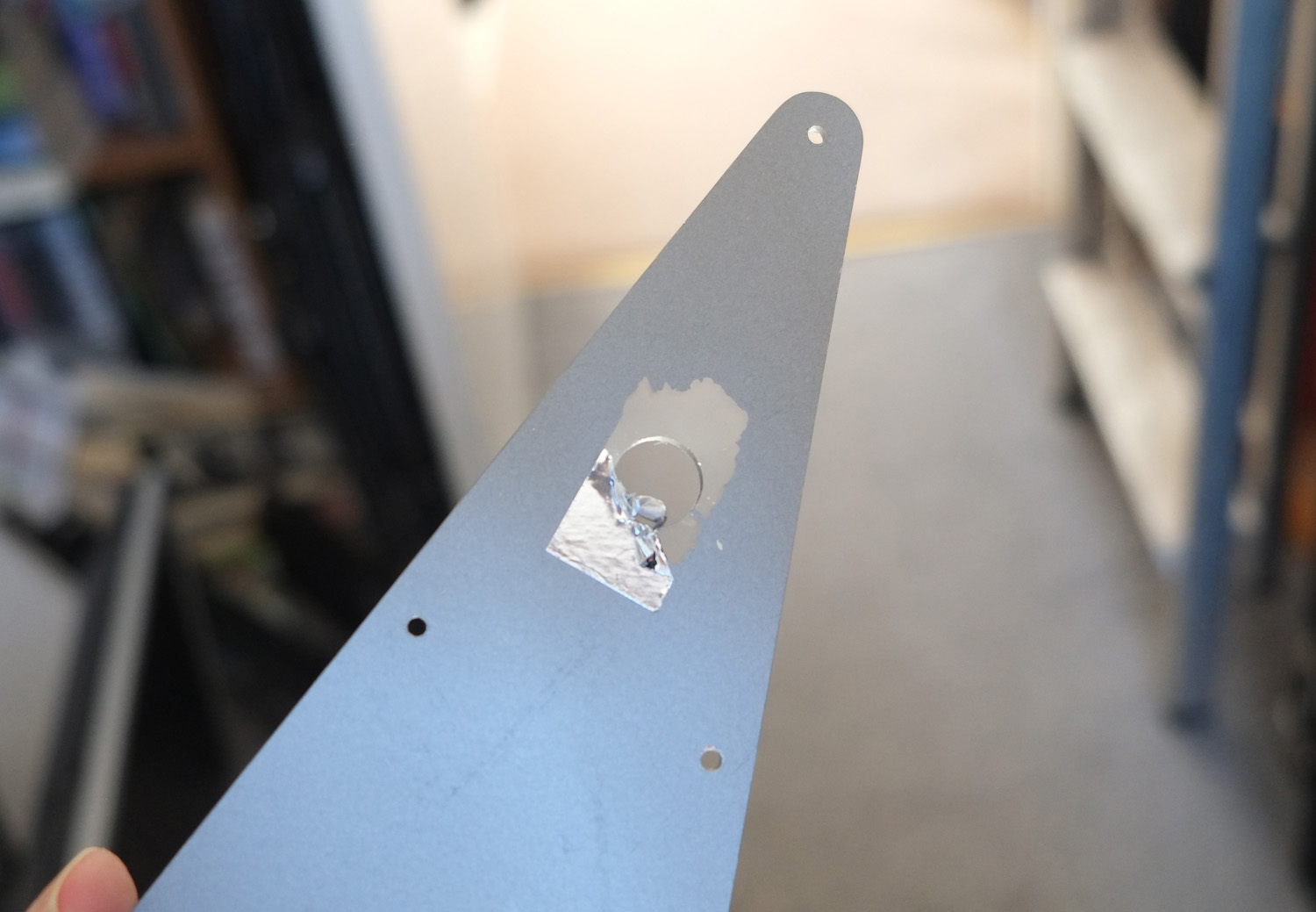

    Well, one step forward, one step back with this guitar.
    Decided to go the selector switch on the lower horn route, so needed a pickguard to cover up the switch cavity and cable routs. Decided on a mirrored one to go with the white finish I'd decided upon, so ordered one from WD Music around 40 days ago. These are custom order from the US, so it only arrived today.
    Checked it against the body and it looked fine. But there was a bit of silver foil taped across the selector switch hole which needed removing. So I tried cutting the foil out, but it creased up round the edges and when I went to pull it away, it pulled all the mirror backing off with it.
    I was not impressed as it cost £40/Aus$64.
    Underneath:

    But after a couple of emails, they are sending me a new one in the post (hole in the foil pre-cut by them) as they ordered some spares along with mine (maybe this happens a lot) so a new should arrive in a couple of days, and I don't need to send the old one back. So, good customer service, but it's going to happen again to other people unless they put warnings on this type of plate - or better, just pre-cut the hole out.
    But now I can at least mark out the hole, and rout out a switch cavity and a cable channel.

    That's a bit of a disappointment. I've always wondered about how fragile the mirror finish on those are. Does this seem like it was just a weird situation, or will the mirror pickguards be extra susceptible to impacts on the edges?
  5. #55
    I'd imagine that there's a thin layer of aluminium(or aluminum depending on your location) 'sputtered' on to the clear plastic, so that it's only a few atoms thick, and then the back is plastic coated to stop the aluminium from oxidising and going dull over time. The plastic seems to protect it round the edge, just that the plastic backing sticks to the aluminium better than the aluminium sticks to the clear plastic, so it's all too easy to peel it off if you've got some tape stuck to it.
    There's also a big oval WD custom pickguards sticker stuck on the back which I'd much prefer if it wasn't there as I'm going to put some shielding tape on the new one, and it would be a lot better if the back was simply flat.
  6. #56
    Had a strat acrylic mirror scratch plate a while back and they do deteriorate over time. On my 1980's Explorer I actually had a glazier cut me a glass mirror in the triangular shape only and thankfully they also pre-drilled the holes. Looked awesome but after several hot sweaty gigs the edges went feral from salt corrosion through soaking up sweat. Brushed or polished aluminium is far more durable if intending to play frequently or do live gigging.
