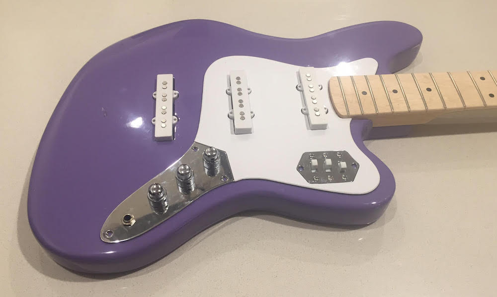

    After a couple of painfully slow evening sessions I'm almost there - and the process has ensured that next time around I'll spend the $50 to get the routing table like WeirdBits! Everything seems to have lined up okay and while it's not as perfect as the perfectionist in me would like, I'm ready to move on to doing the wiring!
Name:	Pickuard done 181116.jpg
    Although now looking at the picture again I think I might to do a little more bevelling on the edge of the pickguard, although it looks okayish in person...
