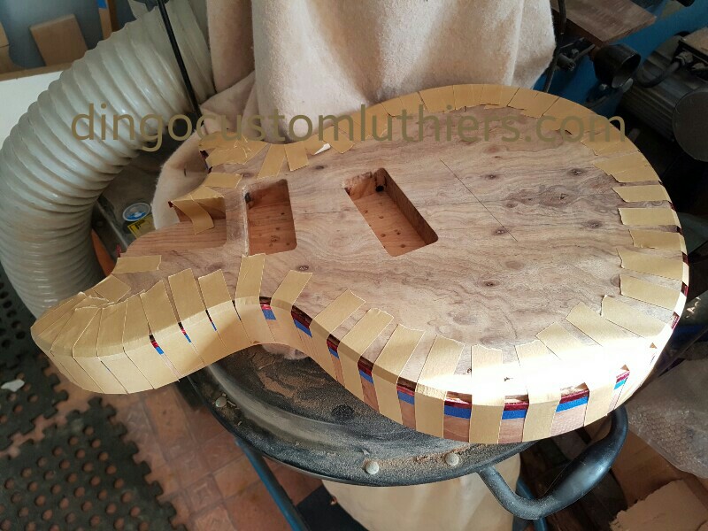

    Binding time.
ID:	11711   Click image for larger version.
