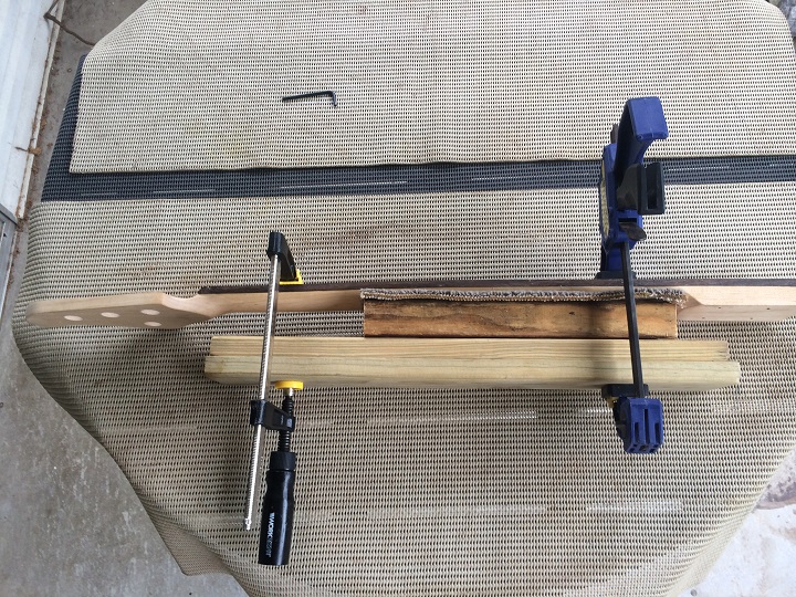

    Thats a pain...
    I don't think it's something you won't be able to fix.
    The truss rods are pretty tough, I have put them through the DB Destruction Testing Laboratory and twice I have snapped the allen key..
    So, whilst you have it clamped down wind the truss rod in until it bites in then leave the neck for a few days and see how it looks

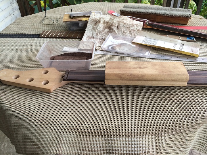

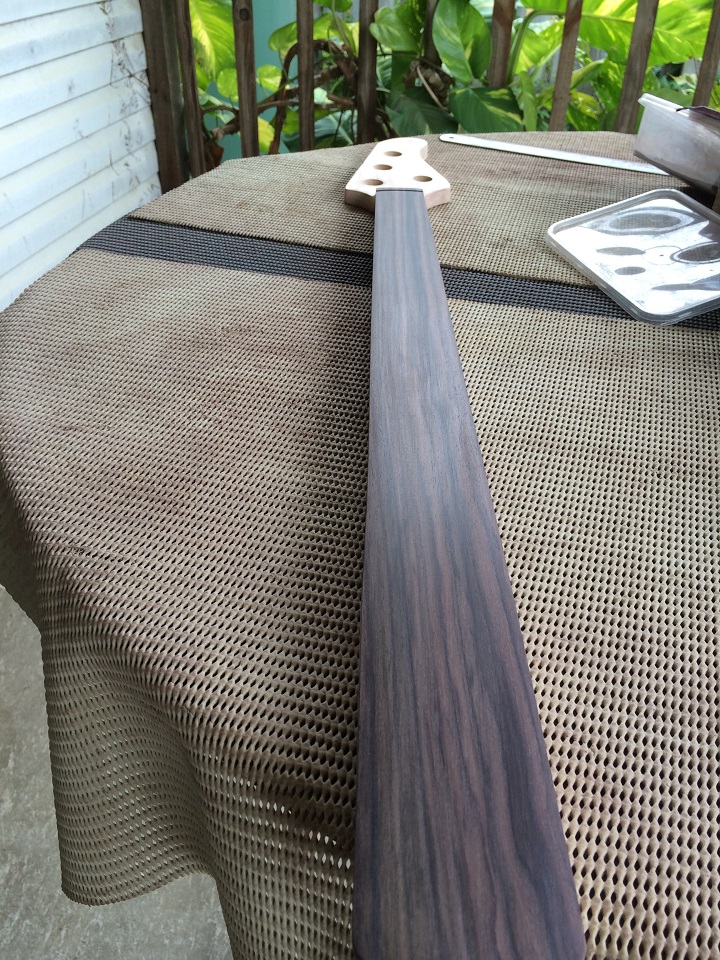

    Well, thanks to you guys I’m back on track.
    I left the neck clamped under tension progressively tightening the clamp and the truss rod. After about 5 days the neck has reset to be fairy straight even with the truss rod loosened right off.
    After quite a few hours of sanding with the radius block I have now got the fb close to what I want. Unfortunately I didn’t do such a stellar job with the sanding and ended up with a somewhat wonky radius. But I intend to coat the board with a fibreglasss resin so I get to try my sanding skills all over again. Yay! Having learnt by my mistakes I hope to do a better job this time.
    Pic 1 – The neck all clamped up
    Pic 2 – The radius block and a container of Rosewood dust. I always keep the dust from the different woods I use in case it’s needed for repairs etc.
    Pic 3 – The straight edge says “Meh, OK”

    Some more of the fingerboard.

  8. #58
    Moderator dingobass's Avatar
    4,491
    Ahhh, the joys of sanding radii on fingerboards
    Nice job with getting the neck straight.
    Now for my two cents re: fibreglass resin.. Don't do it! It will gunk up your strings like crazy and may actually make the FB tacky to play..
