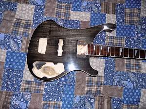

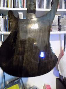

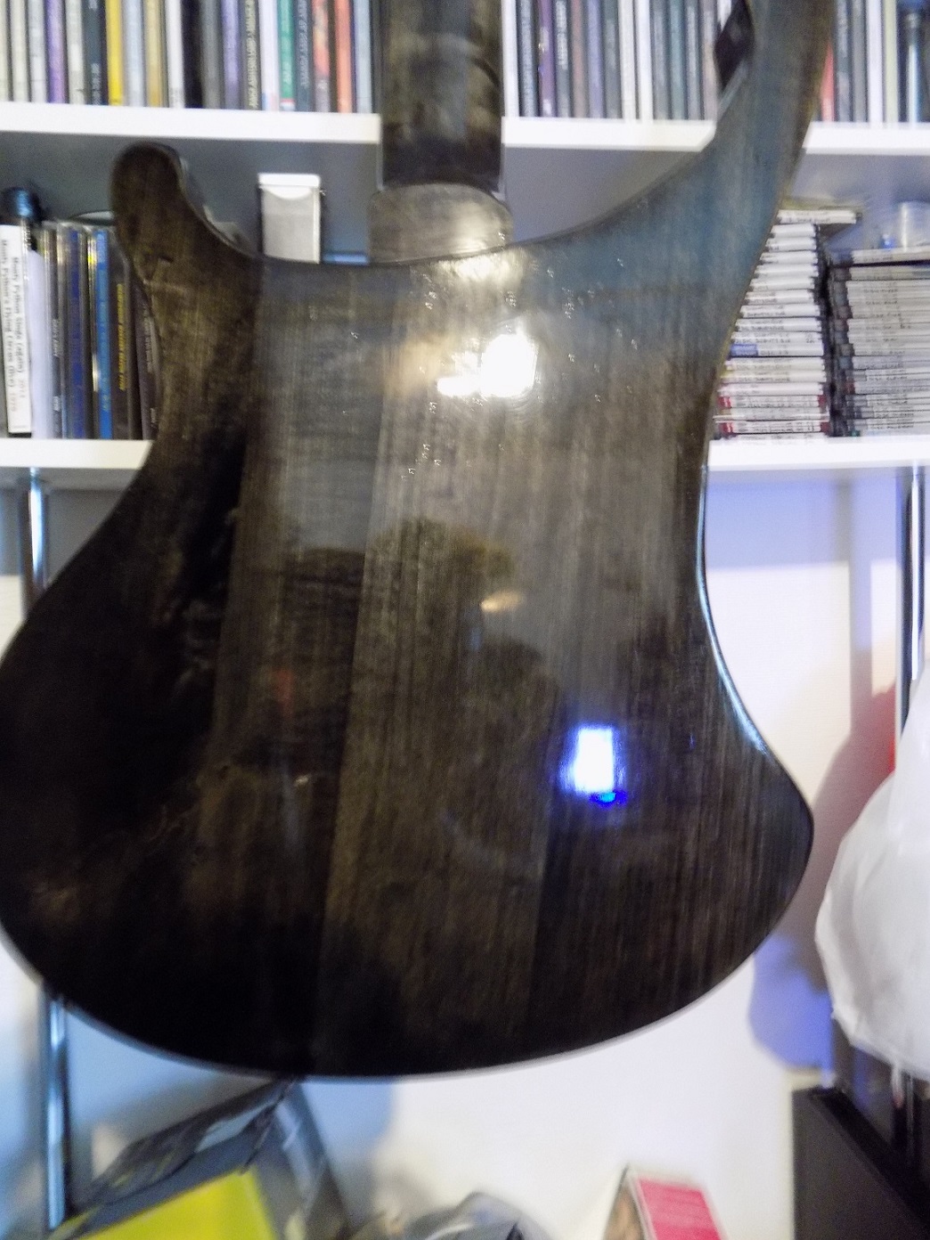

    Shine baby shine
    Glossing up really nice, taken without flash, so a little bit of shake glitches
    looking great Paul, looks like you aren't too far off assembly !

    The finish looks fantastic. Good job Paul.

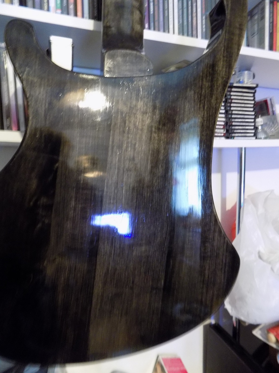

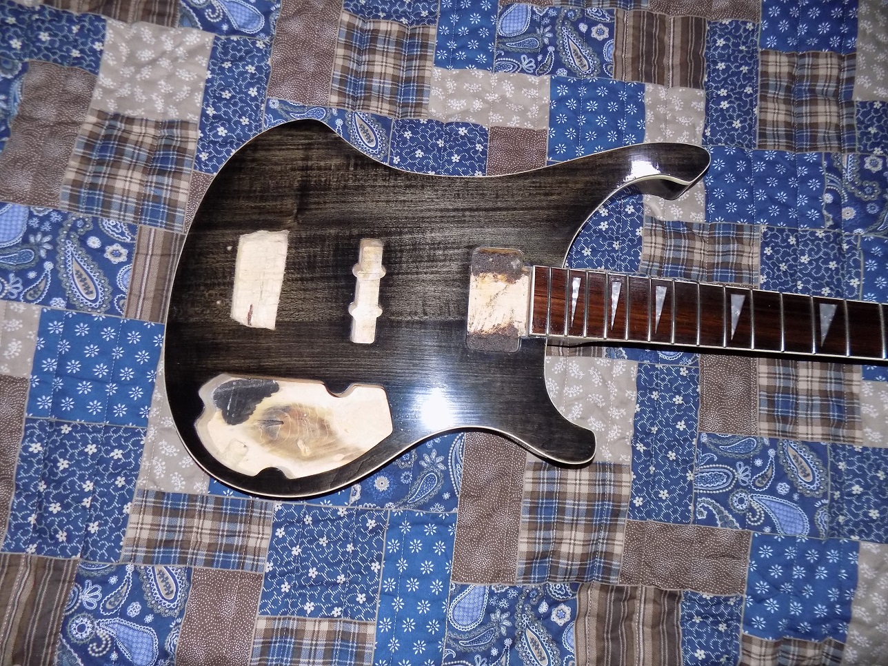

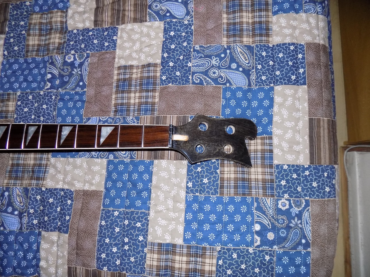

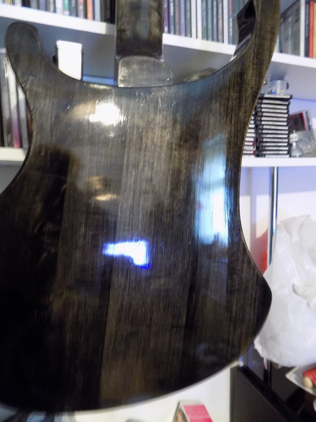

    Progress
    Greetings, spent the day with the buffer and various polishes working on the finish, it is taking shape and i will have another look in light of day before i make my mind up.

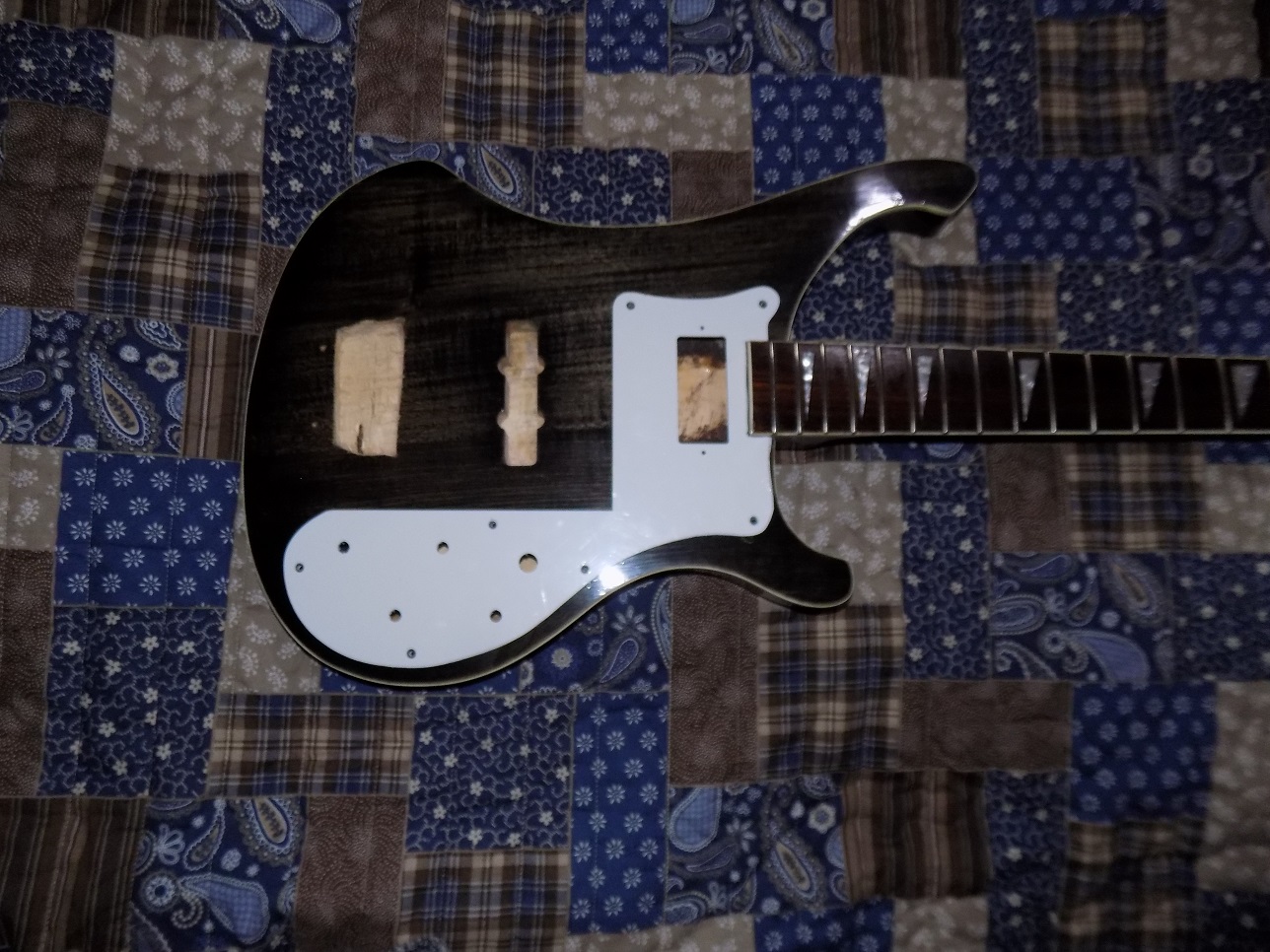

    I have notched out the scratch plate to sit around the neck, i will work on getting the overall shape a little better and i may add a chamfered edge to the scratch plate.
  10. #8
    looking good Paul on the home stretch now !
  11. #9
    Finish is lookng great! Some really nice shine you've got there.

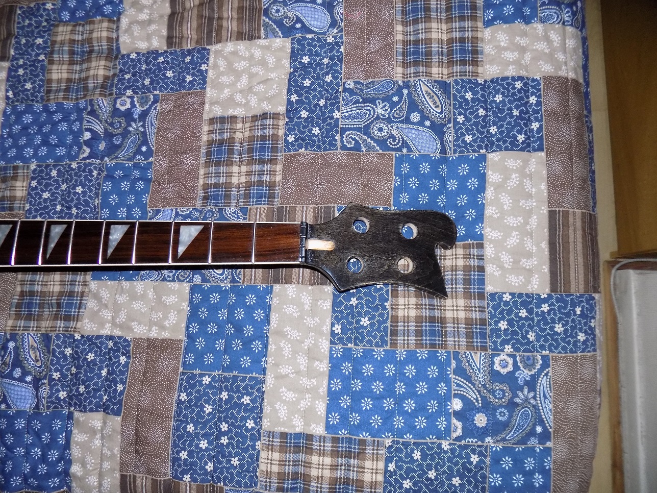

    Well totally pi$$ed off, attempt to secure the machine heads even with pilot holes 2 screw heads have snapped off, talk about cheap garbage steel. Gonna have to work out how to extract whats left of the screws from the timber without doing too much damage, not impressed one little bit.
