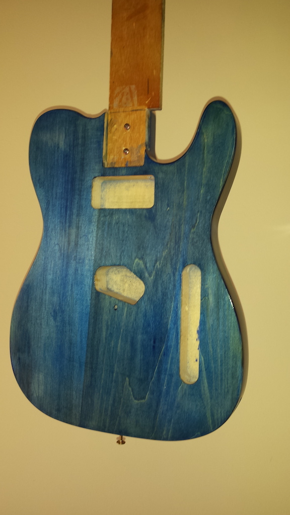

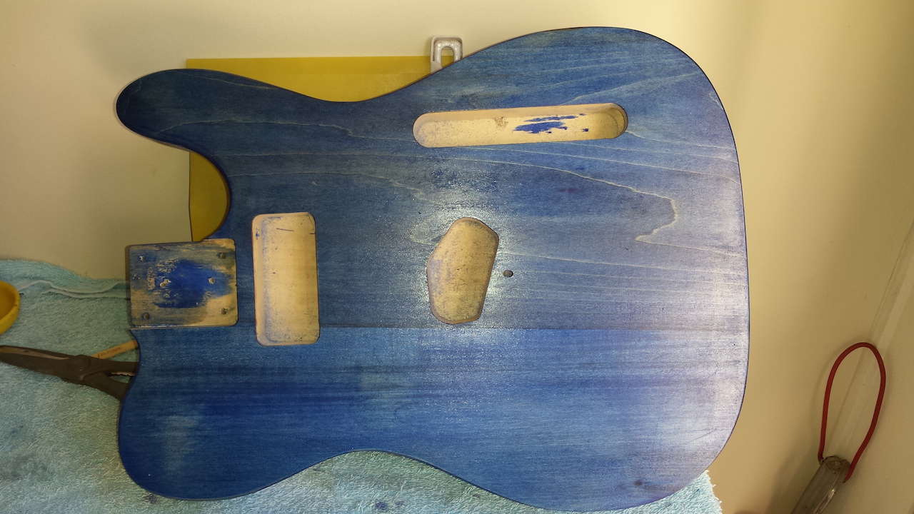

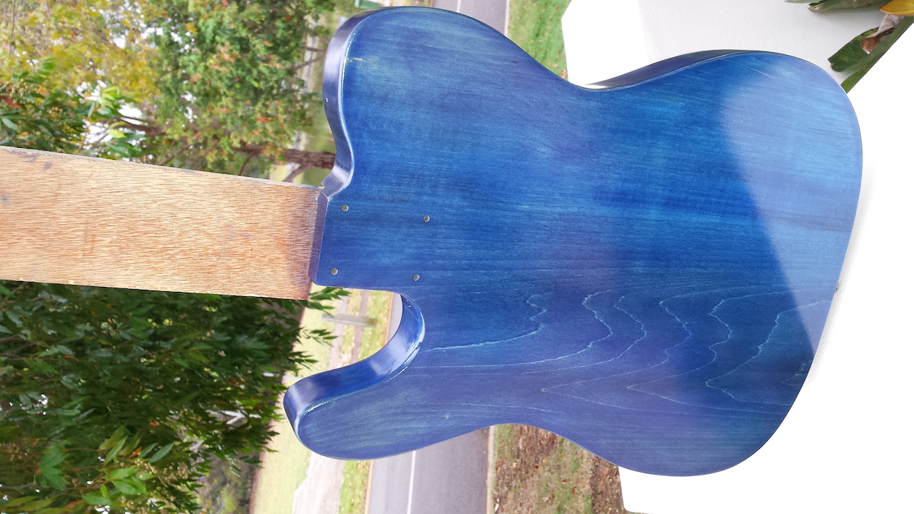

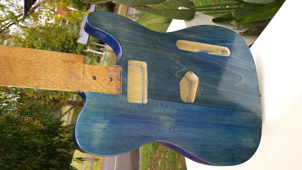

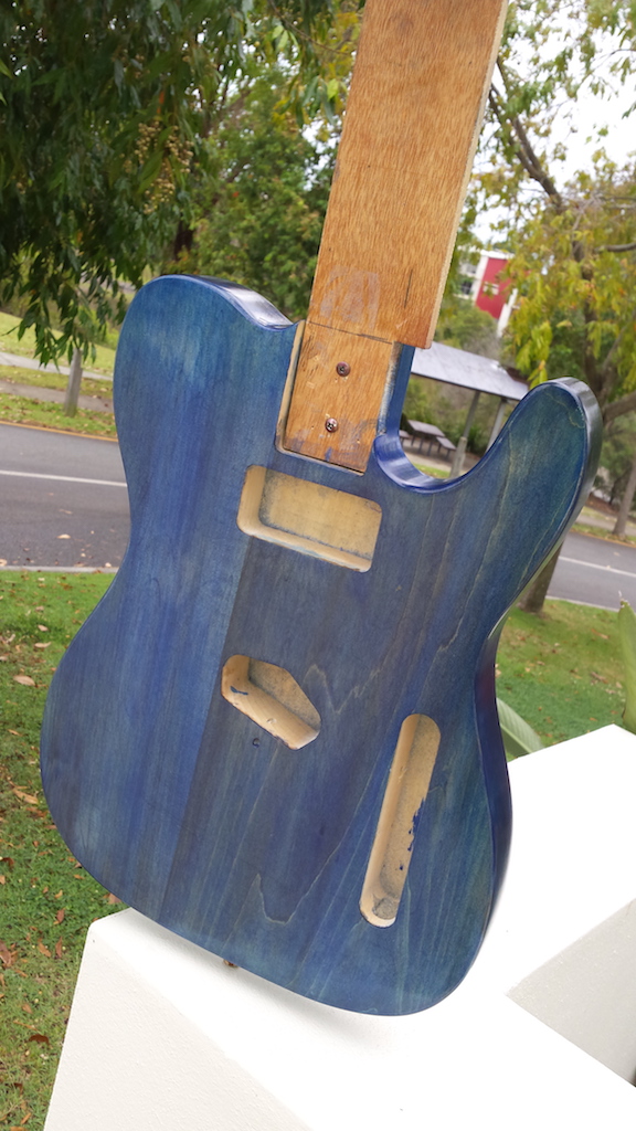

    Ok! what miss adventures have I encounter today?
    First thanks for the replies and that is a nice looking tele, maybe with the different shades of the same color mine may still look ok.
    I looked at and decided to do what I should have done a few days ago. the little ink, that was mixed the same color, I added a few drops of ink. Just changed it a little and I think it is looking "better", will see what it looks like when it has dried until tomorrow.
    Let it sit for a few hours then sanded the back with, second hand 240, then did a silly thing. Rubbed my hand over it to see if it was smooth enough. after scrubbing the blue off my hand, I gave the back a coat of tru-oil. No more work on the back just keep putting oil on until I have the guitar to a finished state, However the front may be a different story, tomorrow will tell.
    3 photos
    1. the front with the darker blue.
    2 & 3. the back one on the bench the other in the sun light.

  4. #54
    Hey Rick the back looks stunning in the sun. Don't leave it out in the sun thinking it will cure the oil quicker.
    Best leave it in a well ventilated room or out of the sun.
    I wouldn't worry too much if you can't exactly match the colour of the front compared to the rest.
  5. #55
    Colour on the back looks great. Gradually adding more ink might just be answer for the front if you are aiming for a bit darker shade.

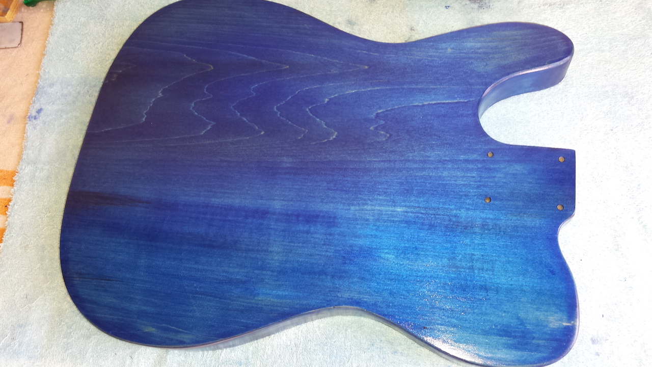

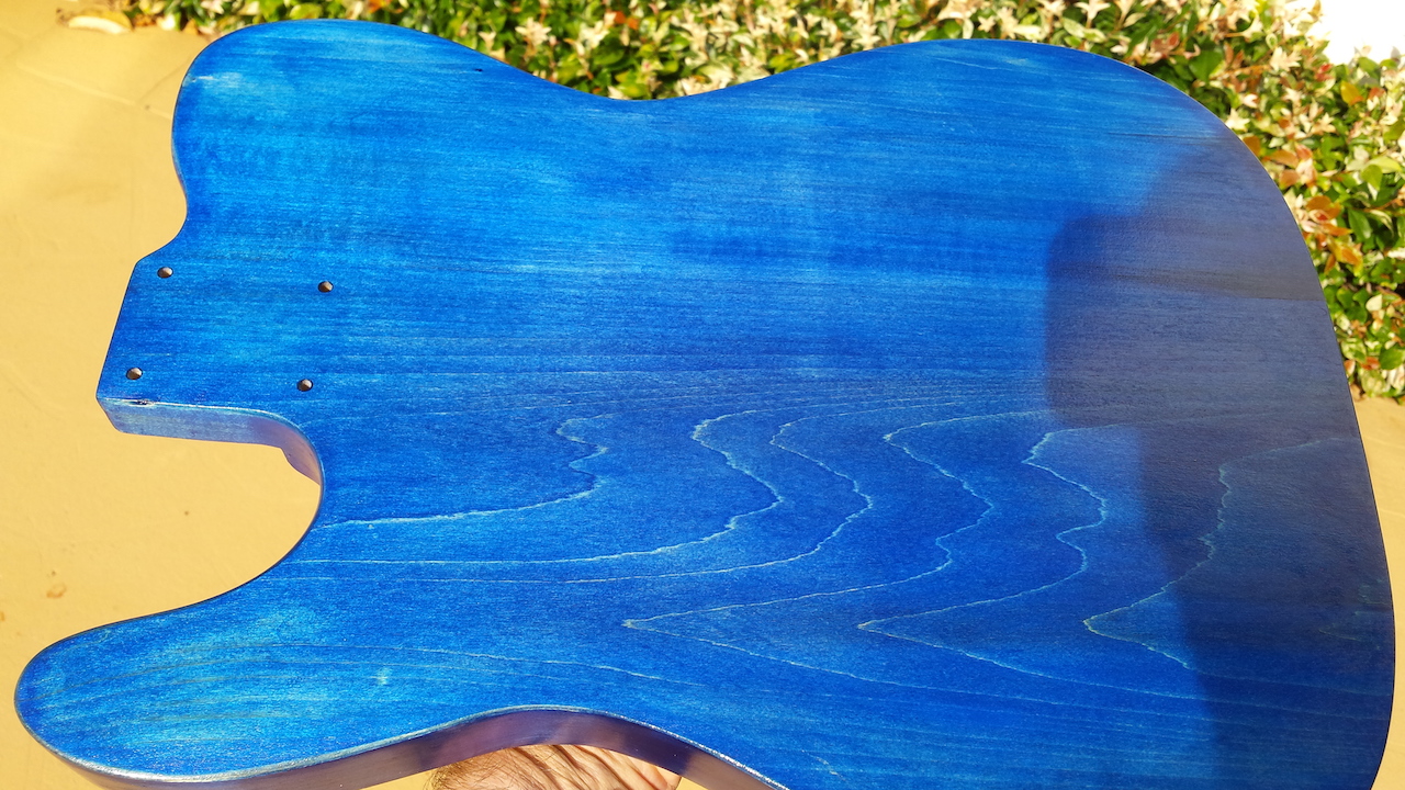

    At least I think the end is in sight. After a few days with nothing happening and about 4 or 5 coats it is starting to show signs of a finish I will accept.
    The biggest mistake was me not doing the front that same as the back, I should have just not tried to make it different but thats the way it is. The back is almost perfect (for me) but the front is a bit pail but the finish is starting to look nice. So, another few coats and I will start to assemble and do the set up.
