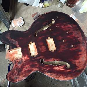

    I sanded the top coats back and tried to re-stain with a mahogany colour (feast watson) but as you can see by the pic..epic fail!

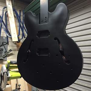

    3 Colour coats using Duramax flat black. I’ve never used this product before but I must say it was super easy and the finish is flawless.

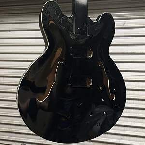

    Onto my 5th coat of Cabots gloss polyurethane and I couldn’t be happier. It's like looking into a mirror! Leaving to cure now and will do cut/polish and assembly after Christmas holidays.
