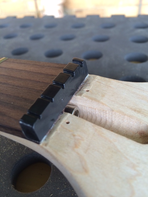

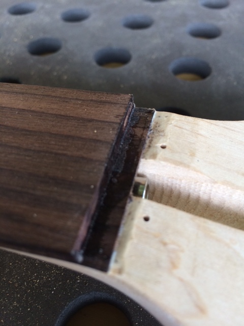

    Bone nut upgrade

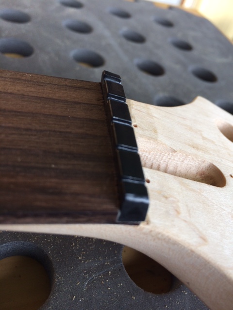

    My Dingobass bone nut upgrade arrived today, so I checked it over then clobbered the old plastic nut with the end of a length of pine sliding over the frets.
    The old nut:
ID:	2721Click image for larger version.
    Came off fairly clean, going to go that with a small file to smooth off any old glue.

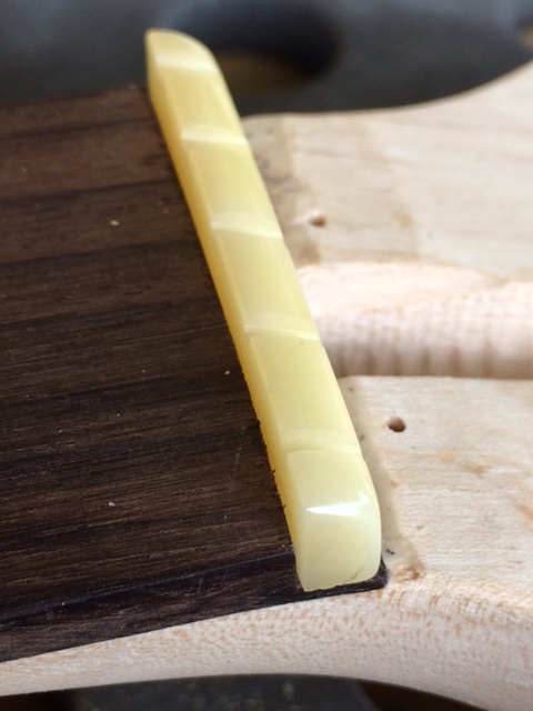

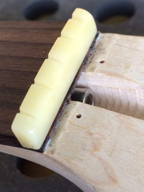

    The new nut:
ID:	2724Click image for larger version.
    Not actually glued down yet.

    looks good Tindrrel. I got a bone nut cut by DB for mine as well.
    Be worth putting the bridge on and test the string spacing for B and G strings

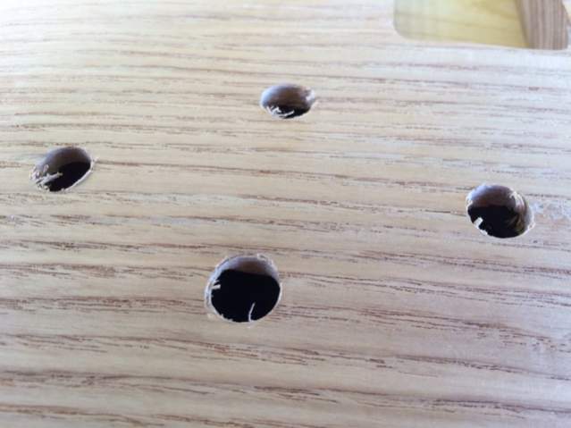

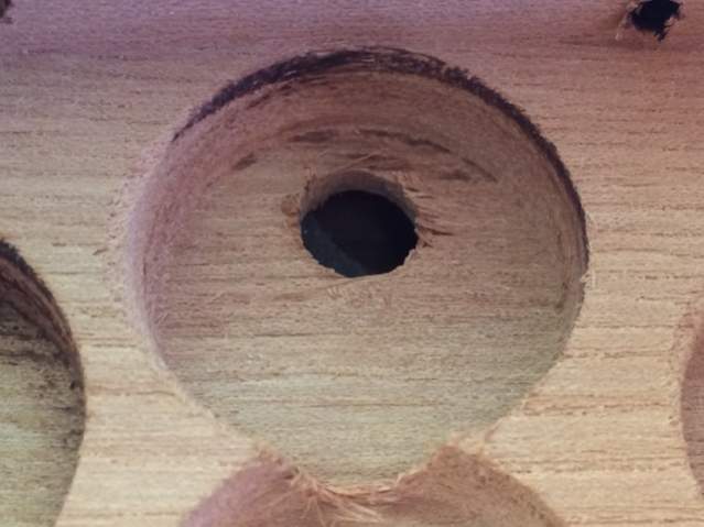

    Potholes enlarged.
    Bit the bullet and ordered the Bourns upgraded pots. They're a larger threaded section than the metric pots provided so had to enlarge the holes.
    Now that's done, last of the drilling, routing and shaping, I can get to sanding the body for the finish.
    Definitely wouldn't ever get a 24mm full size pot in there.
    A pity, since I can't seem to find quality 16mm mini pots with a linear taper - despite knowing they are possible, since the kit came with some (even if all four pots, 2x audio and 2x linear have exactly the same code on the back).
    - Sam

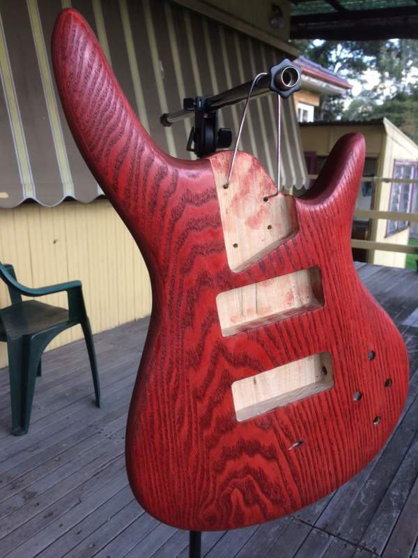

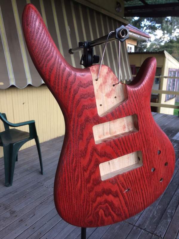

    Sand and stain.
    So a few hours sanding (my last post was during a break from that).
    Used 320 and 400 on the front, 240, 320 and 400 on the back until it all felt about as smooth as it was going to get.
    The grain changing directions with each of the segments was interesting to cope with. Had to be careful at the edges of the veneer as the grain direction on the veneer and the direction on the body behind it rarely matched.
    (Did earlier IB-5 kits have a veneer? Looking in the gallery they seem to have the lines where the separate parts of the body planks show through to the front - as if they didn't have a cap on them.)
    Clean up, then apply the Dingotone Nullarbor Ochre.
    I put a dash on a scrap of pine first and it was much redder than I expected, but I instantly liked it, so I went ahead.

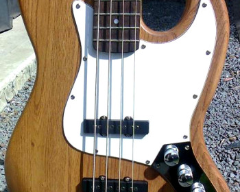

    I was expecting more like:
    from the PBG store page on Nullarbor Ochre.
    What I got was more like:

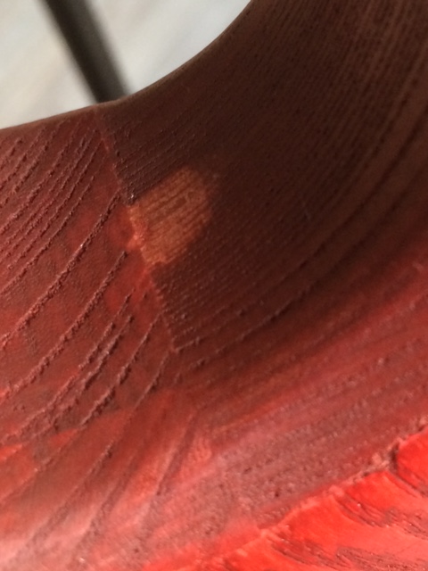

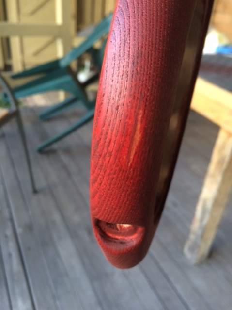

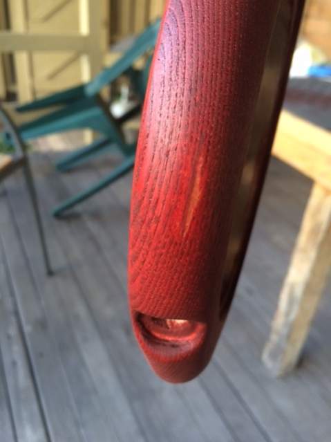

    Aside from a couple of places it stained evenly. Perhaps these were repair spots. Along the bottom of the body and where the planks join under the top horn.
ID:	2740Click image for larger version.
    Give it a few days and then some and I'll apply the intensifying coat.
