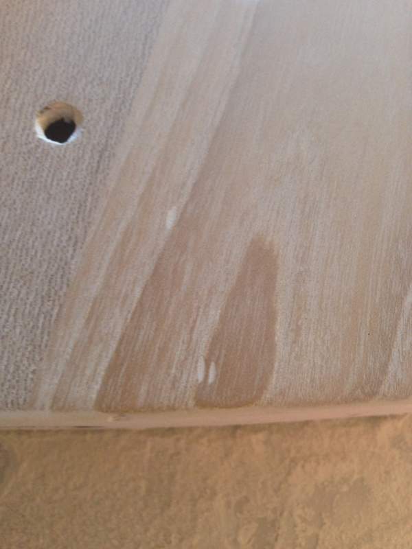

    right so I've started sanding it back by sanding with 80 till I could start seeing the wood then switching to a combination of 240 and 320 which has completely worn through one strip of 320 without even clearing the top but I have run into an issue, as I was sanding I have found what appears to be three dents which to the best of my knowledge weren't there pre timbermate application as a result these dents have been filled with the watered down timbermate and have a markedly different feel and texture to the wood so as that they would easily be noticed if they had a gloss finish over them, what should i do about it? at the moment I'm planning on going back to 180 sanding them out and then working back up reapplying timbermate to that area and then I'm back to where I am now, should I try getting the watered down timbermate out of them and then putting in some normal timbermate acting as a filler or?
    thanks heaps for any help regarding anything I should do or might currently be doing wrong

    Hey Will, so are the 3 dents you are talking about the 3 small white areas where there's timbermate ? Might to pay to fill these with 100% timbermate will be stronger than watered down.
    Sometimes when bodies are hung up the wind blows them into a solid object, maybe this has caused the 3 small dents.
    Some builders have used an iron with a damp cloth to remove dents but I don't know enough about it to give advice on that.
    Since this will have solid paint I'd re-fill these areas and sand back
  5. #55
    yes those are the dents I didn't end up hanging it for application though it was hung up for a short period I think I'll try refilling it with 100% timbermate and see how that goes, any tips on how to get the timbermate thats already there out?
  6. #56
    use a sharp object to pick out pieces of the timbermate but wouldn't be too worried if it all doesn't come out. Just make sure you fill it nice and compact with the 100% filler

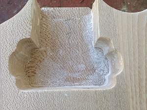

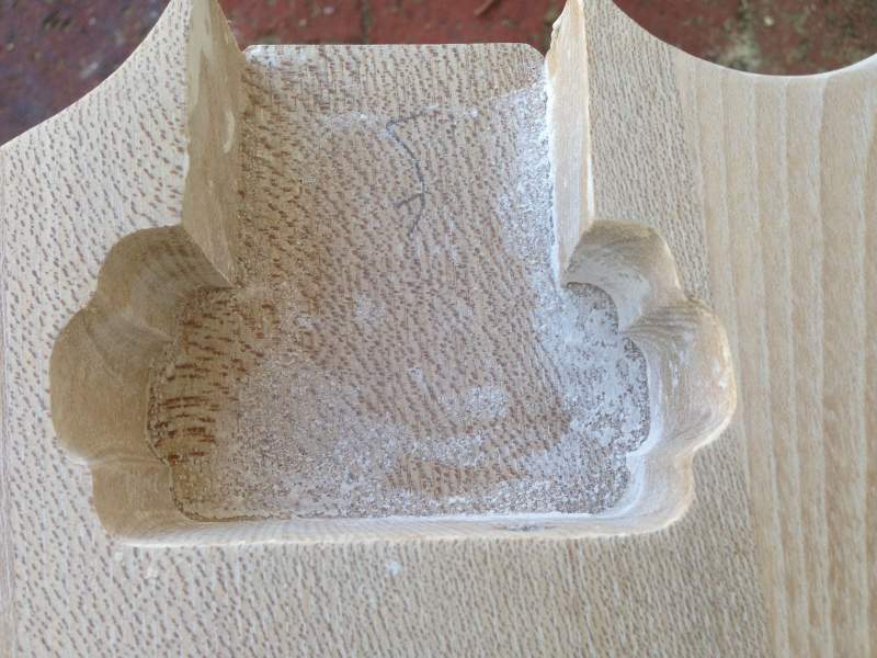

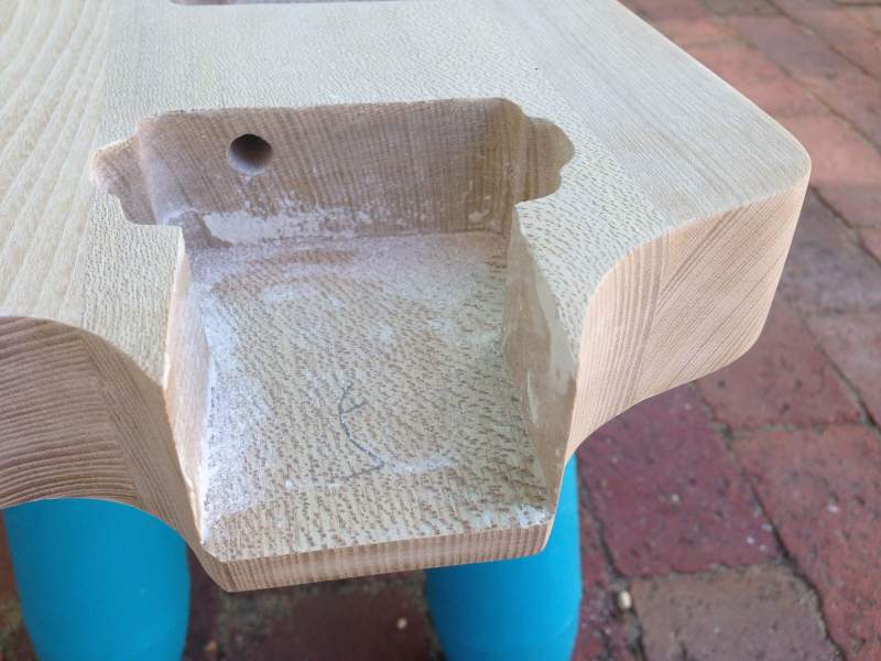

    Hey all
    Sorry I haven't updated in a while I got a bit busy but I've managed to get back to the build and I've got it all pretty well sanded up to 320. I ended up using 240 to sand back the timbermate but only till I hit wood so I didn't sand it out and then switched to 320. There were a few small spots that looked like they might not have been covered but now that it's sanded back I can't see any difference so will that be okay? There's a few spots that still need cleaning up and I was wondering if you could give me any tips on doing that, the areas in question are the bridge post holes the control cavity and control holes and neck pocket as well as a few small spots such as the small hole between the control cavity and the stop tail mounting hole ( I assume this is for a ground wire?) and a few spots along the edges.
    I may as well ask now since I'll probably be cracking out my rotary tool, will I need to shield the pickup cavities? I have some copper tape but as it is the pickups are a very snug fit and I'm not sure how to account for the thickness of the copper tape, I think I've heard some say that its not necessary to shield the pup cavities as they're humbuckers but I'm not sure.
    Anyway sorry for the wall of text here are some pictures:
    Attachment 1561
    Attachment 1563
    Attachment 1564

    Willem,
    sanding to 320 grit should be enough for solid paint. Yes the hole in the bridge post bush hole is for the earth wire. Don't forget to expose plenty of bare wire and run the wire to the control cavity when you knock in the bridge posts (once the finish is all done)
    I'd put copper shielding in the control cavity and don't worry about the pup cavities if its a tight fit
