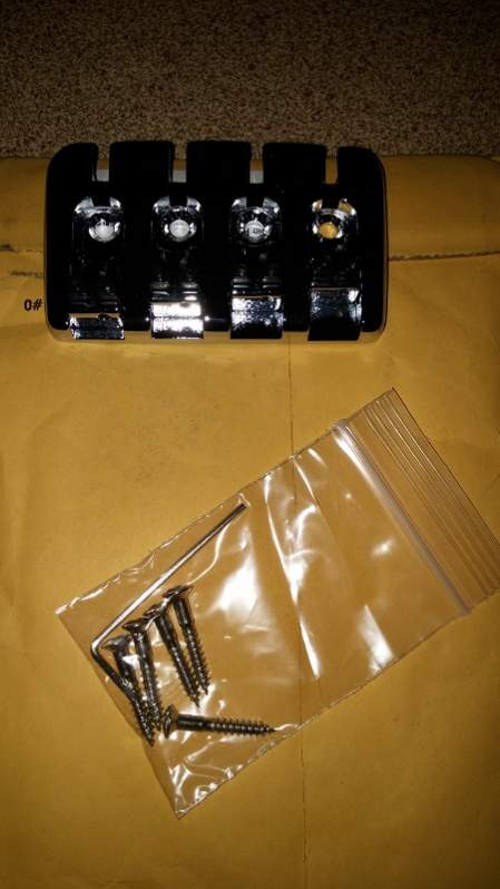

    Bridge was in the mail waiting for me at the end of the day.....measuring time.

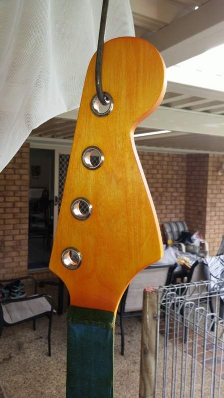

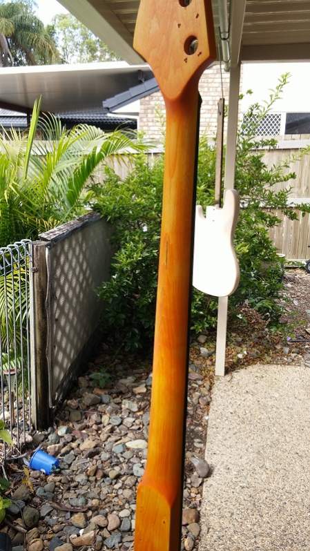

    Some photos of the remedial neck work.....
ID:	708   Click image for larger version.

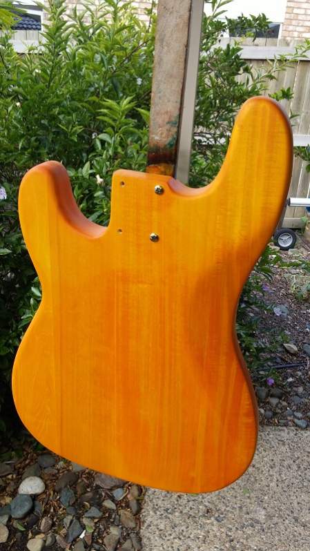

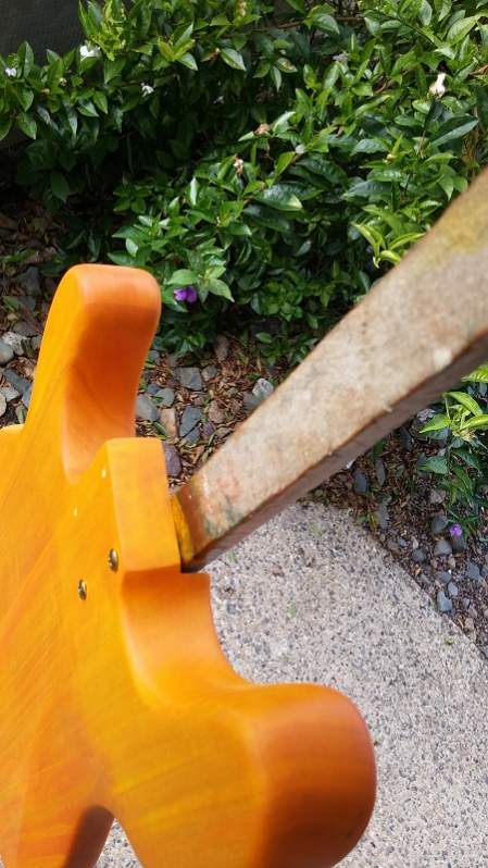

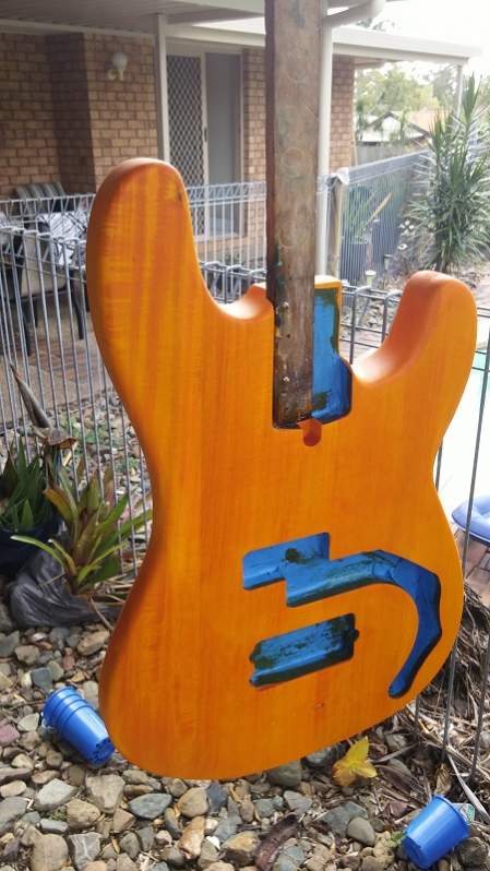

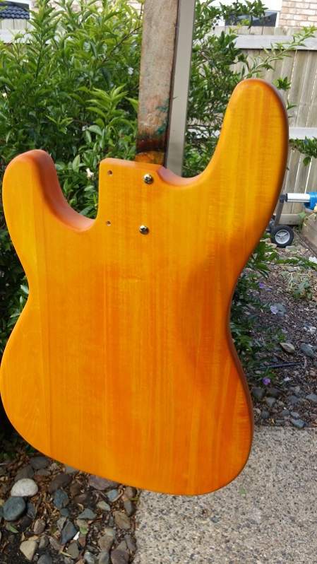

    Coolangatta Gold on the Body first time.
    I have done only one coat.....soaked up nearly half the bottle with just this session of covering....sort of went over the whole body a few times....but more spreading and evening the coat out than putting multiple layers on. Sanded to 400 grit the body is like a sponge.
    Hang now for five days.....
ID:	710   Click image for larger version.
ID:	711   Click image for larger version.

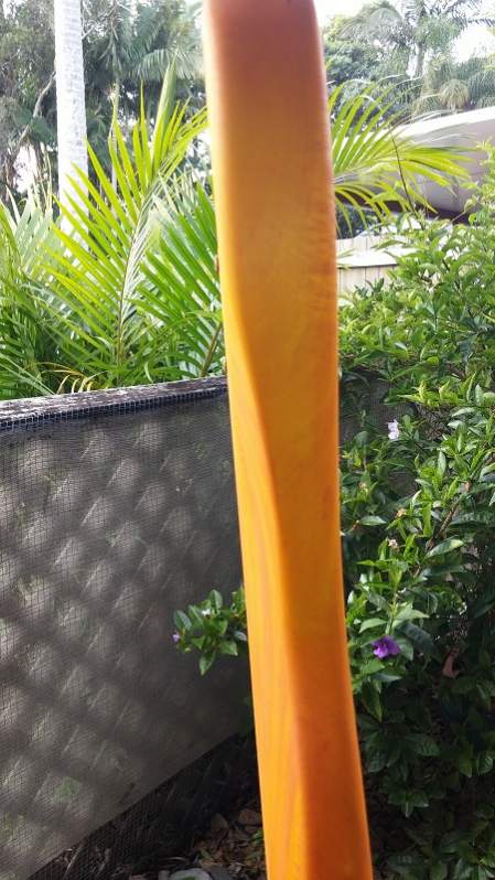

    Mentor ozzbike's Avatar
    Sunshine Coast, Queensland
    1,109

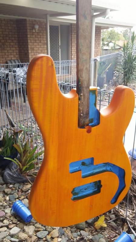

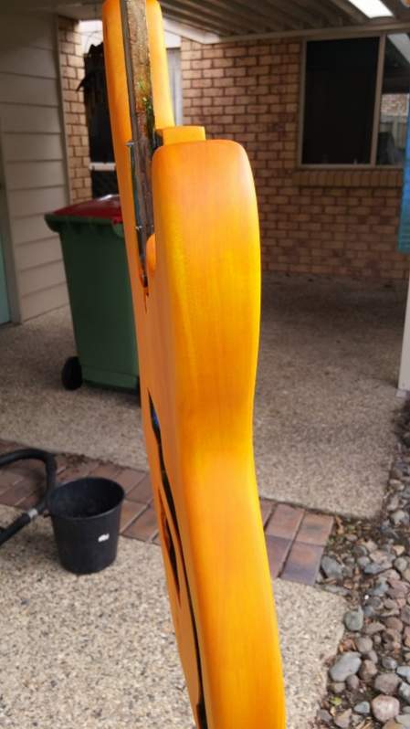

    Some more....wow
    More piccies.
ID:	713   Click image for larger version.
ID:	714   Click image for larger version.
    1,109
    Last One for Today
    I like this look....no sanding or machine marks in and around the neck pocket and the curly bits at the front.....sanding and more sanding.....love it....right of passage I do believe.
