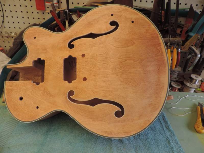

    Grain Sealed and Popped
    U used some Timbermate mixed with water and colour and applied this all over.
    Several hours of sanding and there is a grain pattern where before there was nothing to see.
    I've done a 1500 sand and applied a layer of tung oil to seal the grain ever further.
    The pattern does look nice enough to save but would need to be done witha tobacco burst or similar to hide the glue over run from the binding.
    easy way is to go ahead with solid white.
