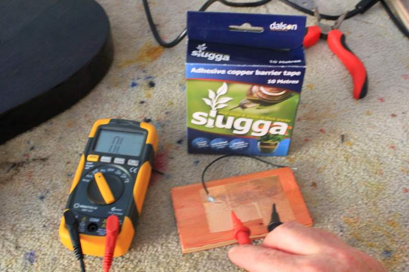

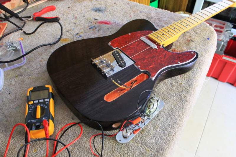

    Lightbulb Slug Barrier Shielding
    Ok, so I'm sure I read it here somewhere in the past. Who-ever posted it, I apologize that I cannot recall the source of the information. Anyway, I got tired of waiting for shielding tape to arrive in the mail and decided to try the slug barrier tape from Masters. The long and the short of it - it works amazingly well. Just like copper shielding tape with conductive adhesive. You can even solder on to it. Awesome.
    And so with my slug tape in hand I got all the shielding done today on the Tele, as well as soldering wires from the bridge to the bridge cavity wall, and thence to all the other cavity walls. With the shielding in and grounded, I proceeded to install my 4-way Oak-Grigsby switch and Bournes pots into the control plate. Everything is soldered up now waiting for the pickups to be attached to the switch and the output jack to its two little wires.
    That's tomorrow's job. Unfortunately now that the bridge is in it looks like the neck is going to need a shim. Bummer. Has anyone else found that with their Ash Tele kit?? Maybe I should lower the nut first?

    nice one Gav with the Slugga shielding, I found it online https://www.masters.com.au/product/9...rrier-tape-10m

    I use that slug tape. Very cost effective. Shimming a bolt on neck is easy, Gav, had to do it with both of the tele kits I've done.
  5. #55
    I used slug tape from B****gs on my guitar. The only difference I can see between it and the expensive guitar shielding tape is that slug tape is a bit thicker and less likely to tear (and significantly cheaper).

    Thanks @Andrew, @Wokka, @Pablo, @Fretty and @Wierdy for the positive comments. Great to know I'm not alone on the Slugga front. After shielding the TLA and soldering with abandon, I reckon it's awesome stuff and very cost effective. I'll be using it on all my builds from now on. Definitely give it a go Wokka! I find that when you are already a permanent resident of the naughty room, it's great to take any opportunity to wind DB up :P.

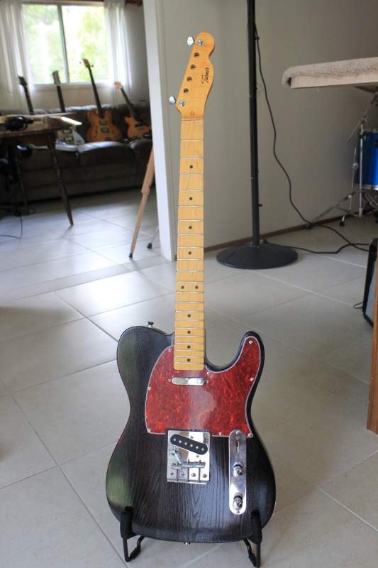

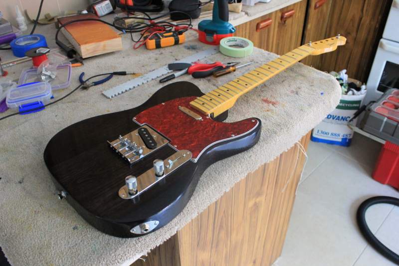

    hi guys,
    A little more progress today. I got the wiring completed and in. There were a few tense moments until I realised the 4-way switch was earthing out on the shielding. A piece of milk bottle placed in the bottom of the cavity sorted that out. I finally got the output jack plate screwed on and she makes noise!
    I also managed to get the frets levelled and re-crowned, so the only thing left to do now is to file a new (bone) nut and worry about the neck angle. I reckon she'll be done and twanging early next week!
