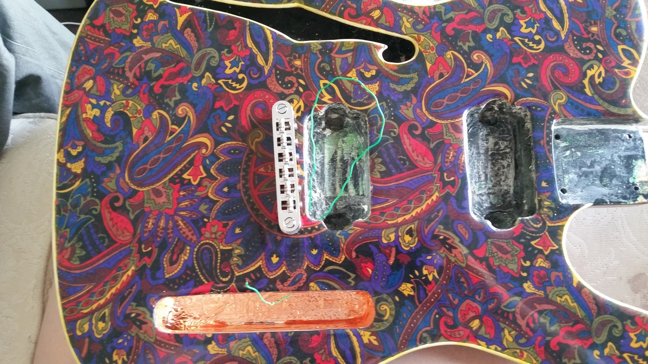

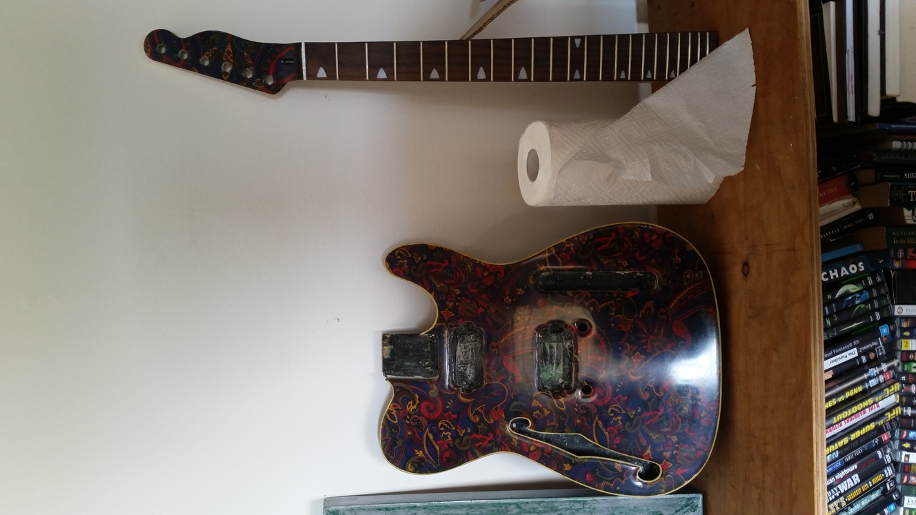

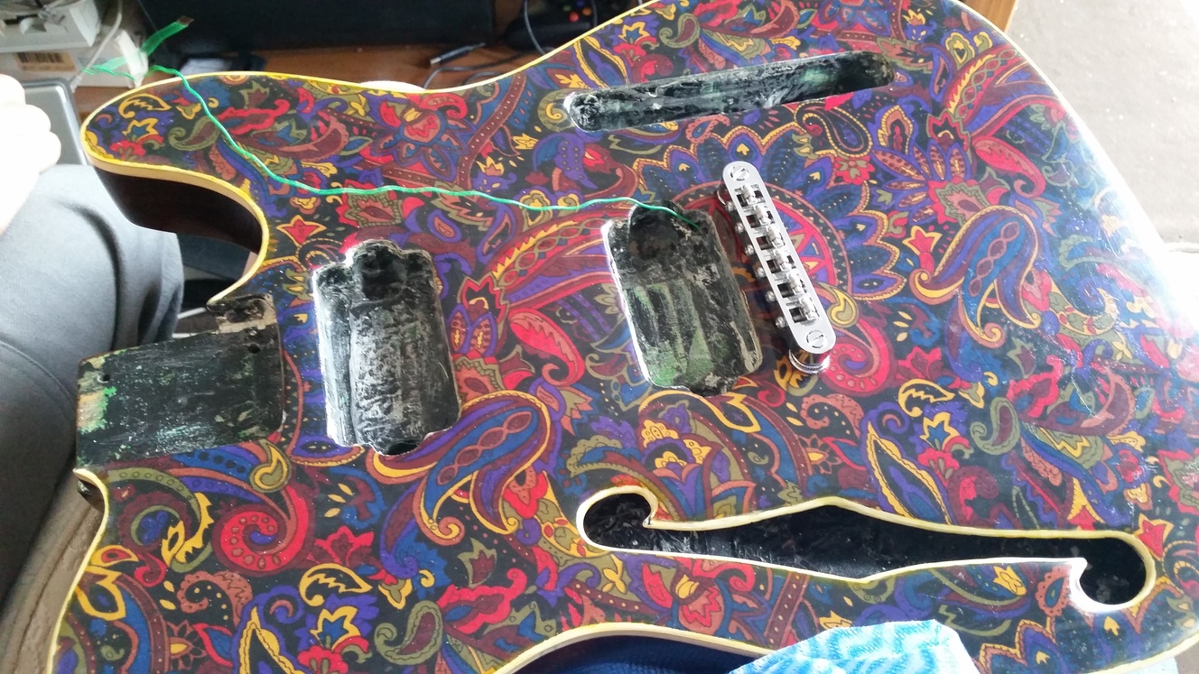

    All one piece.
    Used Brasso and the silvo for polishing to a high shine, then paste wax and buffing. More buffing and a final spritz when it's all assembled. One sad thing is that the holes were not drilled quite right at the factory..
