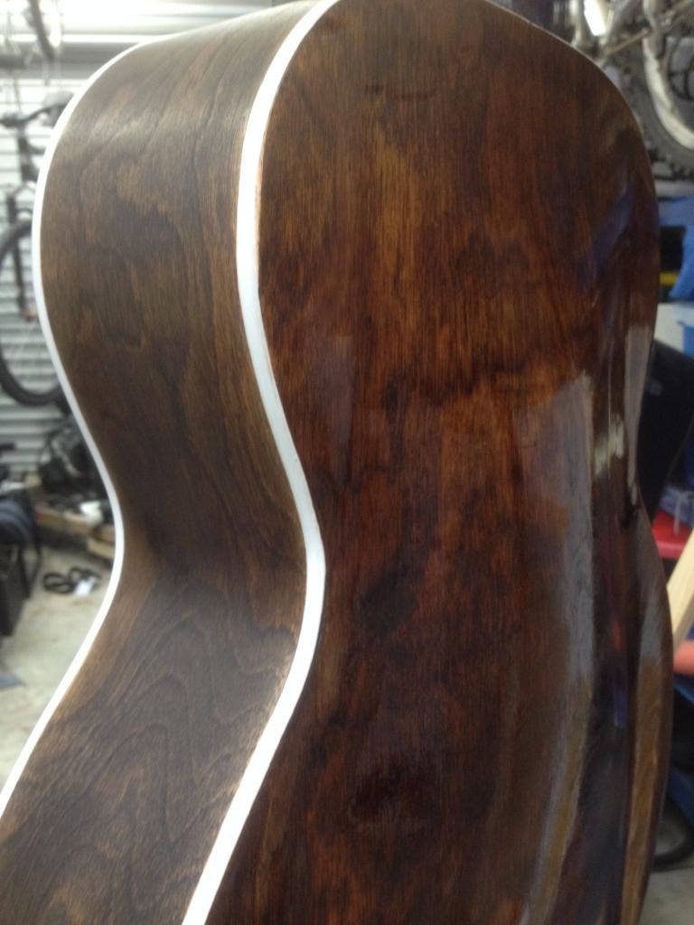

coming along nicely Stan, clear coats on should bring out the grain more
Stan's LP Build for my Sister: http://www.buildyourownguitar.com.au...ead.php?t=3146
Benson Pickup Strat mod: http://www.buildyourownguitar.com.au...ead.php?t=5229
Epiphone LP headstock fix: http://www.buildyourownguitar.com.au...ead.php?t=3410
Martin Backpacker Repair: http://www.buildyourownguitar.com.au...?t=5038&page=3
'57 Harmony Jazz guitar project: http://www.buildyourownguitar.com.au...ead.php?t=2972
is that clear applied with a spray gun or can spray Stan ? looking very shiny !
Spray can. Very shiney, but wet, first few coats will be a bit matte, then they will gloss up as they build, dry timber soaks up a bit

Looking great Stan! Keep up the good work. Can't wait to see her finished.
I am a bit towards looking after old stuff as it was, But sometimes you have to be bold in order to repair the ravages of time. The body looks georgeous with all it's clothes stripped off. I think you made the right decision to strip her back. I guess I know whoi will be the first to make use of my new slotted straight edge and fret rocker. Not to mention AJ's radius block.![]()

Thanks Paul, believe me , I didn't treat it lightly sanding away an original finish, and some will disagree. That's fine, but I like it.
Looking back, A bridge mount would have been a good idea, or one of those pickgaurd mount ones.
The internals are a simple pair of parallel rails down the body, same as this:
My plan is to make a small box shape that will go through the pickup hole an glue to the inside of the top plate, to mount the pickup in. Hopefully no having to cut the rails at all and therefore not decreasing any strength...
And yes mate, at a later date, might hit you up to borrow some tools and AJs block...
