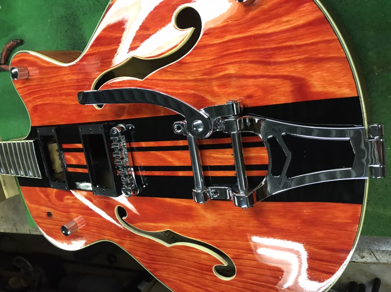

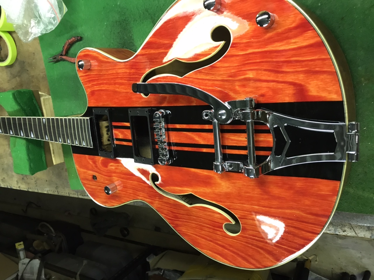

    With the rain and generally crappy day in Brisbane I could no longer resist. Had to have a look and see how it might come up.....Click image for larger version.
ID:	39963Click image for larger version.
    Think I am gonna be reasonably happy with the look of it!!

    That looks great. Well done.
