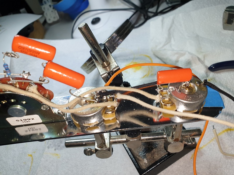

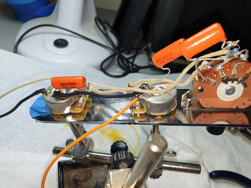

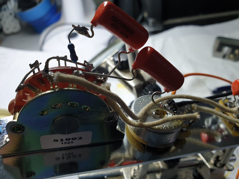

    Jaycar visit done, Real Parts delivery in the house. I have the "Esquire" style wiring harness completed. Just the pickup and output jack to go in once the body is ready.
    Lots of caps everywhere....and one tiny little resistor.
    Oak Grigsby 3 position switch.
    Jack plate with Amercian holes to fit Oak Grigsby switch and USA pots.
    2 x CTS 250K A log pots.
    3 x 0.047 Sprague orange drop capacitors.
    1 x metal film 3.3k resistor.
    Vintage push back wire used to connect things...plus a few cap/resistor cut off leads.
    One length of soft plastic multi core wire for Bridge ground wire.
    One trial fitting and the full sized pots are a little wide for the body rout. They fit but tight.
    I think I will wait until the body is completely done...mark out the cover plate mounting points and dremel a couple of curves in either side to accomodate them.
    Hanging and drying and waiting time now....hummmmmm.

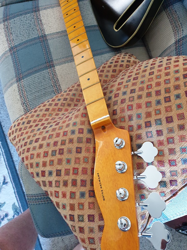

    The neck is done. It is very shiny....has been waxed and feels so smooth.
    Yesterday, before my return to work, I finally managed to get a good finish on the body.....well for me.
    I will let it hang for at least two weeks now....then tape up hard edges....1200, 1500, 2000, then the foam pad wet sanding....then compound, and finer stuff and then wax.
    This build has been a task.
    I do think I am better at oiled and wax finishes.
    It is a learning process I suppose.

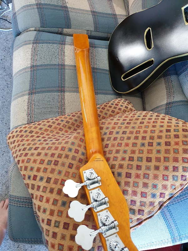

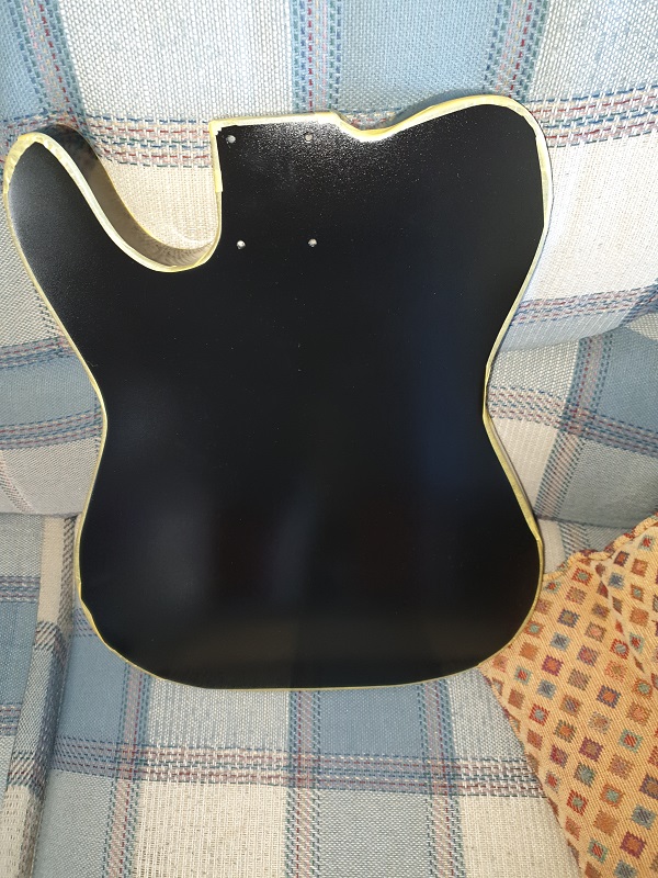

    Neck is done and bodyready for wet sand.
    This has been a long journey...for me...but I think I have an even place from which to start on the final finishing of the body.
    The spray poly is a great...really quick...finish for necks. The neck is done.

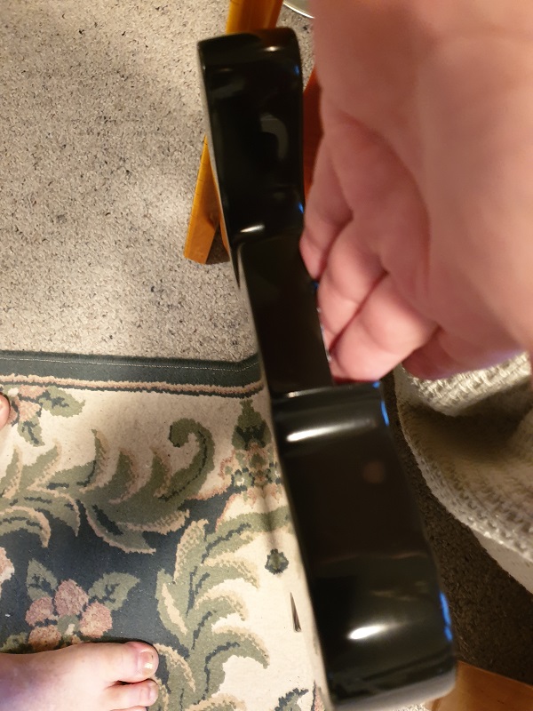

    The body is done....now to fit it out.
    Finishing is done...I am amazed as to how shiny it is.....all done by hand.
