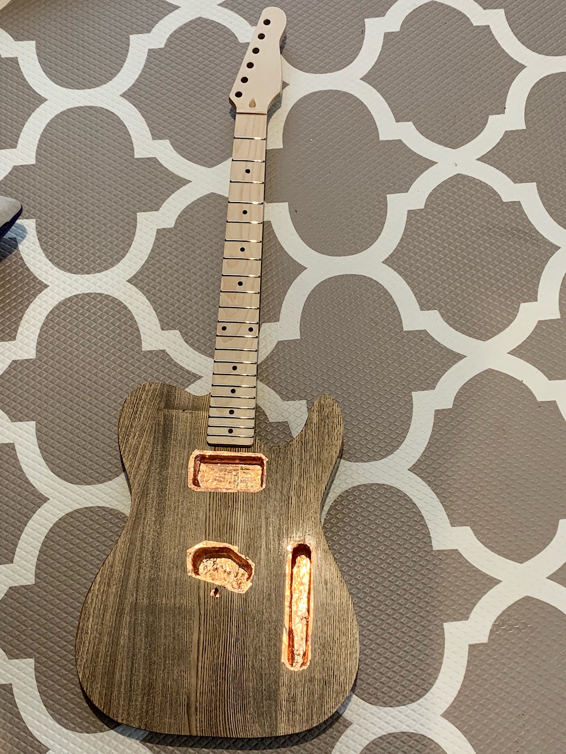

    Hi All,
    So after letting my poly cure, I decided to have a go at finishing the guitar body. Basic method was to level sand the last coat with 600 grit and then give it a sand at 800, 1000, 1200 and 1500 for a smooth level finish. As I want this guitar to look a little more “weathered” look I finish off with 0000 steel wool and some finishing wax for a satin finish on the body.
    Next step was copper shield the guitar to limit the buzz as much as possible once it is all complete. I got some copper shielding tape from Pitbull, however, was well short of being able to complete my guitar. Credit to Adam as I emailed him to explain this and he said he would send me out some additional tape. As I was impatient and also need to solder the electrical stuff, I decided to get some from the local hardware store and finish off the guitar. I ensured that I soldered the connecting/overlapping pieces for copper tape, where I was short from the other tape. I check for continuity across all aspects of the guitar and it seems to have worked.
    Next step is to bolt the neck into place - starting to think about final build steps and putting in the hard wear. As I am so new to guitar I have so many questions about step up etc but will post once I need advice in this area.

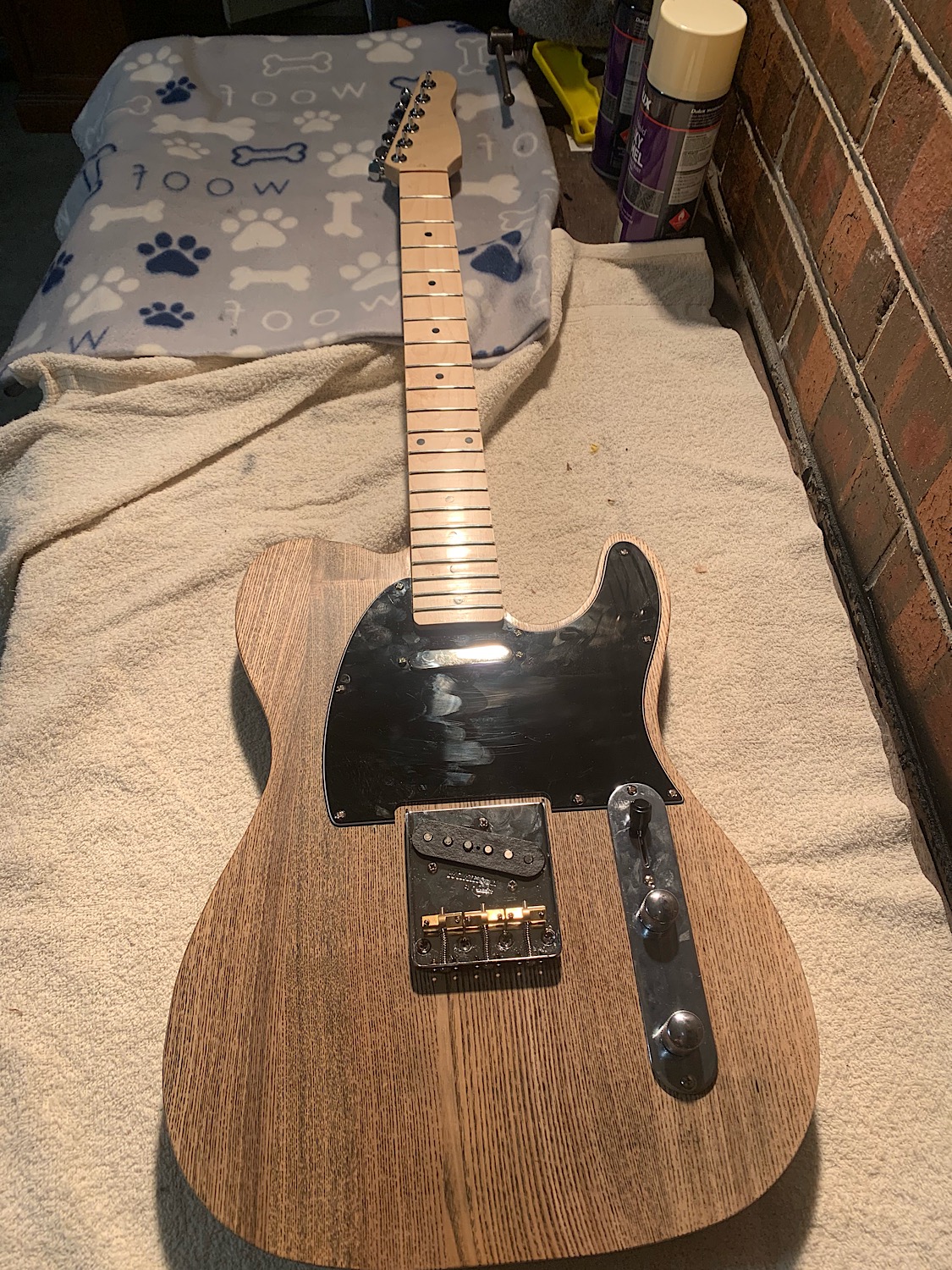

    Hi All,
    Over the weekend I am looking to screw in the neck and install bridge and glue in the nut. I am looking for some advice to get the action of the guitar right or as right as possible. As stated early on I really have no experience with guitars (playing or building) so this seems to be a trick part for me.
    Looking for simple ways to ensure that I basically don’t stuff this up. I did buy the putbull radius gauge if that helps. So looking for some easy tips, tricks or hacks that will make my life as easy as possible
  7. #47
    Jun 2019
    156
    Hi All,
    Had a few hours to myself away from the family and decided to work on the guitar. Today was one of the biggest days in regards to the build for me. I started off by screwing in the neck - this seemed to go okay.
    I then remarked out all the measurements in order to install the bridge and also have correct intonation. I am not sure if I measured correctly the first time but it seemed to be off by about 1.5mm. I simply moved the saddles forward a little so hopefully I have enough travel in order correctly intonate when I string up. It was only marginally off my original measurements but a pain.
    I then fitter the pickups to the bridge and the pick guard and soldered everything together. This seemed to be much easier then I expected as most of the work was pre done. Some trouble shooting along the way as my output jack hot wire was grounding out but managed to locate the issue and fix this. Did a tap test of the pickups and the 3 way switch and all seems to working as needed.
    If I have time tomorrow I will install the after market nut and if possible string up and do a set up. Still not 100% sure regarding the string height, action etc but I am moving along and working towards figuring it out.
