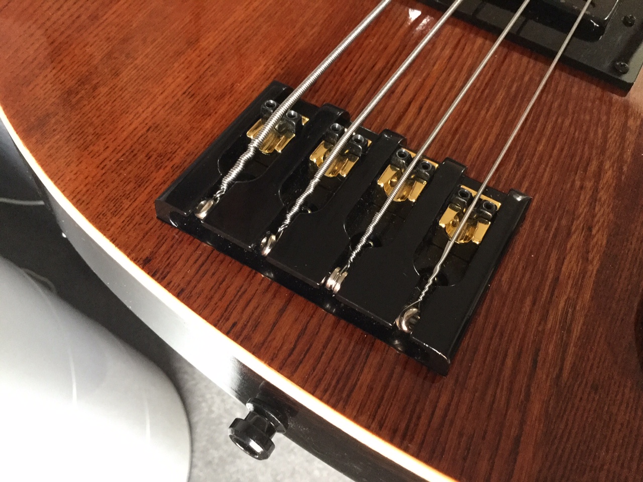

    I had to recess the bridge on my RCA4 kit due to the neck angle not being quite right. The way I did it was I drew around the bridge with a scalpel, cutting the varnish and stained finish. I then taped with masking tape exactly on this line and used a sharp chisel and mallet to cut into the timber along this line, particularly when I was going across the grain. I then used my Bunnings cheap router to cut out the centre, getting within a mm or so of the outer ends. Making the edge perfect was easy with the chisel. I can't see why this wouldn't work for the pickup also.

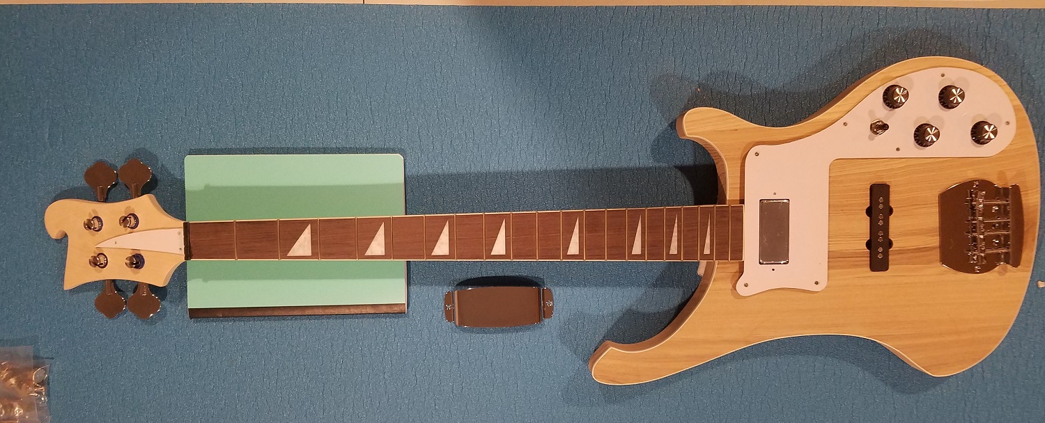

    Some progress.
    Well.. no significant progress, but then, some. Got the MusicMan route done. While waiting, borrowed the bossman's Ryobi band saw and made some templates. My idea needed a neck pickup ring to cover the neck pup route, between my plexi template along with the PBG supplied Black ring, I can express what I need to my metal fab buddy. I made my pickguard idea on a rainy Nashville weekend. I went ahead and made three sets while I had use of the band saw. What's cool with the Plexi, I can see into the control cavity to see where she lies, and what I may need to make adjustments.

    More steps.
    Along with template making, I been playing with a piece of Ash, attempting a Seafoam Green Transparent Finish. This is too blue, too much white and too many applications, but a step to where I want to go.
