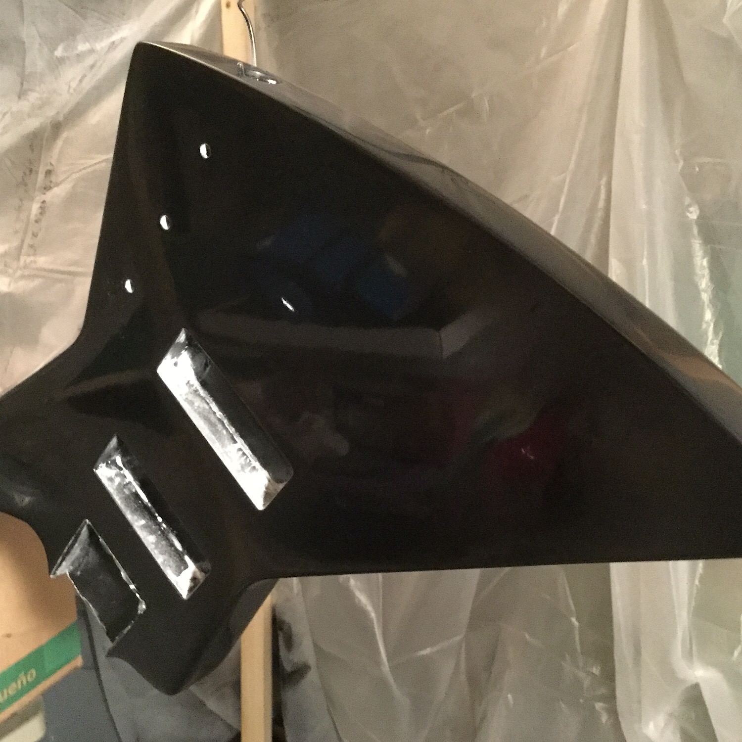

    There’s Hope!
    Well, well...I am learning. I’d intended to do a gloss body and satin neck. I couldn’t get the gloss body to look good so I tried a couple of satin color coats and numerous satin clear coats. It looked horrible! Just came out of the can bad.
    I let it cure and wet sanded with 1000, 1200, 1500, 2000 grit paper. Feeling discouraged, I continued with medium Stew Mac rubbing compound. Ok...now we’re getting somewhere. I don’t own a polishing wheel, but I can do it by hand. I’m back to my gloss body idea now. Gloss body, satin neck, gloss peg head. I’ll keep ya posted!

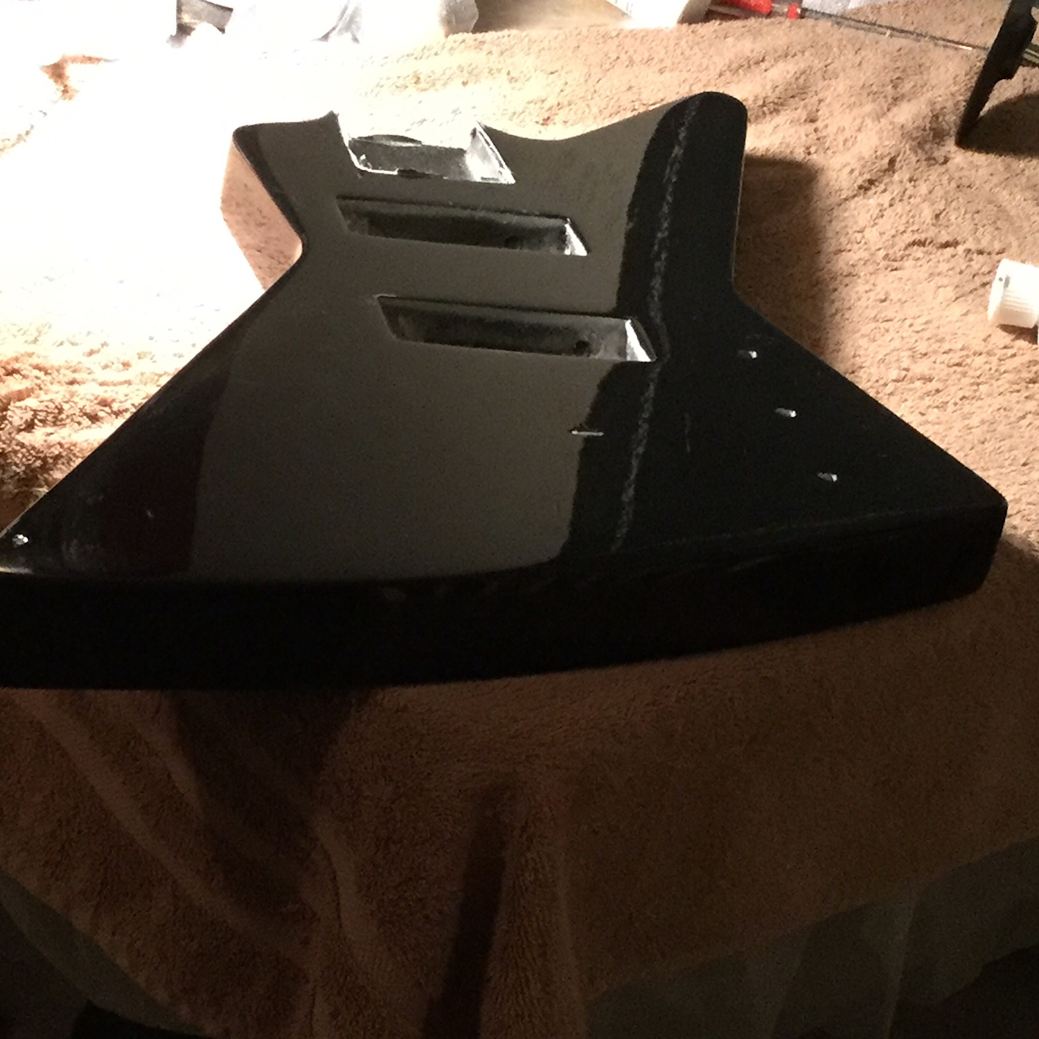

    Electric buffing wheel
    After using an electric buffing wheel...huh...why didn’t I buy one of those before?
    That freaking chip on the right lower horn sticks out like a sore thumb and excludes this one from making GOTM, but at this point I just want to COMPLETE THIS PROJECT, lol!!!!
    The paint is the lousiest Ace hardware store satin black. Buffed to an unexpected shine. On most finishes, you can clean and degrease with naphtha. If I do that to this thing, the paint comes off!
