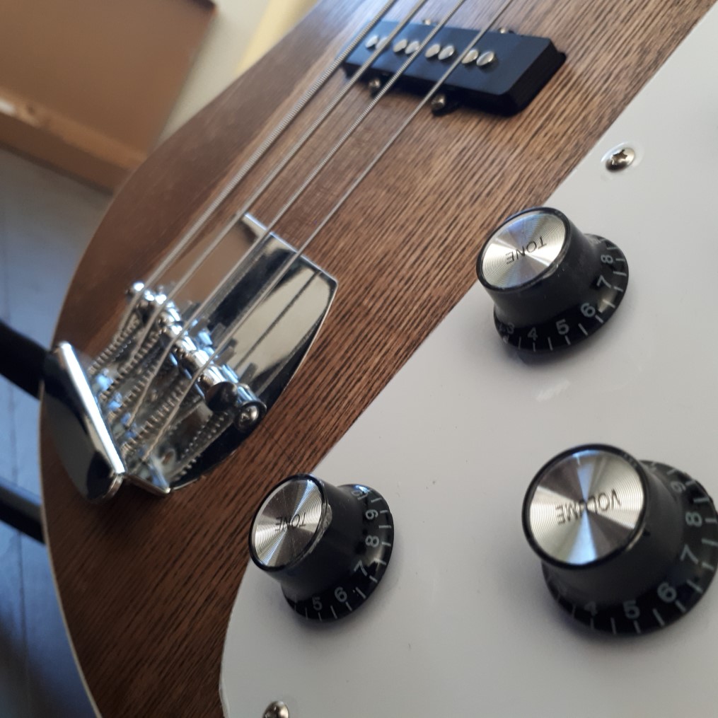

    I am am new here and I was advised to add my ready bass guitar RCA to the forum for a Guitar of the month.
    Please find below some pictures. Hope I have attached it properly ?!

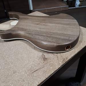

    picture 2

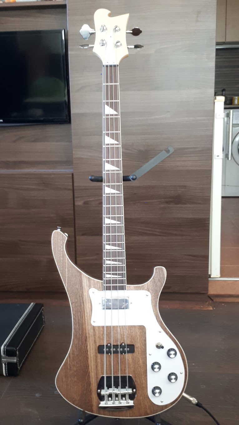

    picture 3Click image for larger version.

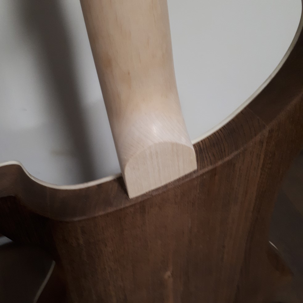

ID:	28219 picture 4

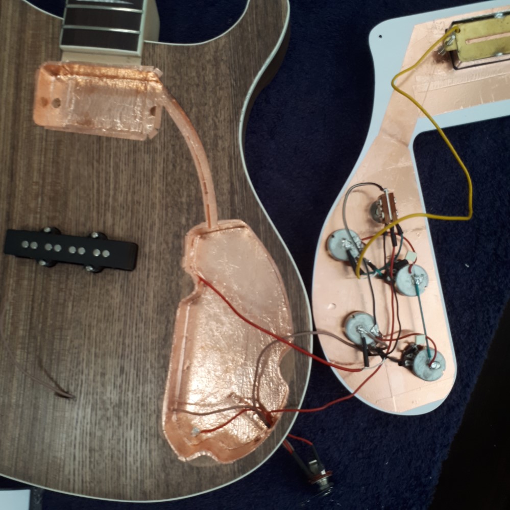

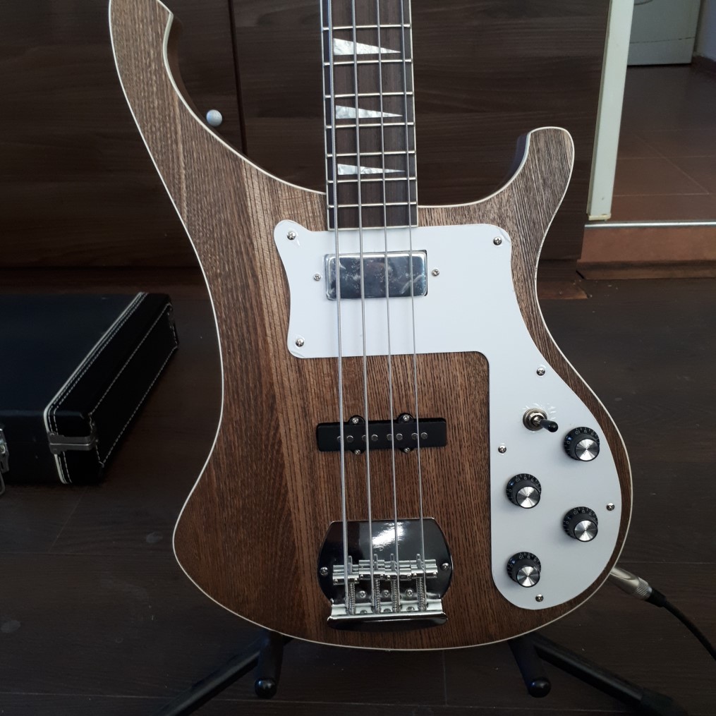

    picture 6Click image for larger version.

    Wow, the four stringed big brother of the Black Wolf.

    PS: Sorry, I have read the rules and seems I have missed to describe something regarding the instrument building :
    1. Sanding - sanding grid of all parts above 320 always and up to 1500 grid at the active part of the neck + satin finish
    2. Machines - no any machines involved. Everything is crafted except...
    3. Removal of the veneer on the back side - hot gun in help was involved
    4. Surface finish - environmental friendly oil + wax ( two layers - color and transparent )
    5. Tailpiece/bridge - inserted in the body and leveled to the top surface of the instrument
    6. Hardware and electronics - all parts are as they come with the kit except of the 3-way toggle switch and the pots ( 500 K each )
    I will change the tone pots to logarithmic ones.
