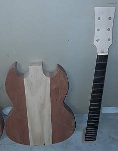

    Thanks guys i think i,ll glue it on first, Click image for larger version.
ID:	28694 i got the lefty wefty for my mate shaped up as wel

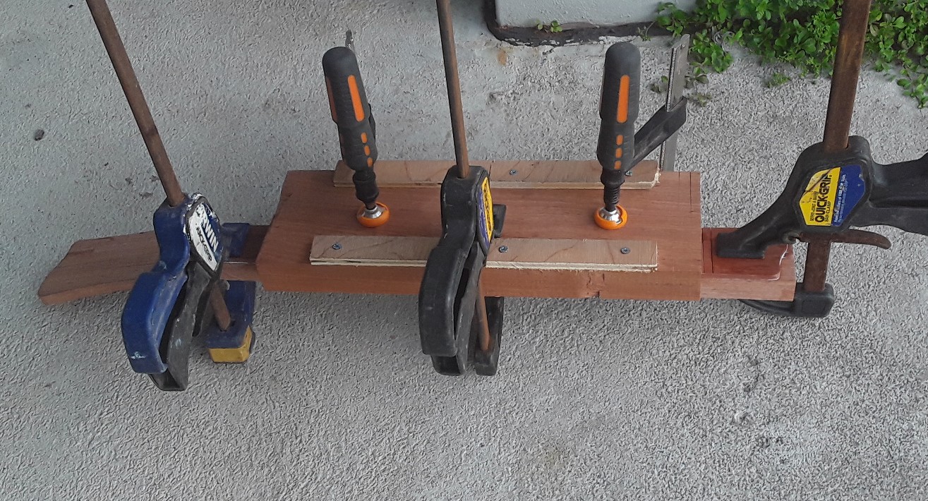

ID:	28771 fingers crossed
  4. #44
    5,666
    Quote Originally Posted by Adam Barnes View Post
    Good even clamp spacing, you should be sweet.

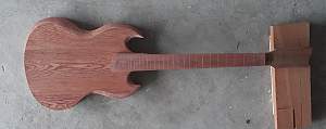

    Thanks all good lots of shaping to do nowClick image for larger version.
ID:	28800 shaping a lot quicker than i thought the wood file works a treat

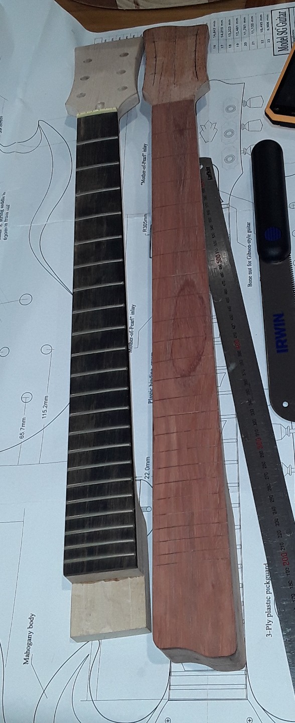

ID:	28850ive been comparing my scratch neck with the PB neck for the lefty wefty. The scratchy is coming up better than i thought it would ive got 314 to The 12th fret so a scale lenght of 628, al looks good. The PB neck is 317 to the 12th fret with the frets all slowly getting longer, at the 22nd its half a fret longer, if i put the bridge at 634 will that work, its like the scale lenght is completely different.
