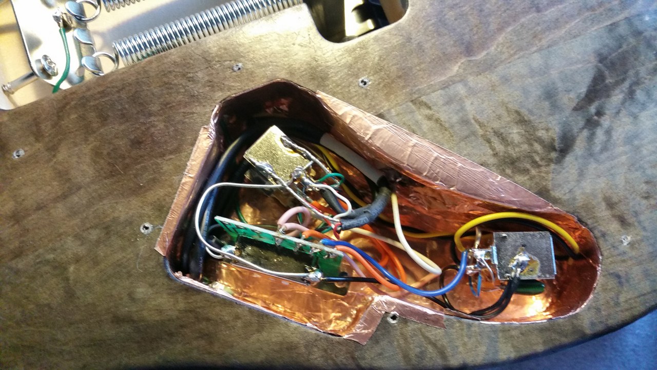

    Sorted the wiring... Standard 5 way switching for a HSH, plus on the volume pot there is SC/HB switching for both HB, and on the tone pot a phase reversal switch for the middle PU.... By my calculations there is 13 PU combinations.... Took quite a bit of additional figuring out to get noise cancelling on all the combinations that used the SC, but I got there...

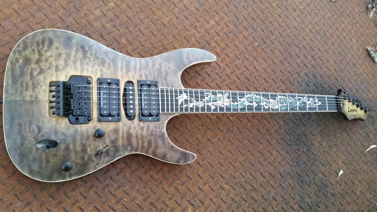

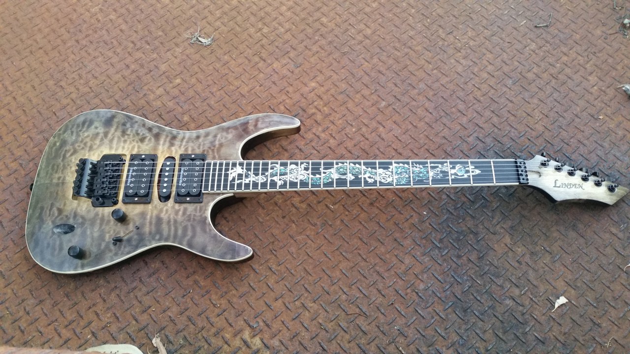

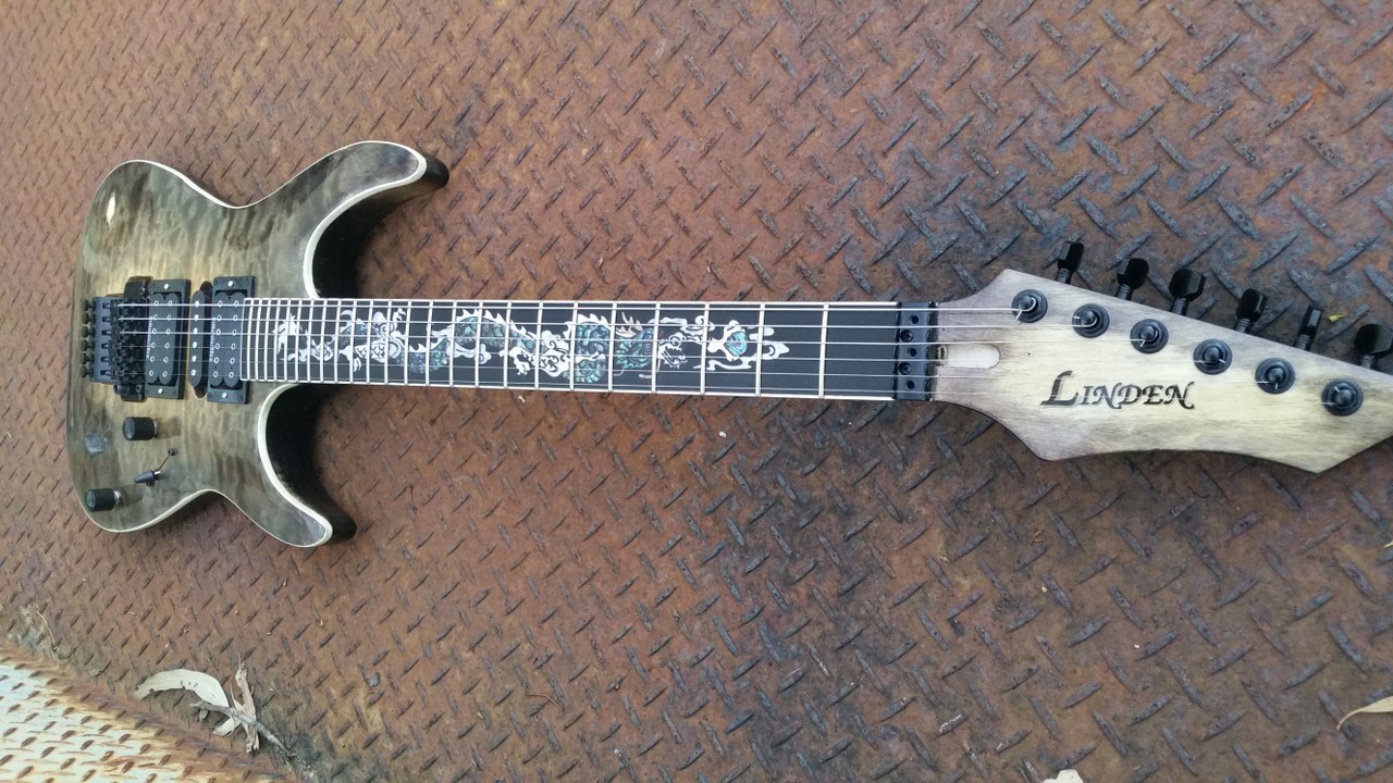

    Included some natural light photos for your enjoyment.... ;-)

  4. #44
    Looks like a classic 80's shredder.
  5. #45
    Gee that felt like a quick build - its come up a treat.
  6. #46
    I love this thing! Great job
  7. #47
    Nice job Marcel
