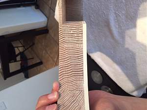

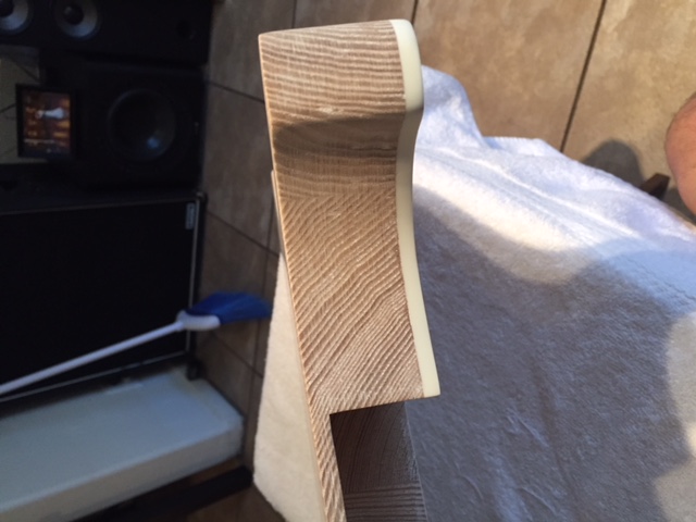

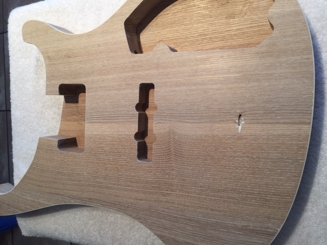

    Well after the third round it's looking real good. There are only a few small areas on the sides that need some filling but sanding with 320 was a good idea. My only concern now is the clear finish I planned on doing may have to become something else because the filler is pretty light compared to the ash. I'm not sure how clear poly would look over it.

    Damp it down with turps or metho as that gives you an idea how it could look under a clear finish.
