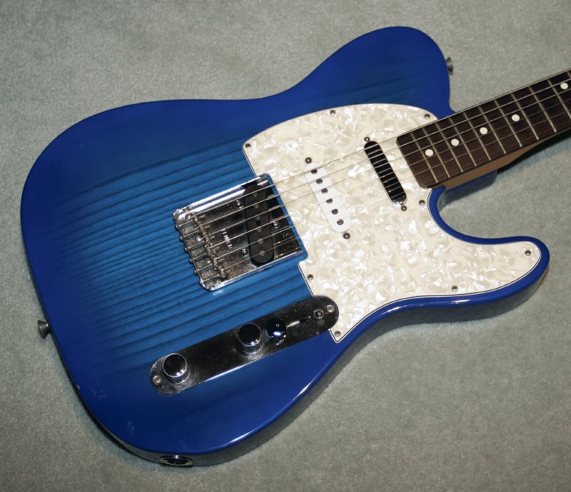

    Yeh, okay, mine could be the better one. They didn't use Timbermate. LOL
