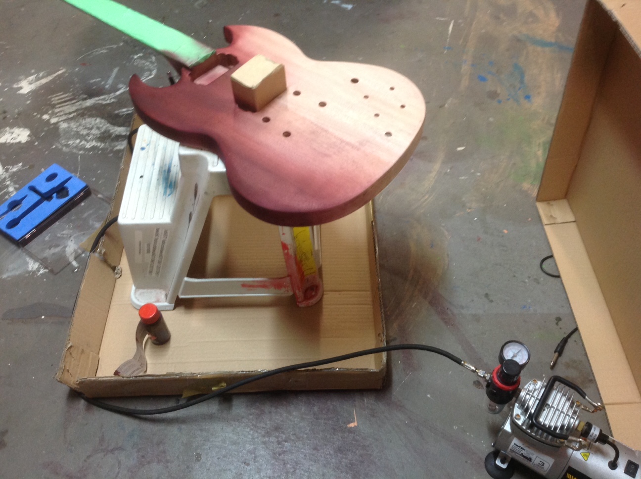

    Ok so the horrid sanding is done, and my trusty Aldi airbrush has come to the rescue. The colour is now nice and even, but indeed it is a little too brown, but I'm not complaining compared with what it was!
    The real ones seem to come in a variety of red to brown colours anyway, and I'm anticipating the clear coat will change the colour again, making it less opaque as it seems to.
    Anyway, a successful evening's work!
