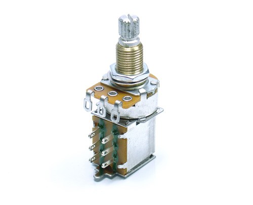

    Hi Brendan, thought it might be easier to answer some of your questions here within your build.....
    This is the hyperlink to how to wire up coil splitting for the stock soapbar humbuckers that come with this kit - http://www.buildyourownguitar.com.au...ead.php?t=6476
ID:	26854 $8.50 each at Real Parts and come in 500KA or 500KB - https://www.realparts.com.au/electro...pull-pots.html

    All up, approx $50 - $60 incl around $10 for postage.
    I have used all these parts, except for Alpha pots as I used the slightly more expensive Bourns ones @ $12.00 each and they look very similar.
    Cheers, Waz
    Cheers, Waz
    Thanks Waz, your a legend, that looks pretty much like the shopping list I had from your earlier description. That wiring diagram certainly helps. Down the track I'll look at either the Toneriders or those Bullbuckers for the 6 string.
    I am so impressed by this forum as a whole and the lengths forumites will go to help others out, it is rare to find nowadays. I owe you some beers Waz, is xxxx on special?

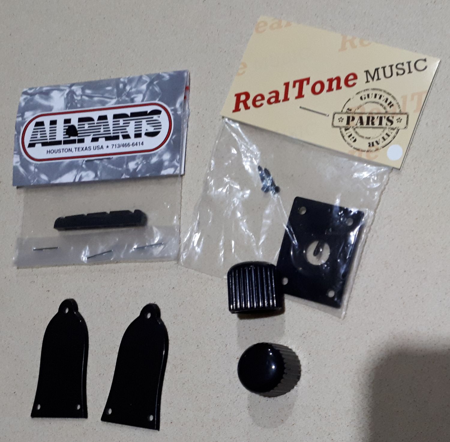

    Just dug out some black spare bits that I won't need and yours if you want them.....supposed to be a Graphite 4 string Bass Nut but from underneath it still looks like black plastic, couple of plastic black control knobs, black square LP style jack plate, and I ordered a one ply bell shaped truss rod cover and 5 arrived in the mail from a Chinese eBay store??? You can have a couple of them too if you like.
Name:	Black Parts.jpg
    Cheers, Waz
