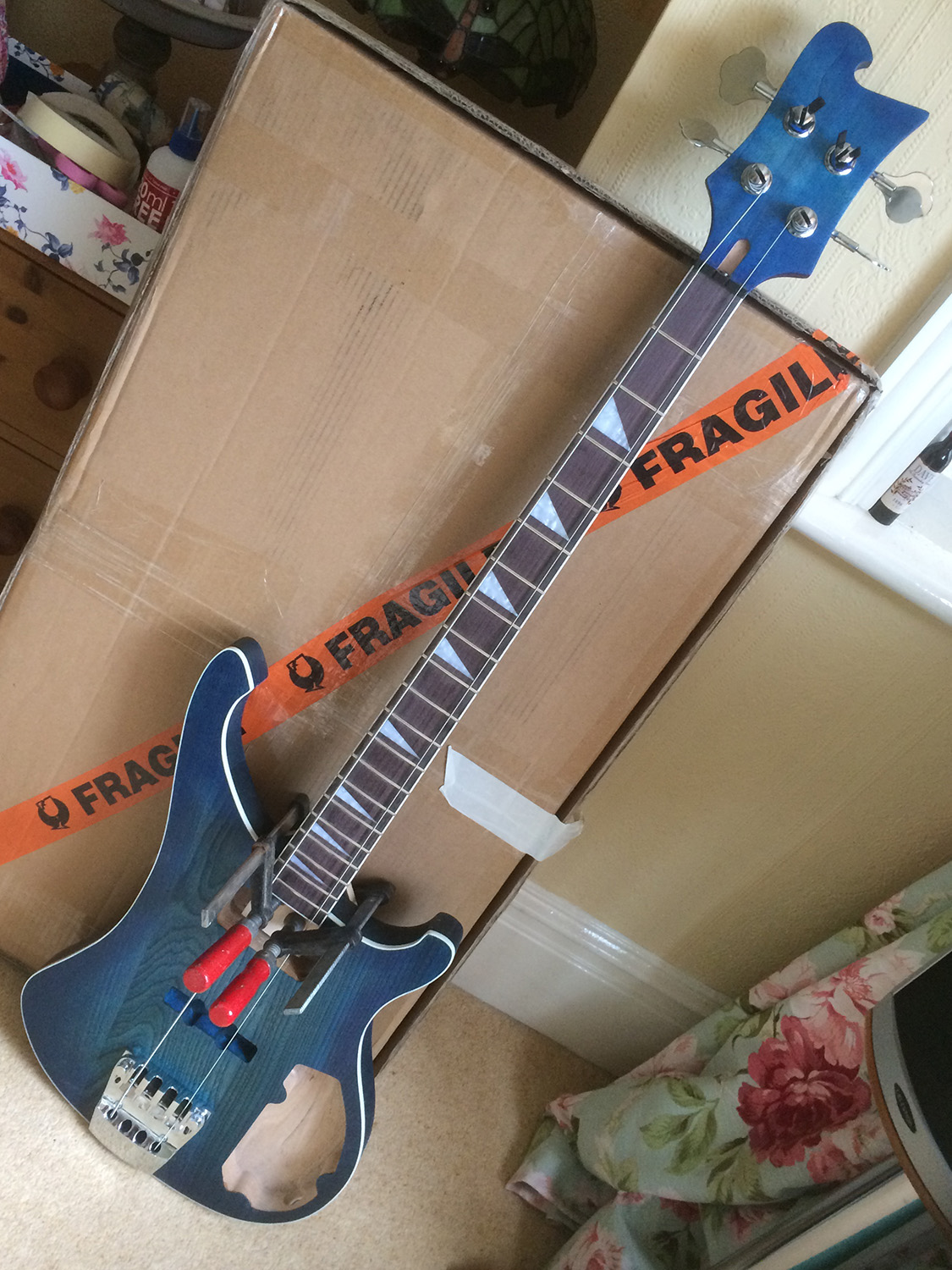

    been a bit busy recently but the main hold up is my umming and ahhing as to whether I need to shim the neck pocket or not...? I kept putting off properly investigating by carrying on with the staining and oiling but decided that after 5-6 coats of oil that I'd glue in the neck before applying further coats of oil

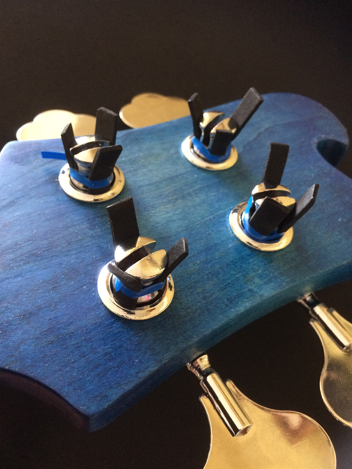

    So to do that I needed to use some proper strings which meant fitting the machine heads...

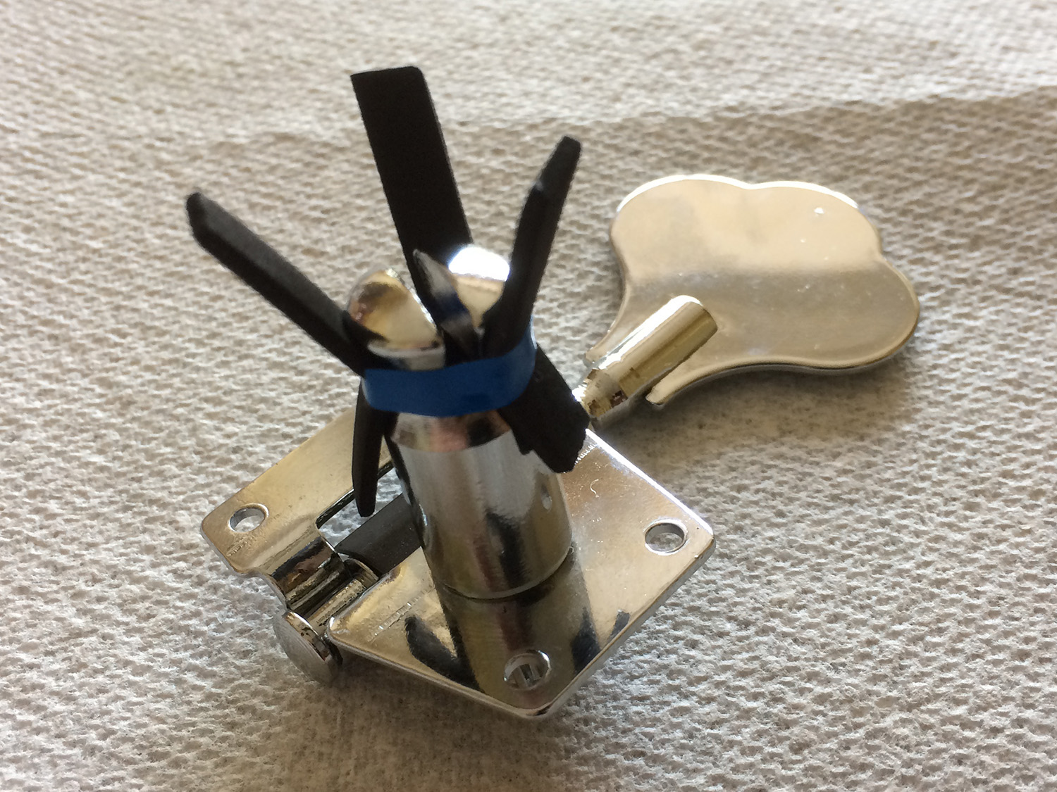

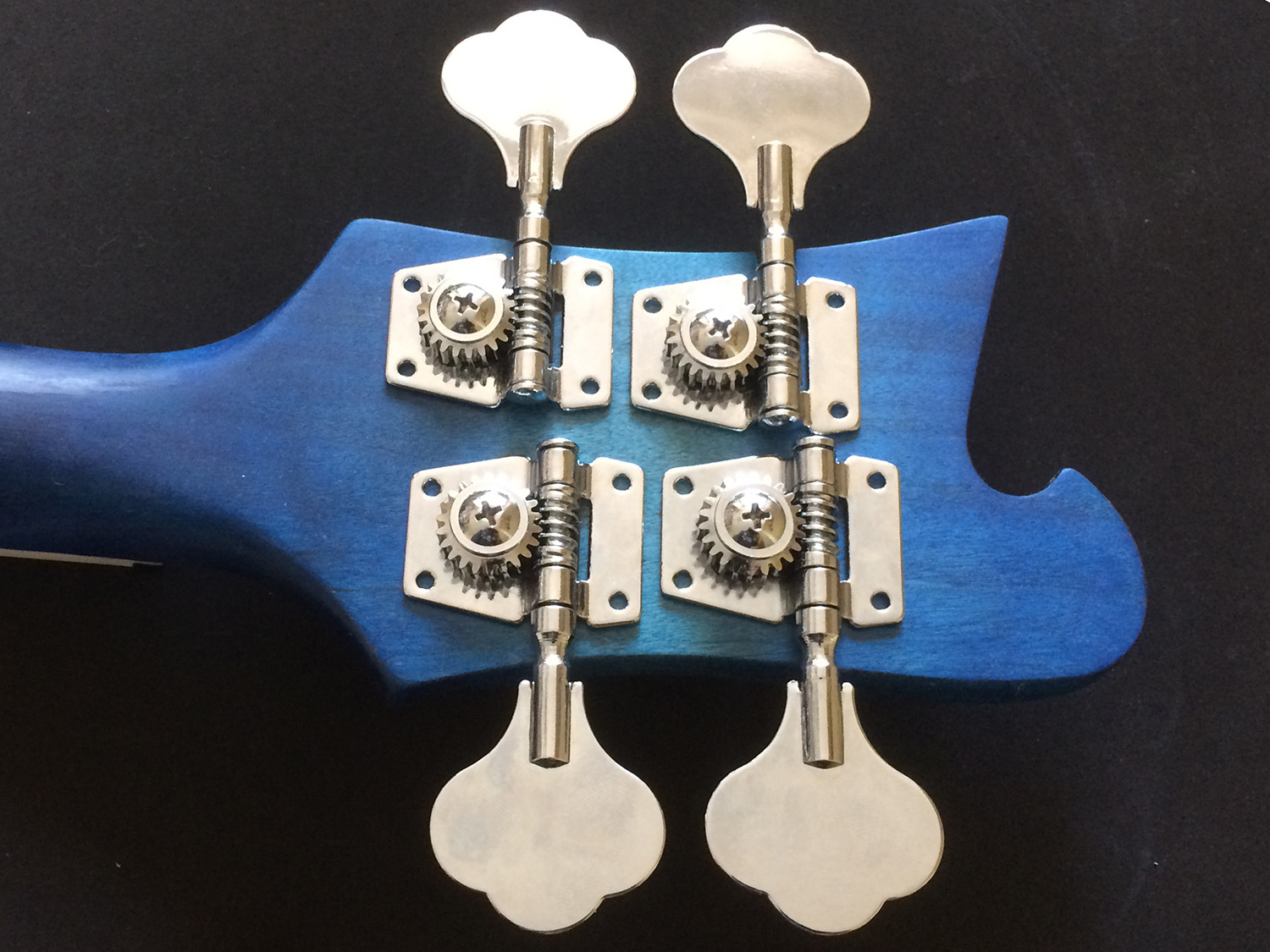

    At this point I realised that there is a bit of play between the ferrule and the tuning post so I taped three pieces of 1.75mm foam around each post so that I could centre each peg in each ferrule then line up the rear plates and handles to my satisfaction (I'm a bit fussy about things like that!)

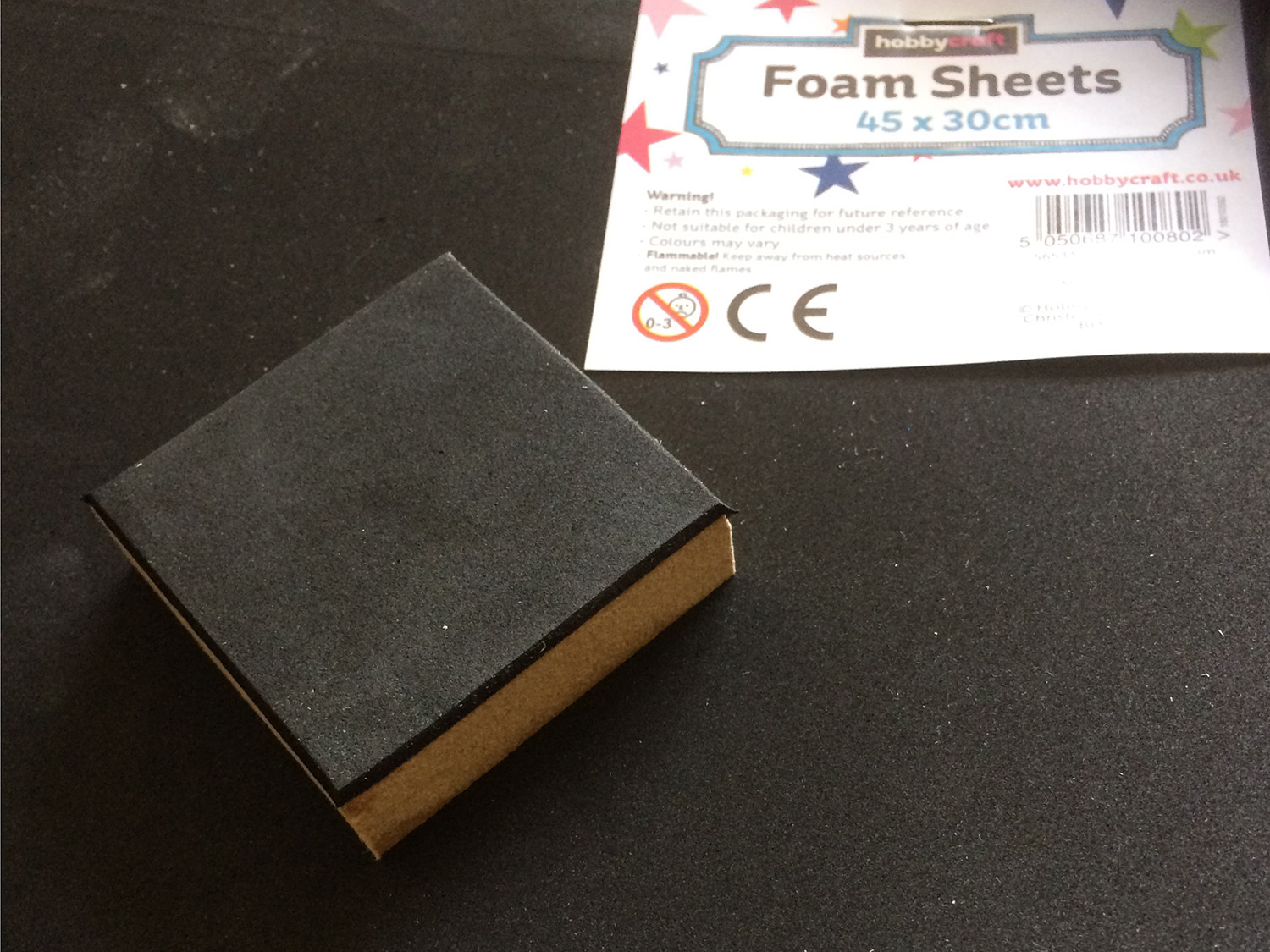

    Fortunately I'd previously bought the foam to make some soft pads to protect the finish whenever I needed to use clamps. (Here in the UK, Hobbycraft sell an A4 sheet for 50p or an A3 piece for £1 – I have no affiliation!!). I cut four 50mm squares and one 100mm square of 12mm mdf then used carpet double-sided tape to fix the foam then trimmed to size. They work a treat so hopefully others may find this a useful tip.!

    So with the posts nicely centered in the ferrules and all lined up I fitted a few screws to fix their final positions as I'll be removing them before the final finishing.

    Now with the neck clamped in place (34" nut to bridge saddles) I could at last put on a couple of strings...

    ooh – the sustain sounds pretty good! Now to check the string heights properly and decide if I needed to shim or not to shim...
