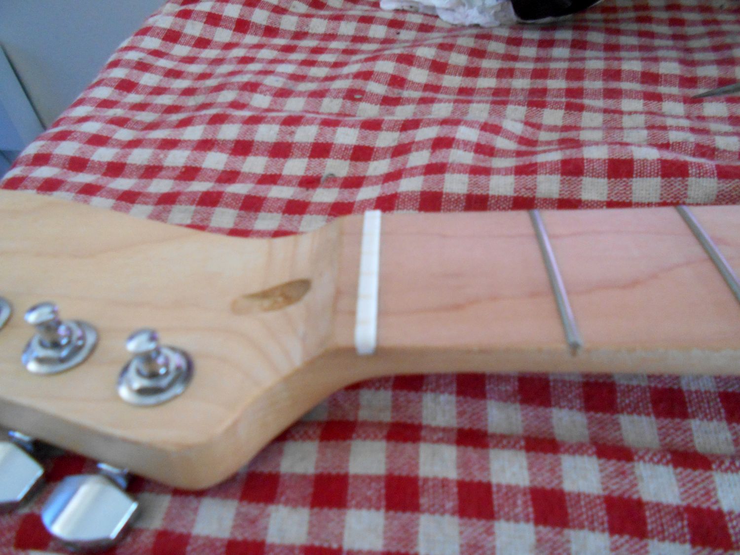

    I managed to get a new bone nut installed on my Andoer maple Telecaster neck, had to use a square needle file to deepen the existing nut trench a bit because the nut was sitting a bit too high, I used some PVA wood glue to glue the bone nut in place, the neck is all ready to be installed on the body, which is due to arrive in the post by March 6th, I'm hoping that I can finish building the custom Telecaster by April if nothing goes pear-shaped in the meantime.
    New bone nut installed:

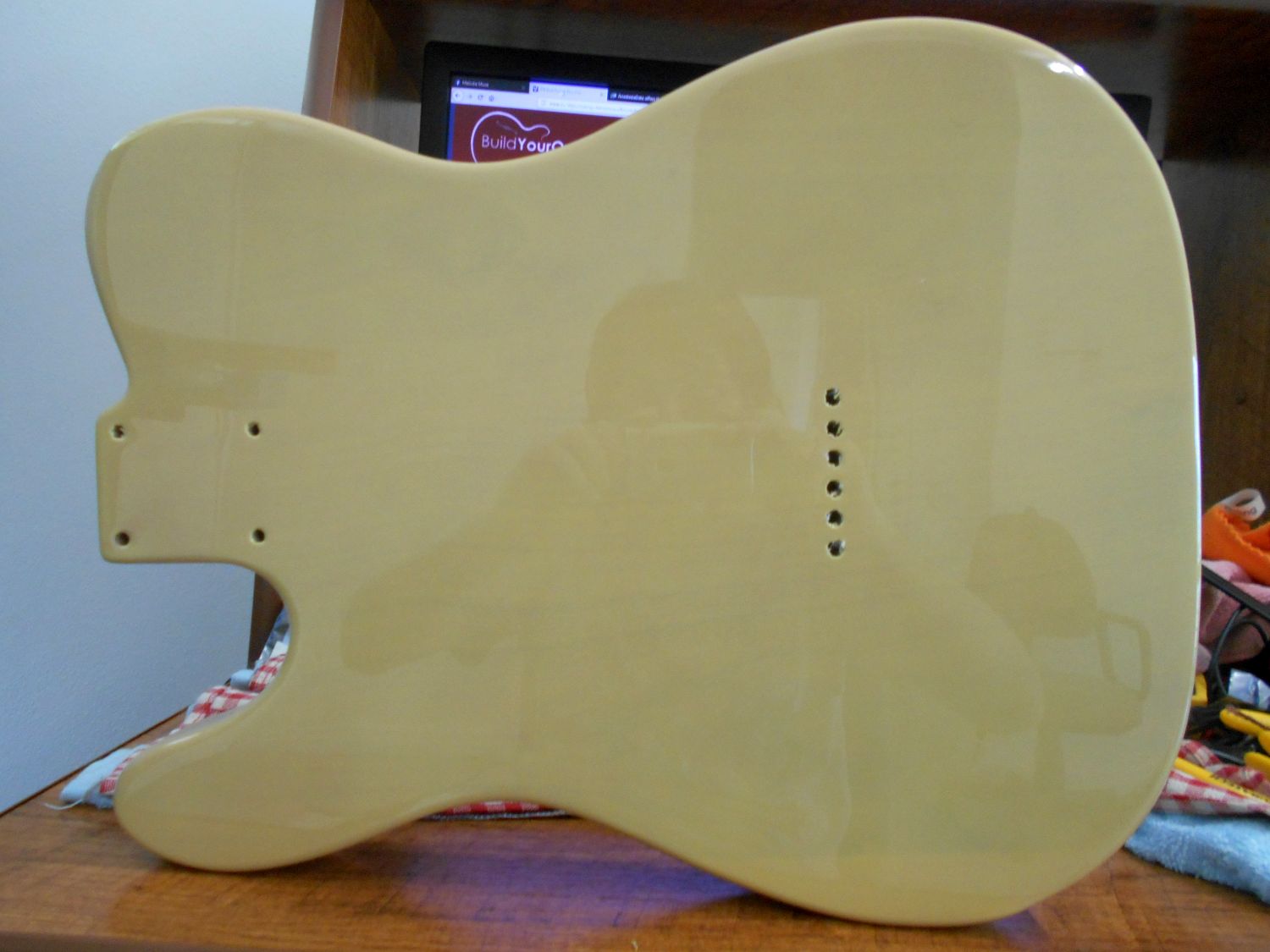

    It's finally here!!!!.....YAY!!!

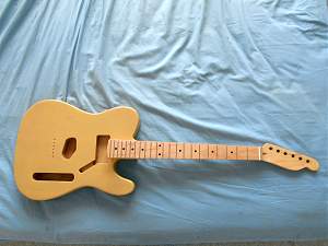

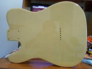

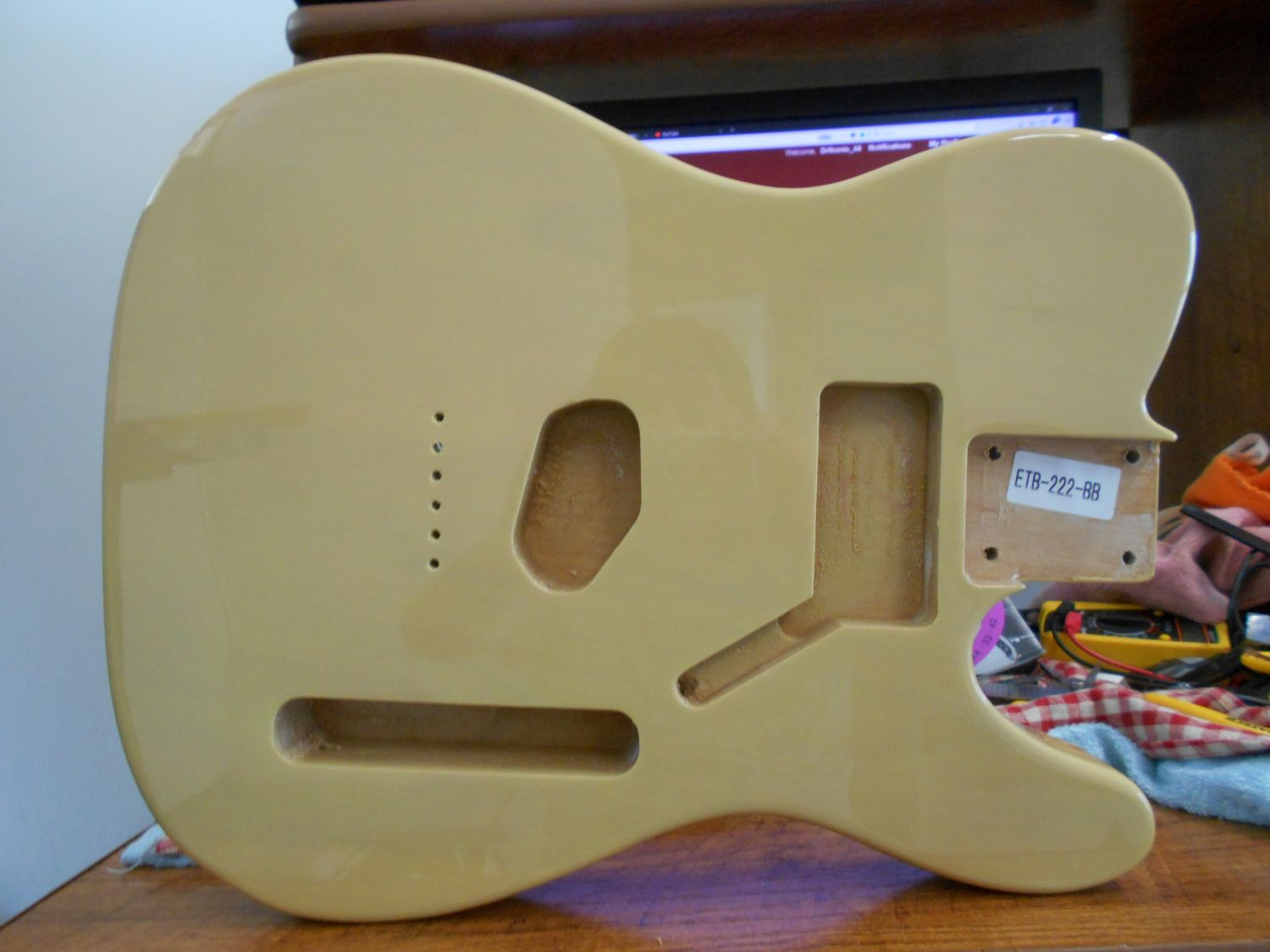

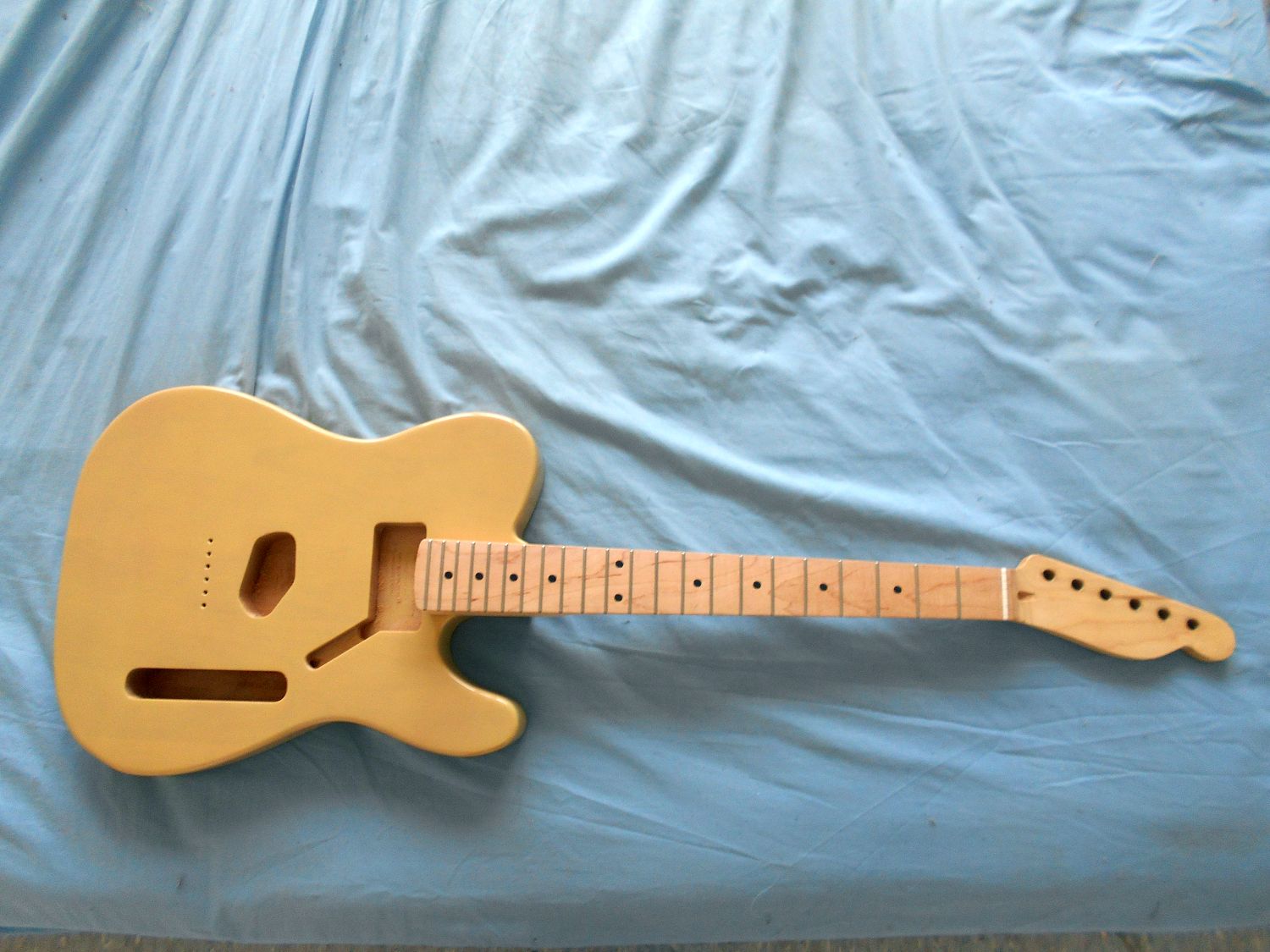

    Just got back from picking up the parcel from the post office and yes indeed the new Telecaster body has arrived, I've just unboxed it and it looks really nice, the finish on it is nice and smooth all over, I'm quite impressed at the general quality of the body itself, all the routing looks like it was done very accurately, the holes for the string ferrules have been drilled through the body in a straight line, the only downside is that the all maple Andoer neck is a bit too wide by about 2mm to fit in the neck pocket, the neck heel is also about 2mm too thick, so I've got two options, get the neck machined down to fit or buy another neck on eBay.
    I can just make-out the grain pattern in the wood used to make the body and looks nice, incidentally the wood is Alder.
    Overall, I'm very happy with the body, the Butterscotch Blonde finish seems to go really well with a maple neck.
    Now for some pics:

Name:	Tele Body 1_resized.jpg
Name:	Tele Body 2_resized.jpg
    And here's a rough mockup of what the body would look like with the Andoer neck attached to it:
Name:	Rough Tele Mockup_resized.jpg

  5. #44
    Nice, shame about the fitment issues.
  6. #45
    For sure, otherwise I'd be one step closer to getting it all together, ready for assembly, fortunately I'm not in too much of a hurry to get the Telecaster built, since I've got two other guitars I can play in the meantime.

    Rightio, according to the description I read on eBay, the Butterscotch Blonde Telecaster body I bought was actually intended as a replacement body for a standard Fender Telecaster, so, knowing that, I'm going to have a good look around online for a Fender Telecaster neck going for a good price, so far I've found a couple of likely candidates on The Stratosphere, therefore that makes this a partscaster build.
    I would like to find an all maple neck, preferably with an amber tint finish, but I'll see what I can find.

    Note that neck's got a vintage radius board, so it's not going to be easy getting a low action on it. Maybe look for a 9.5" radius one?
  11. #50
    Whoever said companies were logical?
    Good point, the Andoer maple neck I was planning on using has a more modern and flatter 16 inch radius fretboard on it, it's a pity that it doesn't fit the neck pocket on the Tele body I bought, cause it would have been ideal for playing slide Blues.
